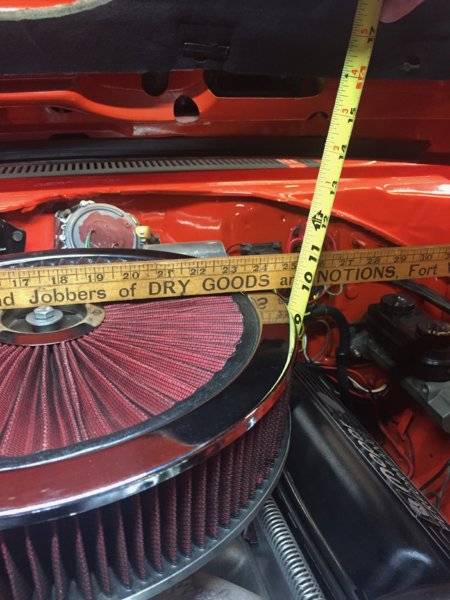

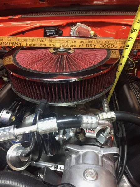

Here are photos comparable to yours (dropped-base air cleaner on). I'd call it 9 3/4" or 9 7/8". It's probably slightly less given the angle of the tape required by the air cleaner.
This matches your photo (page 6) almost EXACTLY. It should. Same block and intake manifold with 4150 carbs (your Demon to my Quick Fuel). The question is, how much higher is it after the Pro Flo swap?
Here is one with the Edelbrock RPM Performer and 850 Demon still on. Will do tomorrow.
