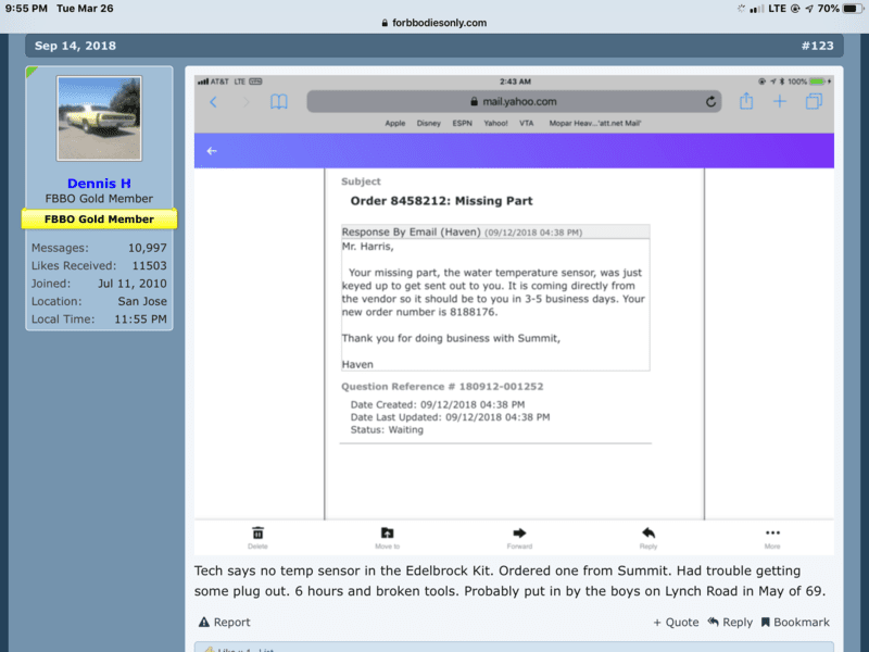

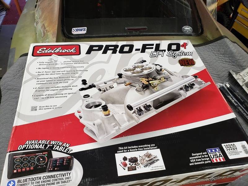

Wondering what temp sending unit you guys recommend; just got my PF4 today and was surprised to see there wasn’t one included?
See post 123 on page 7. They subsequently sent me one. It was supposed to be in the box. Read today that all kits now come with tablets already synched too.

Called Edelbrock this morning, told them the coolant temp sensor was missing and they’re sending one out, no problems, no questions. Also answered a couple tech questions I had so if this is anyindication of the tech service I’m already MILES ahead of the service I got with my Accel DFI system.

I figured out the missing coolant sensor mystery. Look at the box, and think BBM.. Checklist is only looking for a complete Manifold.
