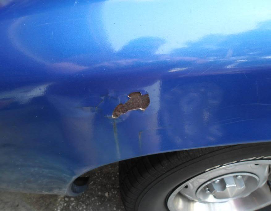

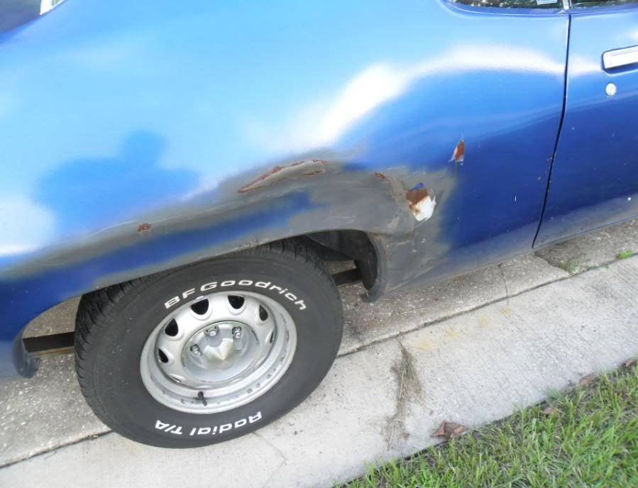

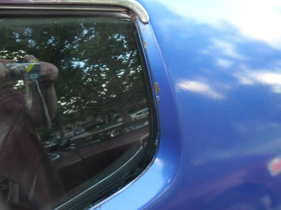

Here are some of the pictures I sent mike that highlight what I considered the damage I wanted fixed:
Based on these pics, he gave me an estimate of $1,100 to fix the bad spots, prime, and do a base/clear paint job. I thought this number was probably going to go up as the lowest price I had received was from the owner of the dealership I bought my Interceptor at. He had quoted me $1,200 for an enamel job and I knew that price would go up. :) I budgeted $2,000 as the amount I could pay, and took the car over to Mike's house so he could look at it.
Mike's deal is he and a neighbor work together to do cars in their spare time, using his neighbor's garage as a shop. Then when it's time to paint, they take the car to Mike's grandfather's shop and paint it there. I had to admit they had the low overhead thing down.
They looked the Roadrunner over, and said since I wanted a total color change, and since there was a fair amount of rust to be cleaned up and they wanted to use POR 15 as a primer instead of standard primer, the cost would now be $1,500. So the price went up $400, but in fairness the initial quote was based on pictures, and Mike spotted things I hadn't noticed. I was also $500 under the budget cap in case any more "oh, by the ways..." came up. I gave him the green light to start on July 28th.

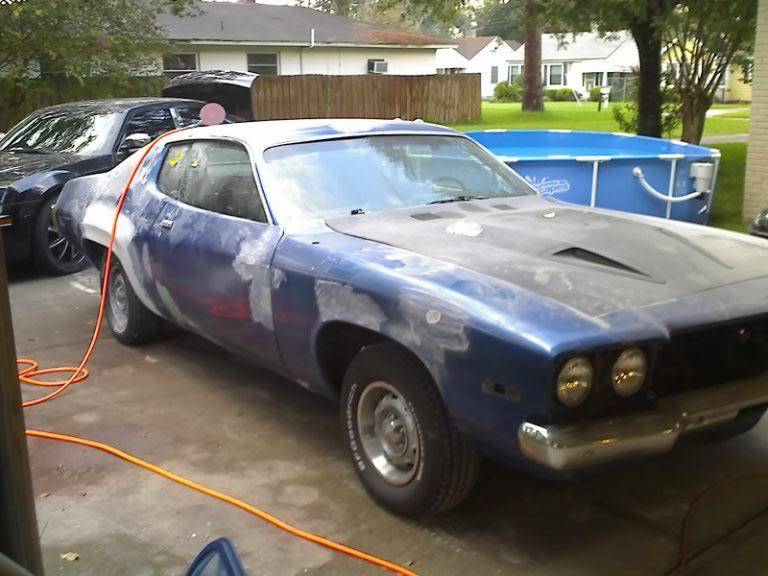

Mike sent me pictures of how things were going. Here are some of the pics he sent during the first week:
As I expected, the further along he got, the more problems surfaced. He found gobs of old Bondo that he had to remove and fix the area it was on correctly, he found some rusted steel under the driver's door and welded in new sheetmetal, and he fixed about 40 little dings and dents. On August 11th, he came back to me and said he was going to have to charge me more for all the bodywork. We settled on a new price of $2,100, which was more than I had budgeted but I was still expecting to get a better deal than I would have at a shop as I knew their prices would have gone up as well.

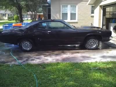

Mike painted the car on August 21st, and sent me the pictures below on the 22nd, which was when he brought the car back to his neighbor's garage for the final sanding, polishing, detailing, and reassembly. I picked the car up a few days later and she looked awesome! They did a superb job and I couldn't have been happier. No, it wouldn't pass for a 100-pt resto job, but for what I needed, they were right on the mark.
As I mentioned in another string, as I was driving home, my son and his girlfriend who had driven me over to Mike's house were laughing at all the guys who were driving up beside me, slowing down, and scoping the car out. I figure that's the best measure of how good your car looks. :)
So, I now have a car that runs, has about a 98% complete interior, and has paint and bodywork done, and I'm at a total of $4,874, or about $116 less than what the original asking price for the car was.

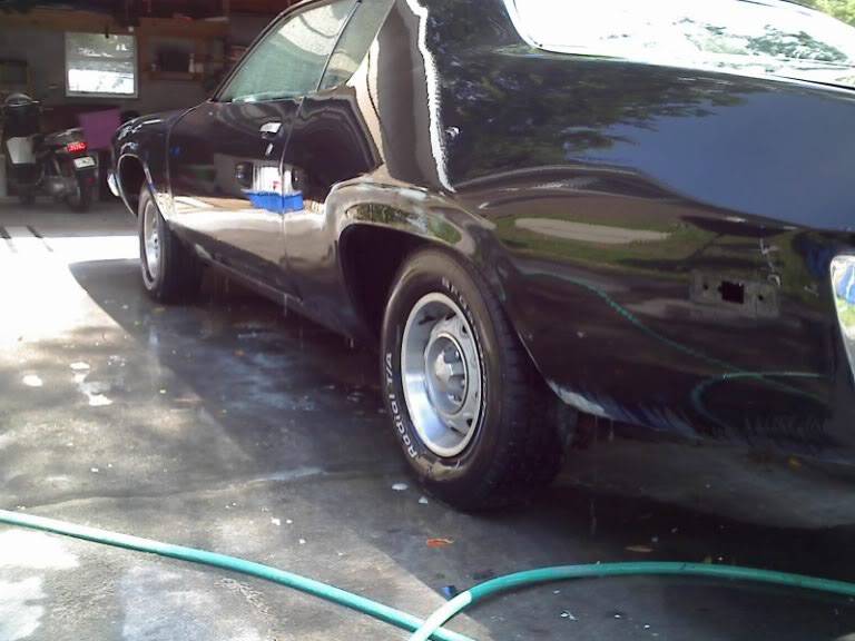

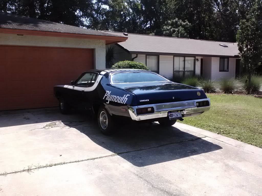

Here are some pics of the car after all the decals were applied. It's pretty well covered in handprints, soap residue, sweat, and body oils, but still looks pretty good to me!

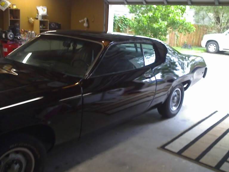

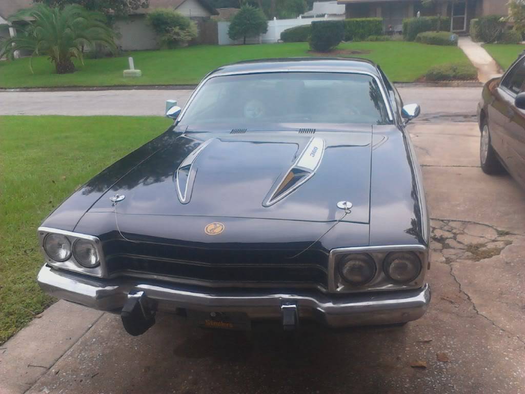

Here's a shot of the nose with the scoop inserts painted Steelers gold, hoodpins and sport mirrors installed, and pewter Steelers tag installed.

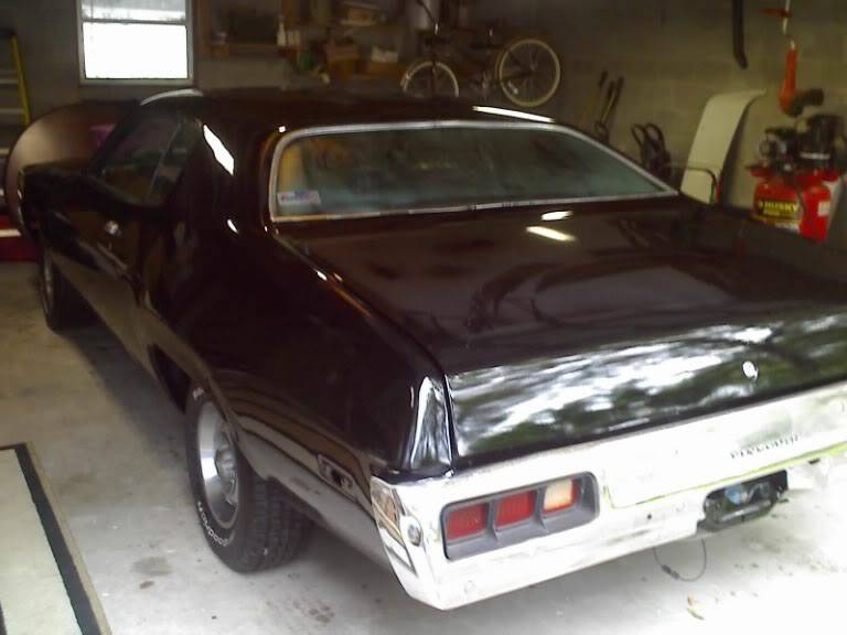

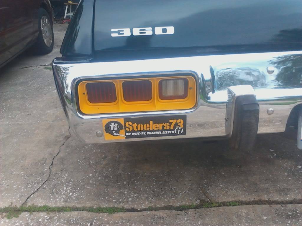

Pic of the rear with the taillight bezels painted Steelers gold and vintage bumper stickers on. This is also the rechromed bumper. :)
Close-up shots of the bumper stickers. The Steelers one is from 1973 and refers to WIIC, which became WPXI in the 1980s. The Pirates one was issued in 1971 by Arco gas stations.

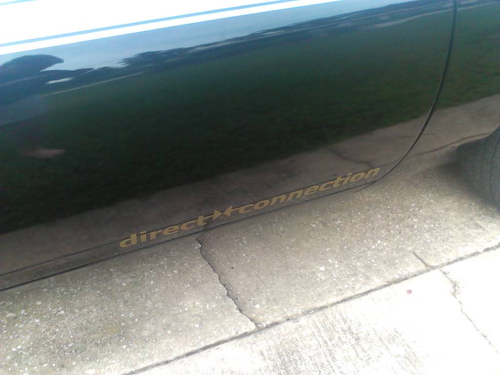

Shot of the Direct Connection lettering along the bottom of the doors.
