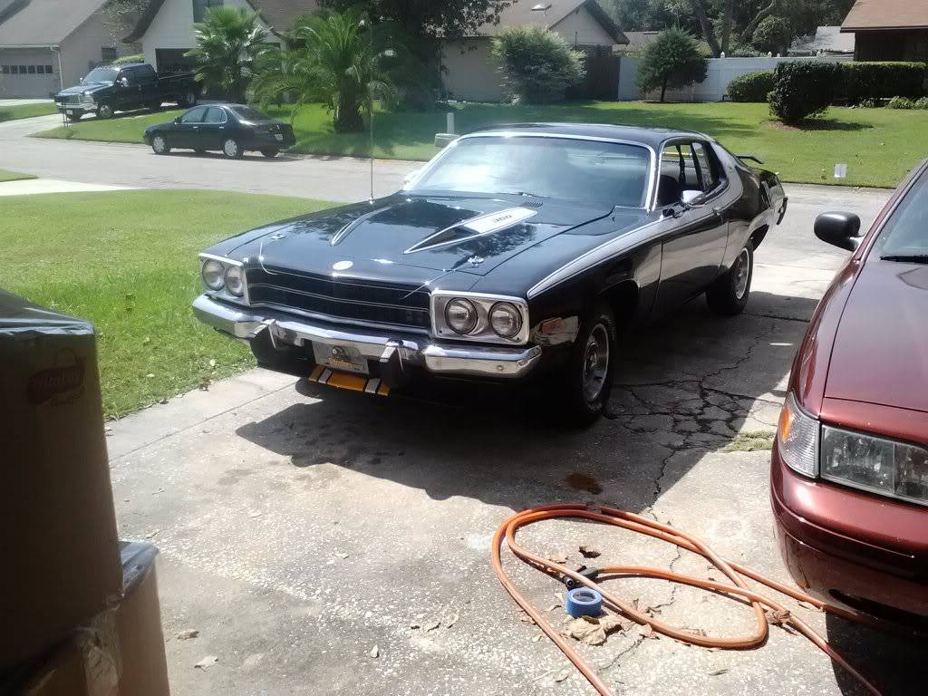

I spent most of the Labor Day weekend working over, under, and in the car trying to get things finished up before football season starts, which was my original goal. Of course, the car had other ideas.
First, I went to install the new speedo cable I bought. I took the old one out, and started routing the new one in. This effort came to a screeching halt when I went to connect the cable to the transmission and found the supposed 100% compatible cable connection was much smaller than the connector on the tranny! The reason I had to replace the cable was I had broken off the retaining clip on the old one while I was swapping the gauge clusters out, so rather than lose time waiting for a new cable to come in, I pulled the speedo end of the new cable off, and used it to replace the broken one on the old cable. A few crimps later the old cable was ready to go.
Next, I needed to install the FM radio antenna I bought several weeks ago, only to discover that since I had bought it, several pieces had gone missing. The worst of these was the nut that holds the antenna in place. I went to Lowes and Ace and neither had a nut that would work. I went to Autozone and found they had the exact same antenna I had bought off ebay for $39 for $9.99 (note to self: always check to see if a part is available locally first!). I bought the antenna and installed it, only to find the cable for it came up about 18" short of reaching the stereo.
I then had to drive to Radio Shack for an extension cable, only to discover that Radio Shack should now be called Cell Phone Shack because they don't carry much of anything for radios anymore! I went back to Autozone and saw they had 12-foot extender for $5.99, but nothing shorter. Since I didn't want 10 feet of excess antenna cable laying around, I went to Pep Boys. They also had the 12-foot extender for $5.99. but they also had a three-foot extender... for $9.99! After getting an incoherent explanation of why a cable that's 12-feet long is $5.99 and one that's 1/4 as long as long is $9.99, I paid the money, went home, and finished getting the radio installed.
My only easy project this weekend was installing the old purple roadrunner horn. The original wiring was gone along with the horn, so I had to rewire the circuit and use an aftermarket switch, but now the car can "beep beep" with the best of them.
So, as I close on the finish line, the budget is now up to $5,445, and I'm dang confident I'm going to come in well below budget. I was going to sell off the spare parts I had laying around (old rear bumper, some body panels, and hood stripes), but one of our forum's new members has a 73 he's working on and he drove down from GA to get them. Since they were going to a good cause, I just gave them away. It helped him out and freed up more space in the garage, so it was a good deal.

Step 10: Adding Spoilers
When I was street racing in the 1980s, there was a guy with a 72 Roadrunner that had a full-width front spoiler on the car, and I always liked that look. Also, I've always thought the 73/74 Roadrunners had a bit of a weak chin, and adding a front spoiler would make it look more aggressive. Taking a look at my car, I could see adding a front spoiler would make the body look unbalanced between front and back, so I would need to add a rear spoiler as well. This meant I would need to get a Go Wing spoiler from somebody.
I heard about a business called Spoilers By Randy (www.spoilersbyrandy.com), and he makes a custom 73/74 front spoiler that costs $160. Here's a pic of the spoiler as installed on a 73/74 car:
I was about to buy it when another forum member pointed out that the spoiler looked a lot like one for a 69 Camaro. I infiltrated some Camaro sites and found out the 69 Camaro spoiler looks about identical to the one Spoilers By Randy sells, and I could get an ABS one for about $30, or a steel one for about $80. I decided to risk $30 on an ABS one and see if it could actually be installed on my car.
The challenge with installing a front spoiler on a 73/74 Roadrunner (or Satellite) is the lower part of the front license plate mounting area. This creates a bulge that prevents a flat spoiler from being mounted unless you install it behind the bulge, which makes the spoiler harder to see. I wanted one that stood out, so I would need to modify it. I measured out the area of the bulge, cut that sized section out of the spoiler, and found I could attach it without a problem.
I painted the spoiler satin black, and decided to paint the sleeve stripes from a Steelers jersey in the center as an accent. I installed the spoiler using sheet metal screws drilled through the top of the spoiler and into the lower valance. Here's some pics of the installed spoiler:
This pic shows the cut out I had to make to the spoiler:
As you can see in the pictures, the modified Camaro spoiler protrudes further out than the Spoilers By Randy spoiler, which was the effect I was looking for. And as an aside, this spoiler actually works! I noticed when I would drive the car to work, I had to keep making slight adjustments to the rear view mirror during the day, and I thought the mirror was loose, but it wasn't. Then I realized I would adjust the mirror while driving in the morning, then have to adjust it when I got back in the car to go to lunch, but at that point it was stopped. The spoiler was pulling the nose down while I was driving, which was why when I was stopped the angle of the mirror wasn't right. So there's more than aesthetic value to adding one of these front spoilers.
If you remember a few posts back, I mentioned I gave away a lot of spare parts to a forum member in Georgia who was working on a 73 Roadrunner. He told me he had a used Go Wing that he wasn't going to use, and he would sell me for $80, so I drove up to his place and got the spoiler from him. I painted it to match the front spoiler and mounted it using the usual procedures.
One other thing I wanted to do was add Steelers graphics to the rear window, but it seems like every Steelers fan in the country has the team logo in the rear window so I wanted something different. I had seen a neon light at a Steelers store that was just the outline of a famous picture of Steelers founder Art Rooney smoking a cigar, and I thought that would look cool on a car, so I drew up the outline and had a local sign shop make some gold vinyl decals of it for me. One large one for the window, and two small ones for the ends of the Go Wing. Here's how they turned out:
So I now have matching front and rear spoilers. I paid $30 for the front, $80 for the rear, and about $55 for the graphic and paint, for a total of $165. Not bad, and I'm at $5,660.
