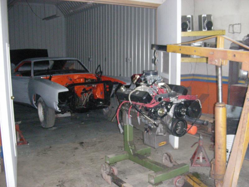

What happened was this, when I painted the jams, trunk opening and engine compartment I had an issue with the white bleeding threw the orange (semi translucent base) in two areas that were in corners that as a result got hit a little more. I forget how much time you have to topcoat it but it's quite a bit so I gave it a little time and then dusted enough orange on it to hide the white and cleared it. I was well within the window but it didn't adhere at all "like I said"I literally blew it all off with an air nozzle. I'm not sure what to do with the underside of the hood, trunk lid and inside of the doors, I sprayed them next and got the clear on pretty quick and have had zero issues with them. I've thought about just making sure I wet sand the clear off the edges to ensure if there is an issue on the underside it will just be there and not effect the rest. Right now the engine compartment is the big question mark, I know it's very questionable but at the same time I hope to put a T56 in sometime soon which I would pull the motor and redo it. For now I'm just going to get it sealed so I don't have to worry about moisture "at least it will look like it's done, just white instead".Man I'm sorry to hear that, so the clear just didn't bond to the surface or? And don't feel too bad, my buddy asked me the other day if there was anything I've done on the car that went off easy "without a hitch" the first time, and I couldn't think of a single one lol. Everything has given me a challenge one way or another, just the name of the game with hotrodding I guess.
Regardless, sounds like a pretty braindead paint salesman..
Yeah, thank goodness for that. That really would have sucked, maiden voyage at 75 mph #&*@ starts flying off everywhere. The paint job on the car would have been fine for the most part because I bought all House of Colors products for the job. I just hated to let allot of good clear I had laying around go to waste so I used it when doing the other areas.Dude that blows (pun intended). On the good side, at least you didn't have the whole car painted.

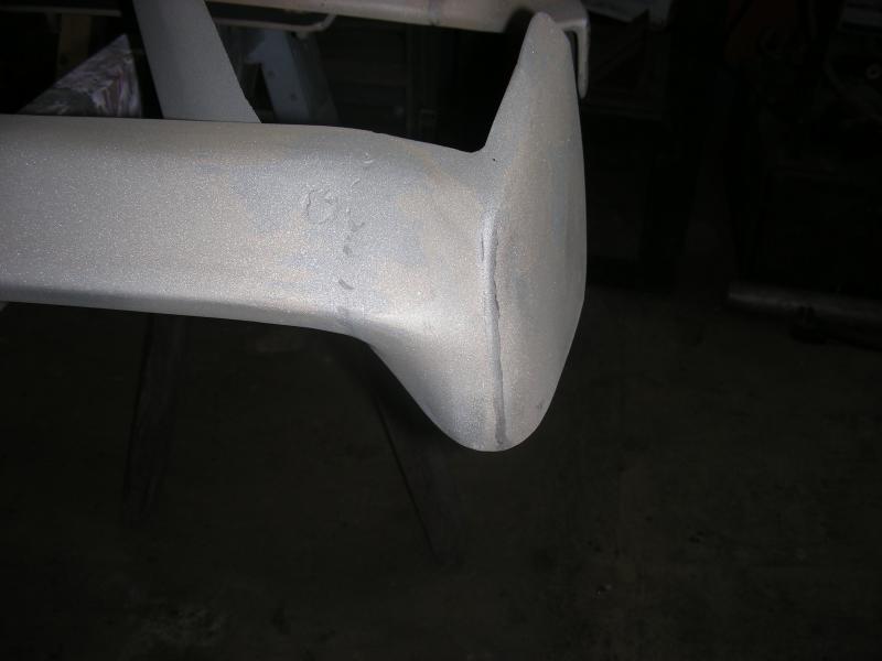

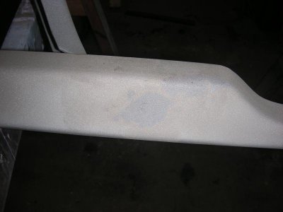

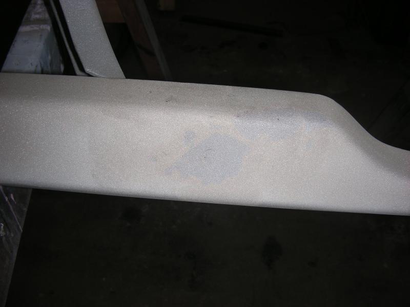

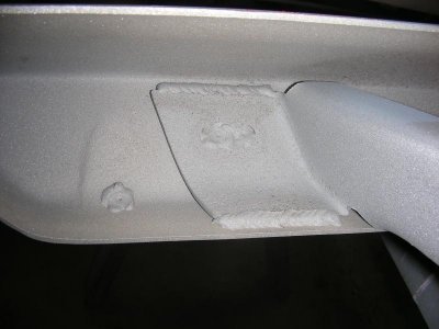

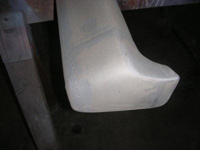

$400 a piece from one shop and $700 for the other, the $700 job was a top notch outfit. As for finding a better set, it isn't that mine were bad it's that I did some pretty extensive cutting and welding on them to get them to fit the body tighter. Both have been narrowed 3/4" on each side, the back has 5/8" added to the bottom, 3/4" to the tops and 1/2" removed from the brackets so as you can imagine they need a little smoothing out (you can make out the mods in the pics).I can imagine what they want for rechroming the bumpers! don't blame you a bit... Maybe later on you'll find a good set of bumpers for a decent price if you decide on going back to chrome..
