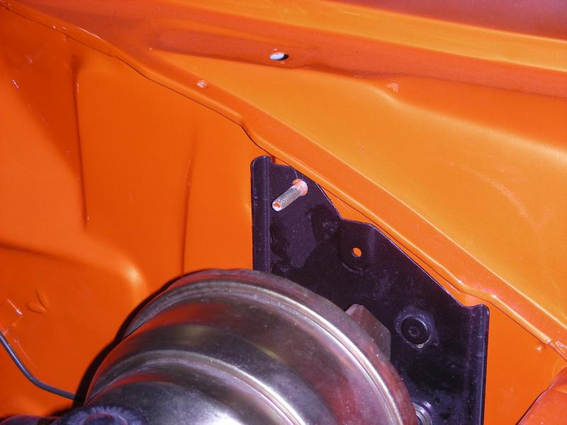

i have them ,they are in place of the adjustable bump stops. i cut rubber hose the correct length to slide over the pins to set the hood height.
mine is a 68,i think the bump stops are in a different place on the 69 ?

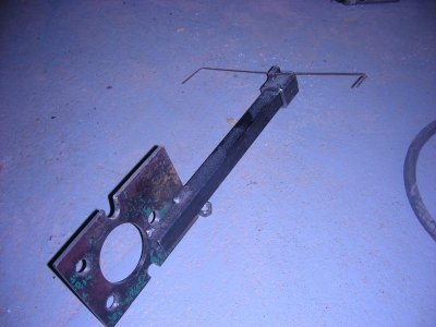

pics to show pin location
Thanks cdr, looks like they are in the same place but the plate is part of the fender on 69's instead of being part of the body. That's not a bad idea putting them there although I would like them a little closer to the front (nothing sturdy up there). Your car looks great in that pic.

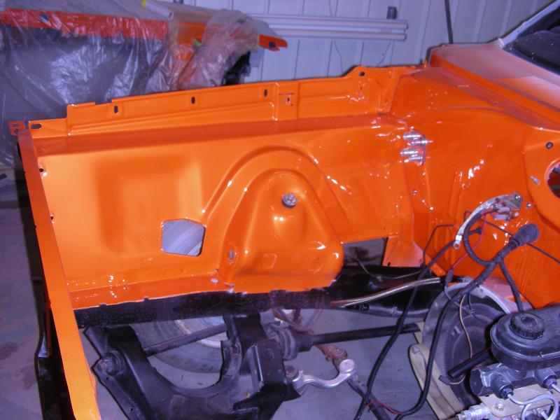

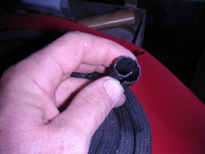

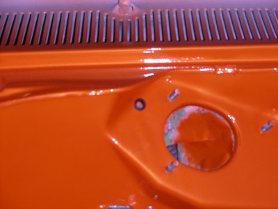

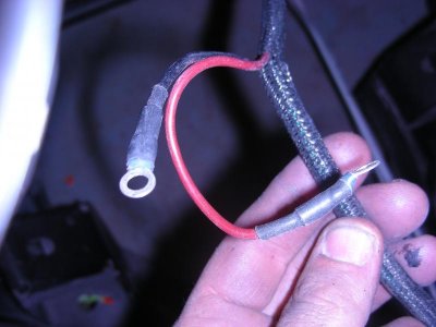

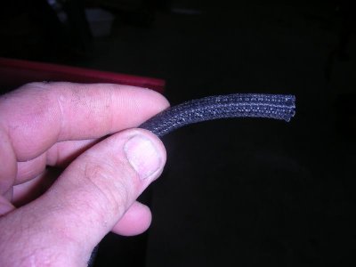

For those of you who asked about smoothing the motor compartment and the hidden wires I took a few pics. My car was factory A/C so there's quiet a bit of welding on the firewall, electrical bulkhead, headlight vacuum hose grommet, A/C which has a hole for the blower motor, and then some. Also the seam around the shock towers was welded solid and then smoothed, other than that just welding screw holes shut. The electrical isn't anything fancy to hide the wires, all front end wires are ran in conduit under the fender as stated previously and the engine compartment wires just come out behind the intake where you can't see them. There's a little hole (grommet) to the left of the main harness for the dist wires (Mallory recommends running them separately and along a grounding plain "block") I also added another hole (grommet) while redoing the paint for the wiper motor so now they will only have a short run. I also included some pics of the braded wire protector I used from McMaster, really nice stuff. My only complaint was that it frayed on the ends but I just started shrink wrapping the ends which makes it look more professional anyways. DSCN8457.jpgDSCN8458.jpgDSCN8459.jpgDSCN8461.jpgDSCN8475.jpgDSCN8476.jpgDSCN8477.jpg
