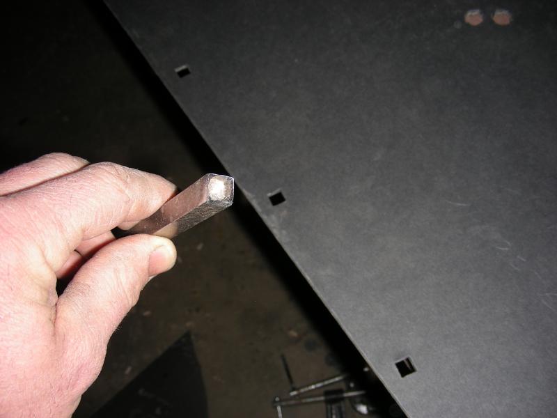

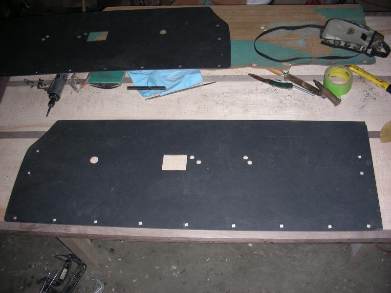

Here's my small amount of progress for the day, both panels cut out and fitted "ready for upholstery". I ended up having to make a square punch for the retainer holes, keystock drilled out and then filed sharp "worked great". Also here is a pic of a 1970 Charger door panel, they offered the center in wood which is kinda what I was thinking but now I'm leaning towards no wood panel.View attachment 156595View attachment 156596
What did you use for stock to make your panels? I just heard about using ABS plastic sheets which would be a big improvement over the original fiber board but the guy making them said nothing about a source.
I used a fiberboard, the upholstery shop gave me the material for making them. It's pretty close to the same thing only it's oil treated to prevent shrinking and drying out. I will be wrapping the edges in aluminum sheeting to prevent breaking and pull threw of the retainers. I would prefer something else but with it having to fit into the chrome channel at the top I have to keep it thin and this board is made just for this.

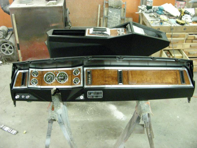

I think the lower one looks more balanced with the horizontal detail. What about walnut? I'm thinking a finer and darker grain would compliment the black leather and your custom dash.
Well,, the dash is already curley maple but is stained with a Mahogany color so I've got to make it match.

The board I'm using is oil treated, supposedly it won't dry, shrink and warp .

Haven't seen you in while RR, I've got the wipers all done and working perfect "thanks for hooking me up with the switch". Good question, if I remember next time I'm at the upholstery shop I'll ask what it's called. He gave the material to me for the panels, it's made just for this use but is a little better than what was originally used "won't shrink and dry out". The uphostery shop is doing all the covering but I've watched them do allot of panels and they just use a contact cement like the factory did. When doing the stitch work they put thin foam with fabic on one side on the backside of the leather, then they sew threw the leather and foam to make the patterns. The fabric on the backside up the foam is what allows the string to pull the leather down in giving you the patters, pleating or whatever. Once they get it stitched up they just glue it on. The board is much like what was used just oil treated, still not 100% sure if I'm going to use it or plywood but so far it looks like pretty good stuff.
