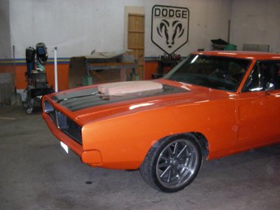

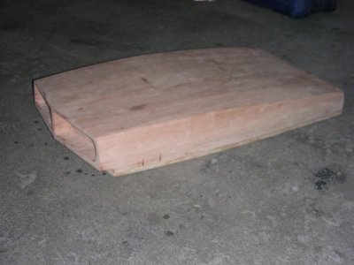

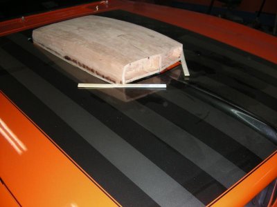

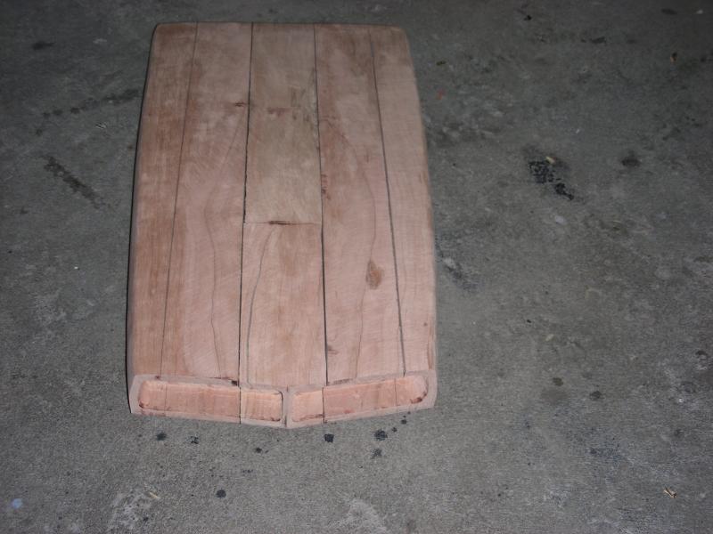

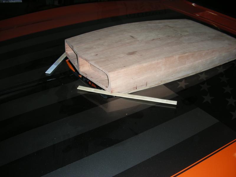

FINALLY, started the hood scoop today. This thing has been like the proverbial unicorn, seemed like there was always something keeping me from getting it started. Here's the start, I liked Speedy's idea with going with a Dodge look so I modeled mine after the Challenger T/A. I'm making it out of Cherry only because I had of rough chunk laying around, it's easy to work with and I was afraid that if I used foam it would break around the scoop inlets. It's made in many pieces so once I cover it in plastic and fiberglass it I will be able to remove one piece at a time making it allot easier. DSCN9617.jpgDSCN9618.jpgDSCN9621.jpgDSCN9623.jpgDSCN9624.jpg

I think I've decided on the paint job for it as well, I'm going to paint it flat black then mask it off and hit it with some of that textured flat black. I think it will look really cool being all flat black but still having the flag continuing onto it or it will look like chit and I'll have to repaint it. Still might do some more shaping on it like lowering the rear if there's room.

Haha, wish you were here for the process because it's quite crude. Make plywood template, saw profile out on band saw, go to town with the hand held power planer, belt sand contours and router the inlets out. It was all just hogging off the wood, no real talent needed but thanks for the vote of confidence.

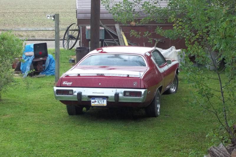

More freakin problems, kids and I were out cruising AGAIN when the Charger really started blubbering and nearly died but it didn't and I got home. Every since it's gotten hot out it's been a pain to start and restarting has been unpredictable but always starts so I'm suspecting the fuel is getting hot. I ordered a 1/2 thick Mr Gasket heat dissapater (I think Prop used this) and some fire proof insulation for the fuel lines so hopefully it helps. Got my Auto Meter GPS unit for the Speedometer today and guess what it says on the back of the antenna MADE IN "WE MAKE NOTHING BUT CRAP" CHINA, Errrrrrrrrrrrrrrrr. But in all honesty it looks really good, is super simple to wire and since my Speedo is the same make it's plug and play with no calibration required. Headlights should be here tomorrow.

Hope you get it fixed Dev! I have been having the same problem with my 73 and the other day i think i found its problem, it has several right now but i went to rev it up by hand under the hood and ill be, the left side of the carb jiggled and i found my bolts are stripped in that 30 + year old Eddy transula, They don't make anything to last do they! lol. Anyway that's where i stand, everything being new on yours i don't think you have the same problem but this made me think of mine and right now its parked in my yard as im to busy with some other things i really need to do.. Good luck, i know you'll get it!

I think that hood scoop would look awesome (and VERY different) if you just spray it clear. It will age out to a dark orangeish brown that will look cool against the orange of your car.. Take a scrap of cherry that has aged and see how it would look. You probably know what I mean about the aging on Cherry. I was actually blown away that you used cherry wood to begin with!
The Cherry is just for the mold/template for Fibreglass Darius.
747 I like your idea of the flat/black textured black. Since it is a restomod I think it would also look amazing with a Carbon Fibre look. Either way as always you are talking down your skills... I'm pretty sure there isn't even a handful of guys here that could create a mold that nice out of cherry
Like Goon said it is just a mold but I agree it would look kinda cool but unfortunetly wood wiil shrink, swell and eventually crack under the heat conditions and is just a nightmare to upkeep when in the elements. I work at a samill so I have tons of lumber laying around, once they get to the center of a log it's cut into low quality blocking (3X6) for pallets so it's really cheap lumber to have laying around.
If you insulate your fuel line from the tank forward that also helps. If you've got headers it really heats up underneath!
