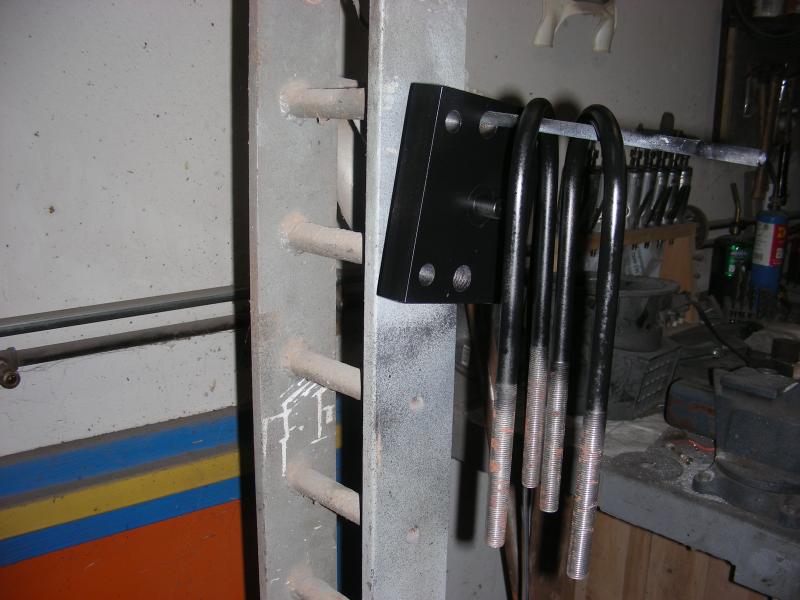

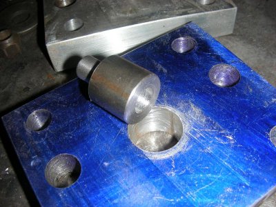

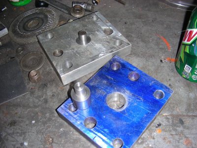

I keep forgetting to post these pics for anybody thinking about making some lowering blocks. These are scrap pieces of aluminum that I had laying around so that's the reason for the extra holes. The only real thing I did different is made a slug that slips into the block, reason being I wanted a quick bolt in block that wouldn't require putting a longer stud in the leaf. The slug just has a hole for the current locator stud to slip into and then a locator stud the exact same size as the original turned down on the other end. This saves allot of time and material being able to just machine a small piece and then slip it in.DSCN9414.jpgDSCN9415.jpgDSCN9413.jpg

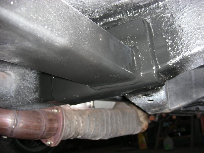

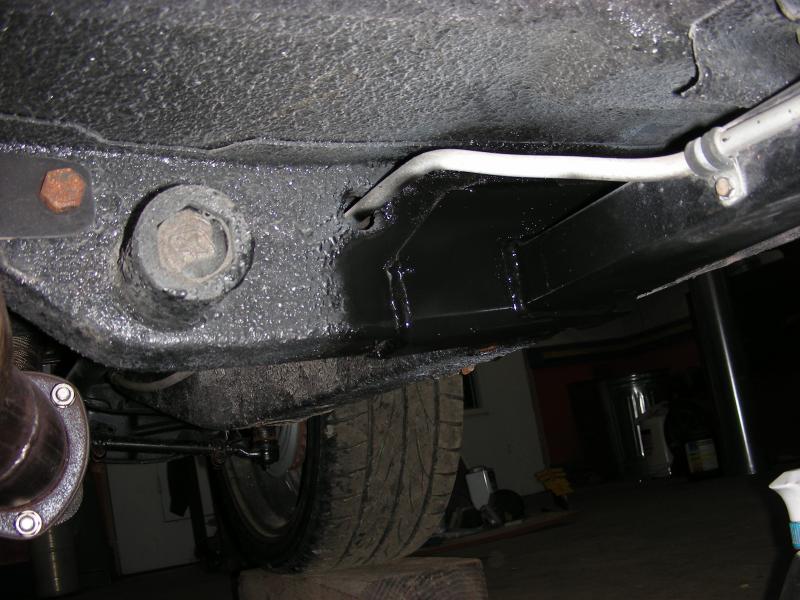

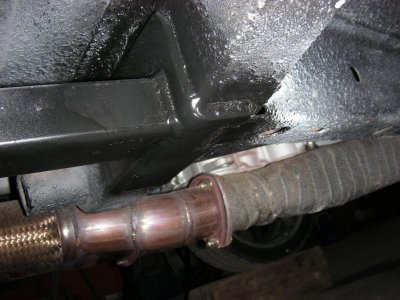

After getting home from vacation last night at 7:00 it took me about 2 hours to find my way into the garage haha, I was itching to dirty up my clean hands from a week at the beach. Since my car is finally close to done and on it's full driving weight I wanted to finally tie the subframe connectors into the crossmember. I had to do a little grinding to get the plates to fit in between and then cut the plates to fit around some obstacles then it was time to burn the in. Seeind how the exhaust is bolted to these welding them up solid took some of the exhaust drone out of the car which was nice.DSCN9616.jpgDSCN9614.jpgDSCN9615.jpg
