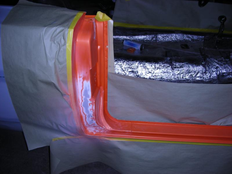

Well not allot has been going on, getting ready for a big job at work and working more hours:angry1:. But on a good note we are finally finishing up our woodshop which means that I'm about to reclaim my garage when all of the woodworking stuff goes out:hello2:, I'll post before and afters of my mess. My plans (that never work out) at the moment are as follows, touch up doors jams and spray the whole car in sealer by the end of this coming weekend and paint it the following weekend. The big "if" is as usual getting the wife to give me the go ahead to buy the paint (1,000). Crossing my fingures.

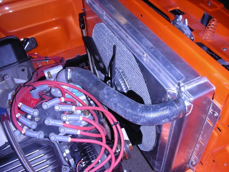

Made a trip to Summit today so I could measure fan clutch's, I bought a Hayden (Flexalites are a 1/2" longer) and a 17" Flexalite fan. I might have to trim the end of the water pump snout off to get it on without scuffing the radiator, once on it will have at least a 1/2 clearance to the radiator "tight". While I was their I had them pull a 18"X11" 427 Cobra wheel (American Racing) off the shelf to look at "sweat". Now to figure if it will fit with the tire bulge, I opened up the outer wheel well and have 14" from fender lip to the inside of the inner tub. The 11" rim measures 12" outside to outside "what do you think" would a 12" wide tire look good on a 12" wide wheel or should I go with a 10" wide rim or better yet can I run a slightly wider tire. I know this thing is going to need all the tire it can get but not sure how much clearance I'll need, is a 1/2" on each side enough? I ordered the paint today as well, boy I'll be in the dog house when she finds out.

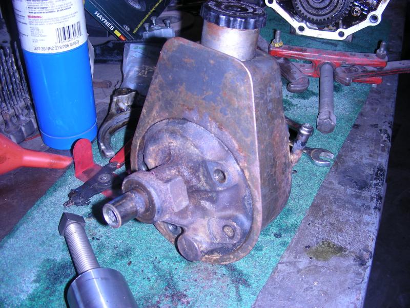

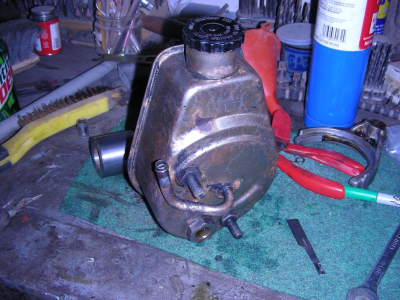

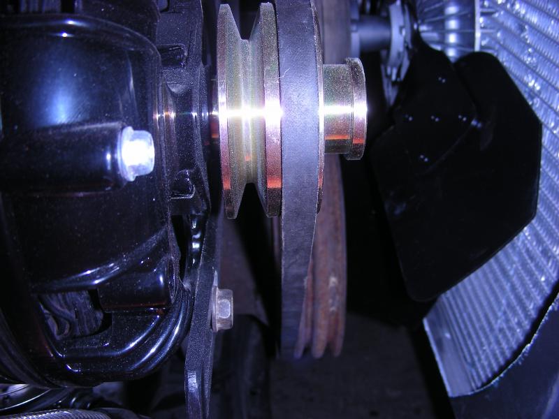

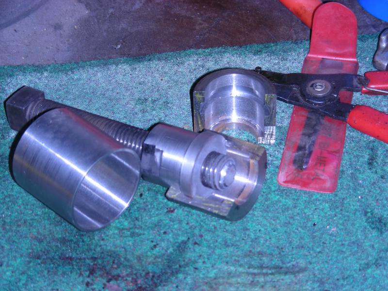

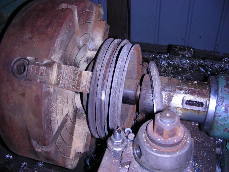

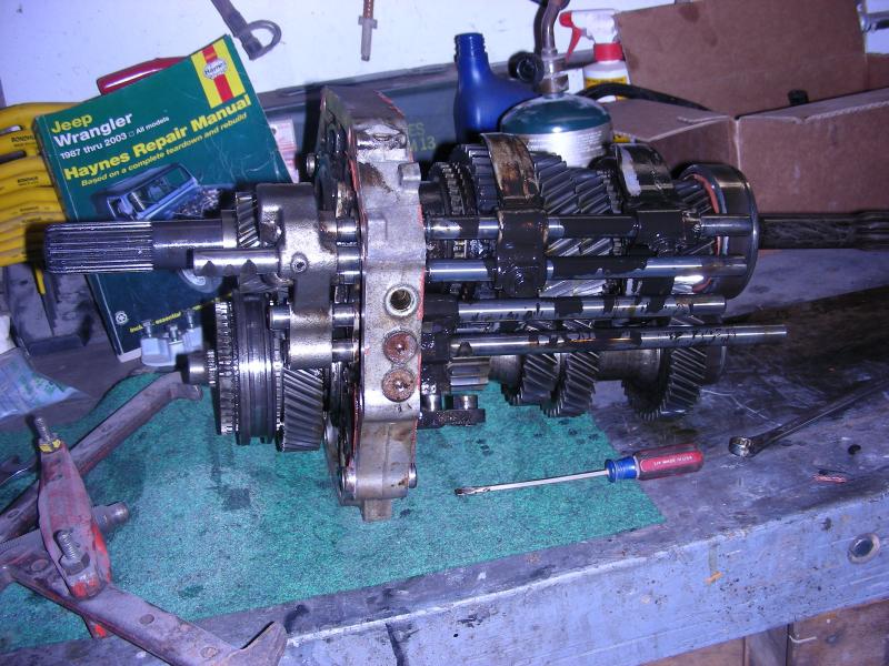

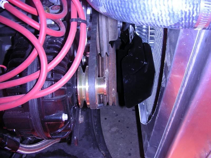

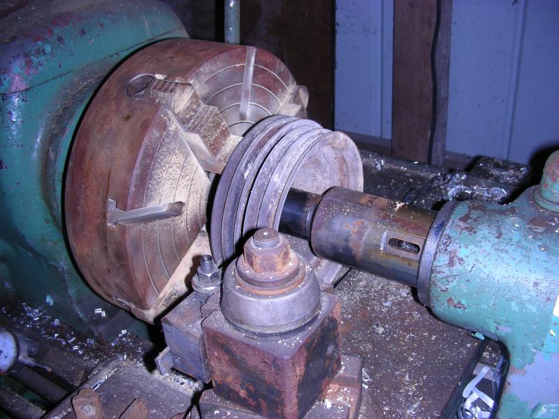

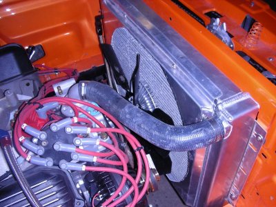

DSCN7803.jpgDSCN7790.jpgDSCN7798.jpgDSCN7789.jpgDSCN7792.jpgDSCN7796.jpgDSCN7797.jpgDSCN7801.jpgDSCN7802.jpgDSCN7793.jpg Hears what I've been up to. The tranny is another side job for funds (jeep 5 speed). I really hate Mopars pulley and bracket setups, there must be a million different combo but I think I've finally figured out what I needed. The pulley in the picture is a 3 3/4 deep 3 groove that is an 1/8 from hitting the fan "ouch". After some shopping on ebay it looks as though they also make a 3 groove that is only 3-3 1/8 deep which looks like it will work. I already made the alt bracket and robbed a power steering pump off an old motorhome with a 440 in it so I think I'm on my way. Pay no attention to the rough cut out for the fan in the shroud "it's just a rough cut" I'll later clean it up and weld a 3" wide strip of aluminum around it. As you can see I blotched my door jams, first time using a two stage base and because the corner of the door jam got more paint it bled threw the orange causing me to give it more time to dry which lead to the clear not sticking properly. It needed a little feathering which resulted in sanding threw the orange so hear I am repainting the jams "great". I used paint stripper on the pump and had to make a pulley puller to get the pulley off for a good cleaning, sure is nice having a lathe. I also had a little extra time to install some more insulation. Now for the bad news, do to medical expense's (my wife) the Charger will likely be put on the financial backburner until next year, and can't even begin to tell you how bad I wanted to drive it and I was so close. :icon_pale: I did happen to finally pull the lifters and get them sent back to Comp, they called today and said "yeap they aren't any good and will send a new set" I have to admit I'm a little leery about installing them. I likely spend my time buildind the custom mufflers and shaker hood now that any hope for money has vanished. By the way, since when do hospitals force all of your bill to be paid in one year "that's a lot of doe" especially when you have weakly 200.00 physical theropy bills on top of that.

looks like enough clearance on the fan to me, progress at-least...

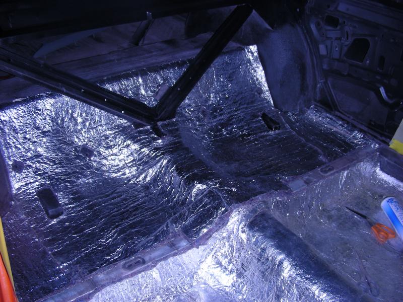

who's brand of sound deadening is that ??
Yeah, it's a hoot alright. I honestly really enjoy building it or other things for that matter it's just the stupid things that you shouldn't have to deal with that get aggravating. The sound deadening is Bonded Logic from Summit, I chose it because of it's price per quantity, to me the prices that some of the more well known brands ask is robbery "it's insulation for crying out loud". Anyways, it worked really well and formed to the floor really well, the only problem I had was the thickness combined with the carpet makes the studs in the gas pedal to short. I do love being only 1 hour and 15 min away from Summit.

Bonded Logic, Summit Racing I will check it out, thanks for the heads up...
I would recommend they're "sticky stuff" adhesive as well, it goes on really heavy and really works unlike some of the adhesives that go on like paint.
Why didn't I think of this sooner, a four groove fit great except for it being to close to the fan and I didn't need the outer one so off it came. Now for a little fine tuning, sandblasting and paint, another problem behind me. DSCN7805.jpgDSCN7806.jpg

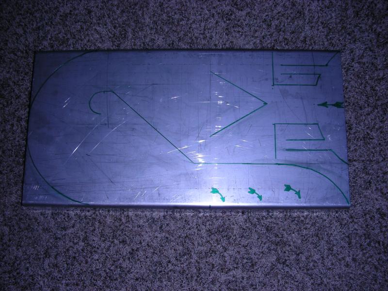

Got some stainless for my mufflers today and thought I'd see whether or not my break would bend it "no problem". While I was in the garage I drew up a plan for my muffler, super 40 flowmaster is the goal. For those who haven't read my post, I love side exit exhaust and with all the things in the way and little space for mufflers ahead of the rear seat I'm building my own mufflers that will turn the exhaust and dump them out 1"X10" tips. The tips will open up a bit (1.5X10) for a little better look at the exit. So what do you think, will they work? The car is ridiculously loud right now so I'm hoping this will be enough if not I'll add some more baffles.DSCN7811.jpg
I think the mufflers should work, IMHFO gonna be loud thou, the exit out the sides, ahead of the tires, always help to make allot of noise too, especially when the windows are down or bouncing off objects/cars next to you {tailpipe exit out the rear helps to drowned out some noise}, the flared flat trumpet style exhaust tips, for lack of a better description, sounds like it will be innovative/cool looking too... it's all music to my ears either way, these cars are supposed to be loud...
