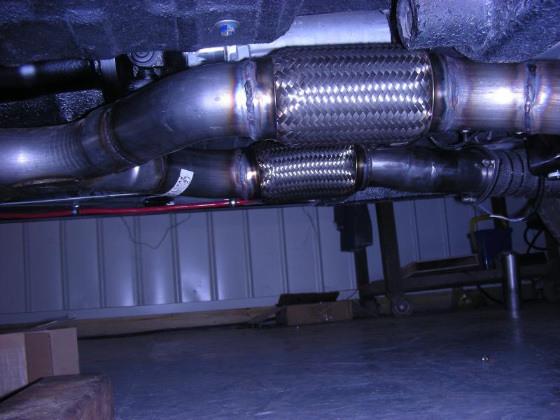

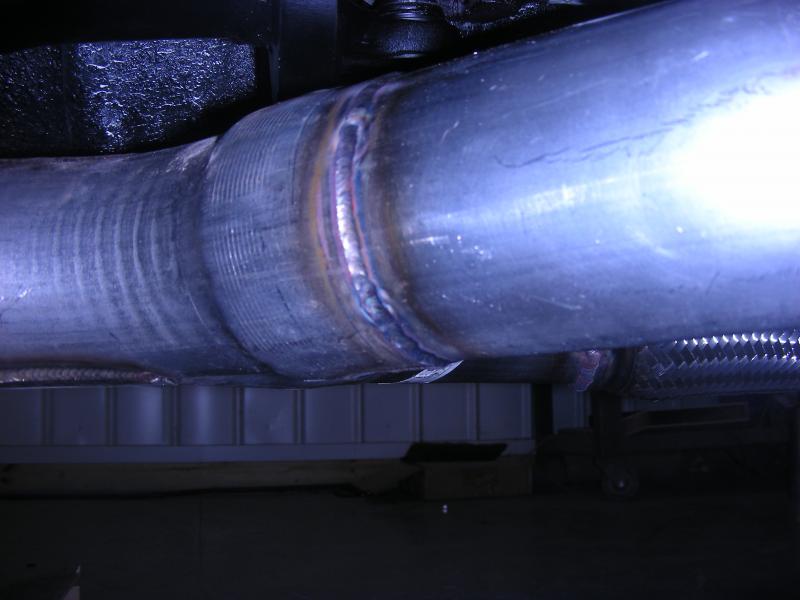

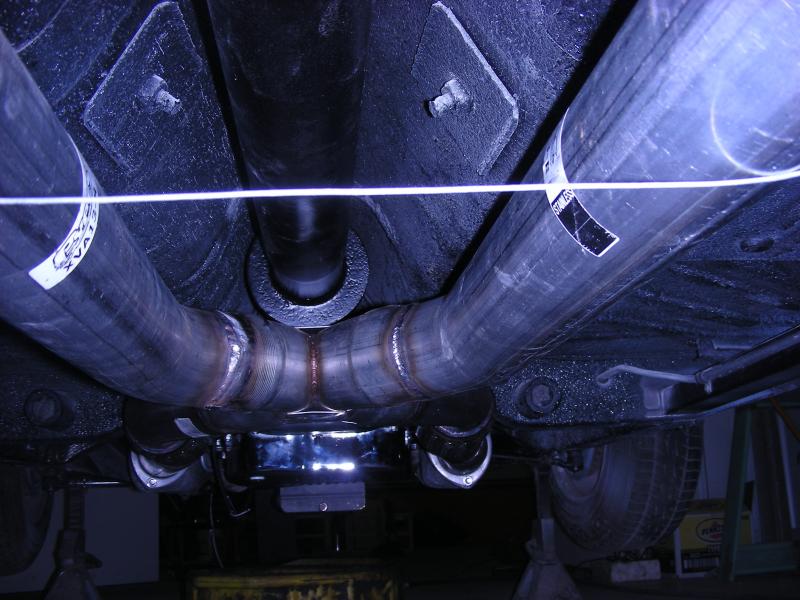

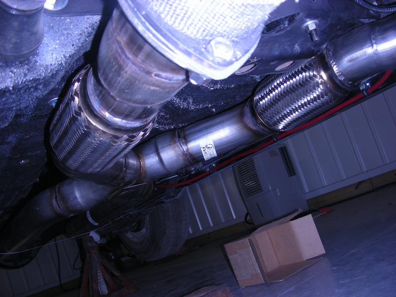

Fun, fun, I got to play with the TIG a little over the weekend welding up my stainless X pipe. I'm pretty new to using the TIG but it sure is fun and aggrevating, not having the extra hand to help steady things and having to feed wire while welding sure adds to the level of difficulty. Anyways hears some pics, I had to do some funky bending out of the headers to get them centered in the cross member humps and tucked up in there nice and tight. The exhaust will be side exit with tight clearances that's why I used the flex couplers so I can mount the tips fairly solid and still allow for movement. Maybe next weak I can start on the mufflers. DSCN7729.jpgDSCN7730.jpgDSCN7731.jpgDSCN7732.jpgDSCN7733.jpg
Looks like some excellent work in this, Hope you have a video plan for us to hear this beast! I know, i cant help myself when it comes to seeing these cars put back to there beauty, they always sound better! :) Great work with that TIG..

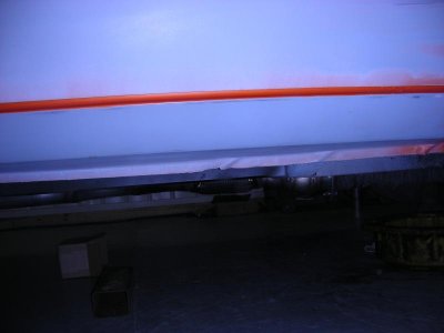

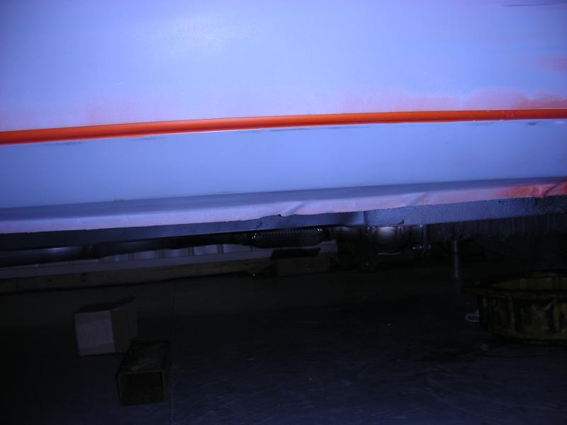

Awesome progress 747, the bodywork and panel alignment looks spot-on!! And I like the wheels you're now leaning towards, think they'd fit the style of the project well. +1 to the crowd waiting for a video to hear that exhaust too :icon_thumleft:
just checked out all your recent updates 747 looking great and however little time you've been doing it or how difficult it is you seem to have the hang of that welder. also concur with others panel gaps look good to me
