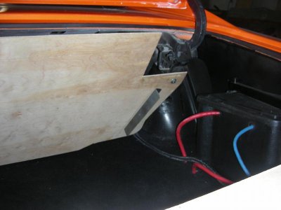

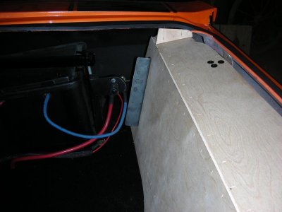

With little to work on I decided to finish my trunk, these are the plywood panel yet to be covered in leather (fake). I'll post pics of how it all goes in once I get the mounts done, the forward panel bolts to the back of the trunk hinge brace, the rear panel screws to the original mounting hole and to the rear bumper braces and then the side panels will Velcro to the front and rear panel. I'm happy with the setup since it doesn't put holes all over the car and I've even made a cool little box that will have a door in the driver side panel for storage as well (the pass side is where my battery is). The spot under the gas filler tube will likely get a Velcro flap that will close after it's installed. Another reason for me doing this is so I can haul things without worrying about dinging my quarters.

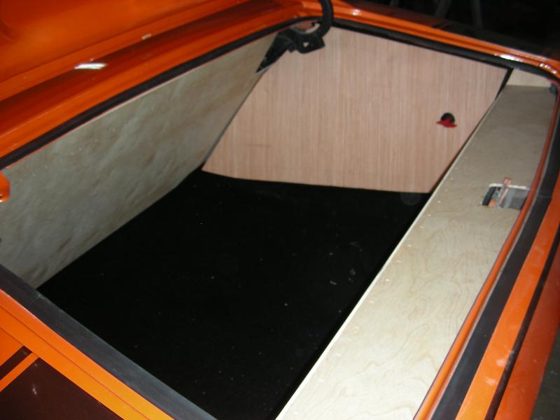

Finished up the trunk panel mounts and will get all the pics before I drop them off at the upholstery shop tomorrow. The big news is I've purchased (sending the last of the cash first thing in the morning) a complete TKO600 kit off of a member for the Charger, boy am I excited to get an overdrive in this thing. I was planning a Viper tranny because you could buy them pretty cheap but when this one came up I jumped on it because it's perfect for my car with the .64 overdrive and best of all the Charger won't be going back under the knife. A big thanks to Drew Williams for being such a great guy to deal with, Thanks Bud!

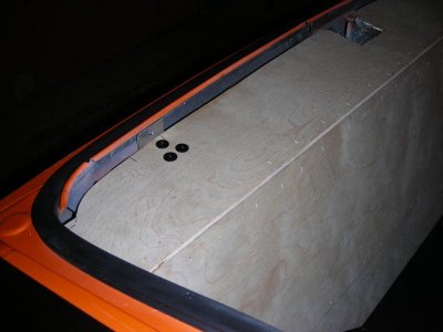

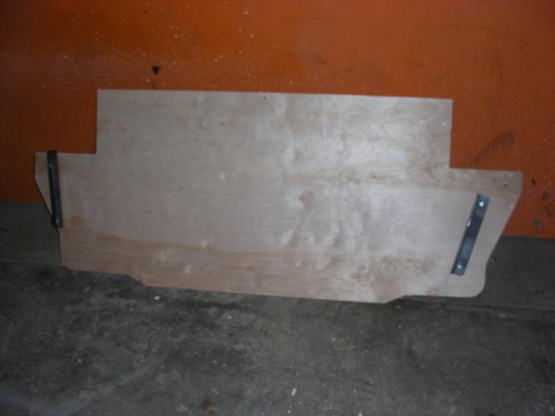

Here's the panel that goes in the front. The panels are all made out of cheap 1/4" plywood.

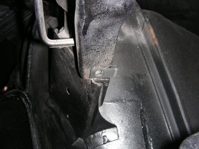

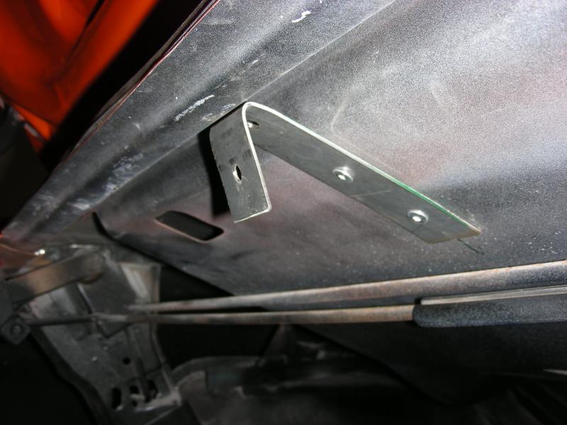

It's bolted to the trunk hinge braces and follows the same angle which places it perfectly to where the trunk starts over the rear and just shy of the trunk opening. I riveted a small clip to the bottom of the trunk out of sight to secure the center since it's a long panel and reinforced it with 3/4"X3/4" strips of popular.

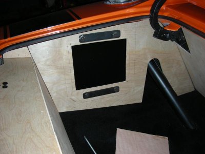

The front and rear panels have these brackets bolted to them made out of 16 gauge steel for Velcro, the side panels will have Velcro on them as well so once you bolt the front and rear in you just stick the sides to them.

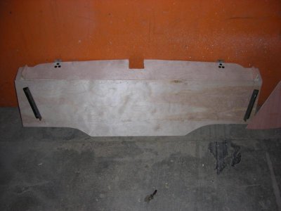

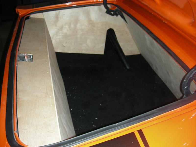

Here's the rear panel, it bolts to the tail light panel where the factory one did.
Like the front it has the bracket for the Velcro and I had to fill a void at the top so it blended with the sides. The brackets used to bolt it to the tail light panel are just riveted on with large headed rivets.

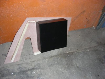

I forgot to take a pic of the passenger side but here's the driver side, the upholstery shop is making a Velcro flap that will close off under the filler tube and like I mention this will just be held n with Velcro. I decided to go ahead and weld up a little box and rubberize it for cleaners, etc that will have .......you guessed it....a Velcro door.
