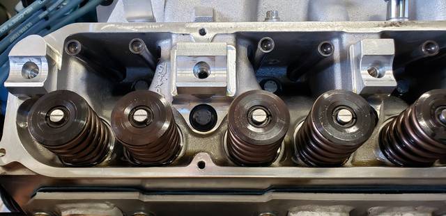

Roller rocker centered on the valve stem
I do not know of any Mopar rockers that are "right" on both sides
even with b3 kit most are off on the pushrod side
ask b3 which ones are "best" and report back
What really irritates me is that I paid $1000 for these rocker arms that are supposedly built to fit Edelbrock and Trick Flow heads, and they are not right, and require hundreds more $$ to make them right. There are much less expensive rocker arms to purchase if you are willing to accept them being not right.

Regardless of the type/make roller rocker you are using, the rocker shaft position needs to be moved anyway with keeping in mind the variables as valve stem height and camshaft specs.

I even wondered why brands like Edelbrock and Trick flow never adressed this and instead of copying the stock head style rocker stand position and angle they made it in such a way that a certain rocker size will be spot on.
Then again, you are still stuck with variables that can throw it off again and you still have to adjust things.
That's the downside of the rocker arm type setup, the benefit is having a more stable and solid valve train though.
Final pattern on the valve stem after the engine has been ran. B3 got it right.
