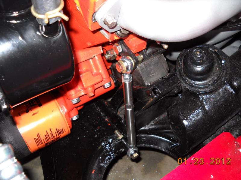

I run solid engine mounts with a .590MP solid lifter cam and the car really doesn't shake that much, and is pretty smooth with the four speed. Had them on the car the past year without a single issue, other than raising my block another 2" above factory. Just make sure you purchase the appropriate strength bolts for your application and you should be fine. Rubber mounts for the trans are a must when running solid engine mounts. Must have some 'give' in the drive train or you are just asking for something to snap'..
