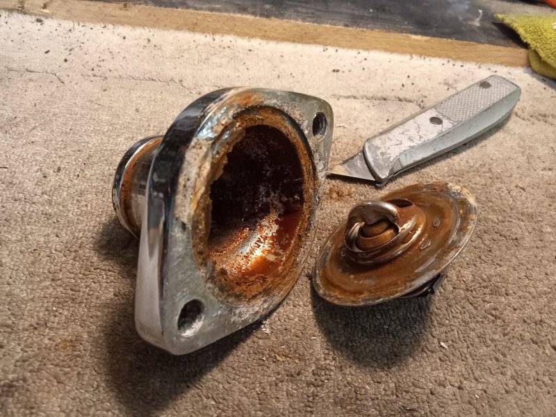

Yep, I did put some in my radiator, after making the mistake of using 100% water in it for it's first 2 years. It started leaking from rusting out the chrome water pump nozzle holding the thermostat. I fixed it by filing it down to a good sealing surface again. Then filled it with just coolant and a tad of molasses. I have not taken the cap off since getting the level right a year ago. My moto is "if it ain't leaking don't fool with it"....

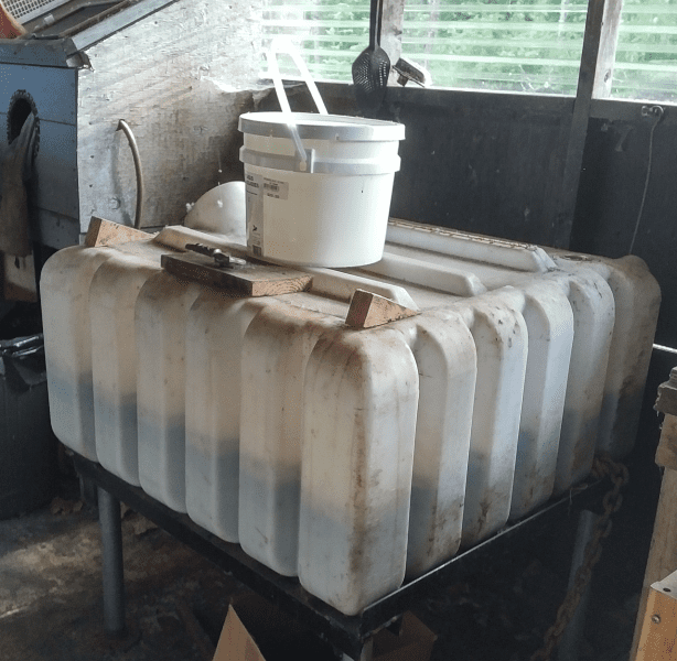

Drained and replaced the molasses mixture in my tank.
At least the price hasn't gone up in the past couple of years.
It was over a year on the last mixture, with quite a few items being de-rusted.
That tank was meant to hold bulk motor oil in a shop. I got a couple of free tanks, so I sawed an opening into the top and put a hinge on it.
