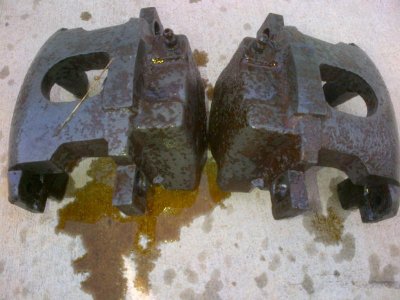

Here is another set i'm working on. These were a little bit rougher than the last set and so far i've been unable to get the bleeder screws out.

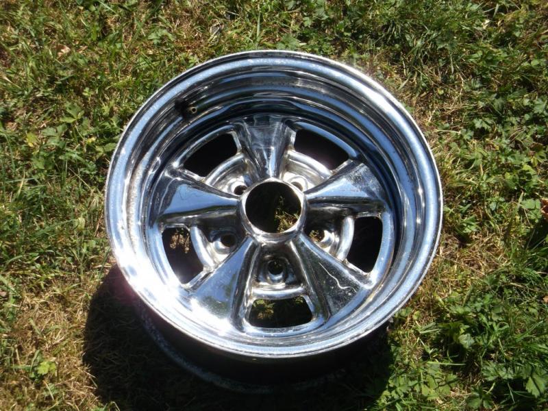

The rest of my wheel cleaned up as expected. Still heavy pitting at the 9:00 section of the rim but most of the rust is out of it. I knew it wasn't going to look new, this was just playing around with a wheel that won't be used for anything.

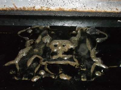

I came across my original 383 intake manifold, so I dropped it in a week ago. I just took a look, and you can tell where it's sitting under the surface from the foam outline.

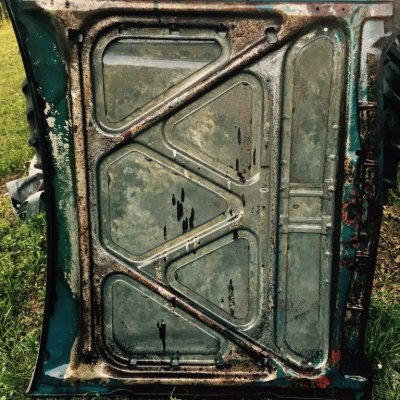

Needed to clean this hood up. It was nasty. Set it up and filled it with a mix and pressure washed it off a little bit ago.
