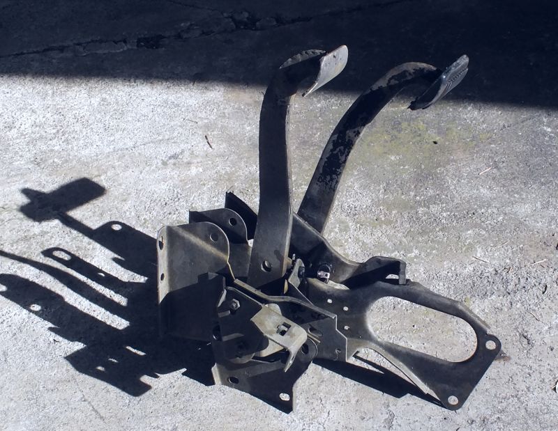

pedals.jpgA typically rusty pedal assembly turned out pretty clean. Too many nooks and crannies to reach with a wire brush or emery. Nine months later and the stuff is still working.
They will still have to come apart if you want to paint every nook and cranny. So to me, I wouldda just took um apart and blasted um and painted um separately.......but I must admit, the molasses works purdy good.

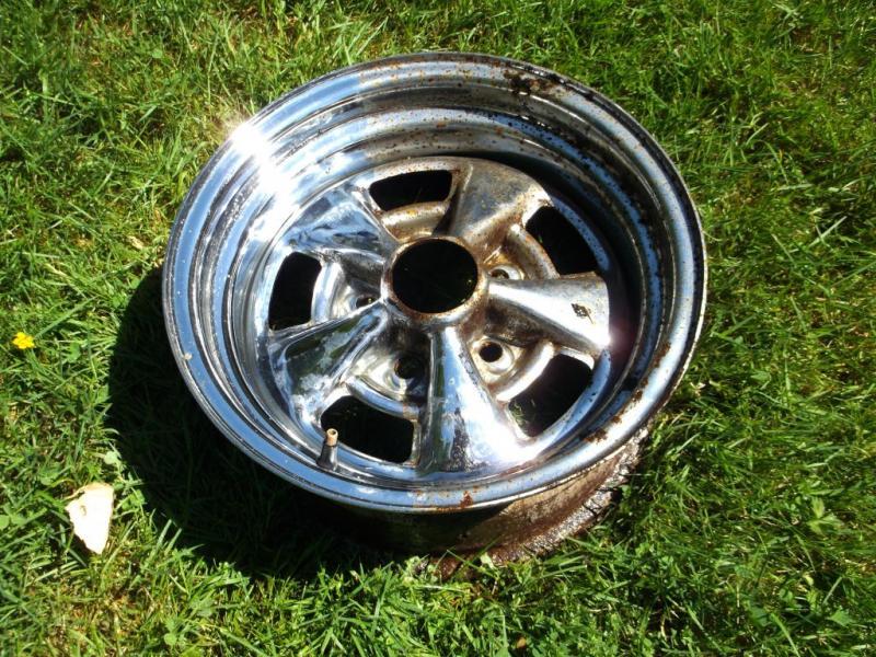

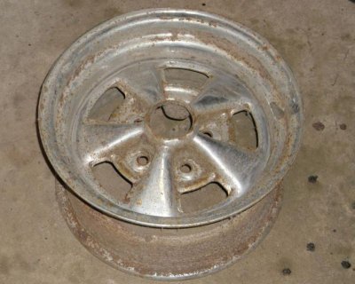

Just as an update, my molasses tank was not in use for a couple of days, so I decided to see what would happen with a rusty wheel. After three days, so far so good.
Of course the tank wasn't enough for the whole wheel so I have to do it in sections. Here's the first three days' result. I just hosed it off.
While I'm sure it will look better with some fine steel wool and wax, I was encouraged by the results. It's back in the tank for the next section now.

As for after, I'll probably go over them with a fine steel wool or SOS pad and see what's really there. A lot of the brown stains on the chrome are leaching out from very tiny pits but the chrome is still there. Where it is actually missing, I'll let you know after the whole wheel is done. Clear coat may be the way to go but in reality I doubt that these will ever look new again. These 14 inch wheels are really quite useless to me, this is only an experiment.

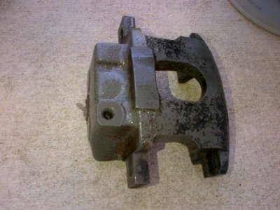

I;m cooking a set of brake calipers right now.
