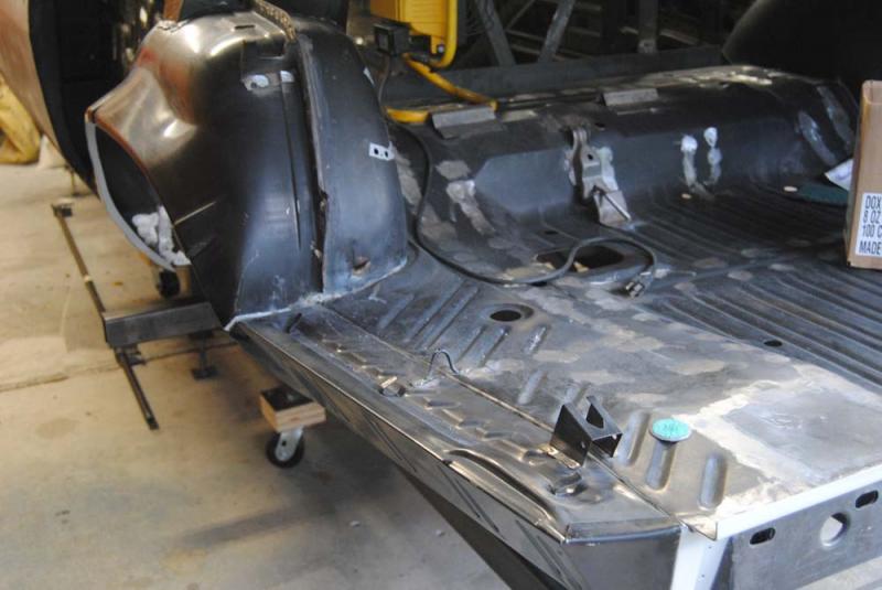

Got all my steel to finish the back end of the car, but does anyone have some pictures of where the trunk drop offs meet up with the rear crossmember?
Thanks!
If you are wondering if the drop offs stop short of the rear cross member, they do. Pic from my car below for reference. Let me know if you need anything else.

Thanks! I studied that pic for a while on your post. It's hard to tell but, does the drop off tuck behind(towards the front of the car) the crossmember or in front(towards the tail).
I don’t have a better pic. From front of the car to the rear it goes cross member, trunk drop off, and then quarter corner. There is a step in the rear portion of the quarter corner. The end of the drop off goes into and gets welded to the outer part of the step and the inner part of the step gets welded to the cross member. Hope that helps!
when i did my drop offs(trunk extensions is the proper name)i put all the welds along the seam and let the front and rear hang til the quarter was in place.that way there you can play with the height when you get to weld the extension to the lower quarter.i hope this helps ya

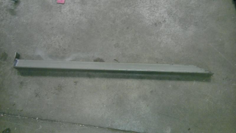

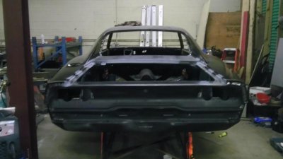

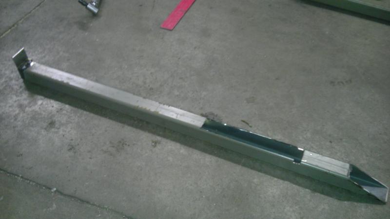

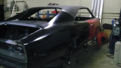

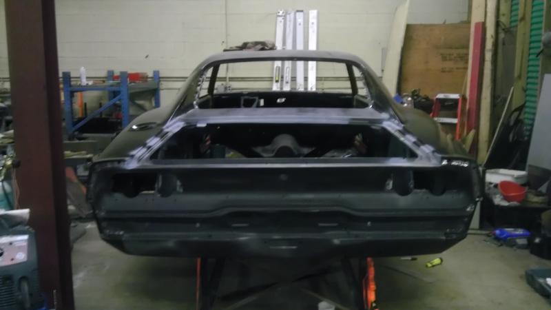

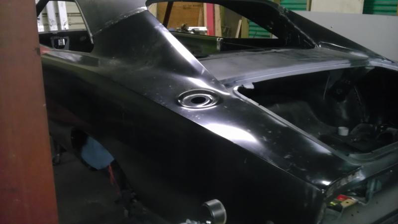

Well it's finally a car again, quarters and filler panel are all welded in. Amazing how solid the car becomes when all the pieces are there. Gotta long way to go but have also come a long way. I am also working on some frame connectors. Using 2" square tubing and some injenuity. Was going to originally us the US car tool connectors, but I'm trying to save some cash.
