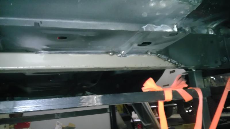

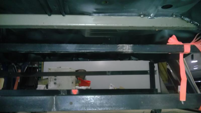

Got one of my frame connectors tacked in place, working on the other one. Once I get it tacked in place I'll burn them both in. So far the only thing I can see a problem with is the parking brake cable but, I think I can come up with something.

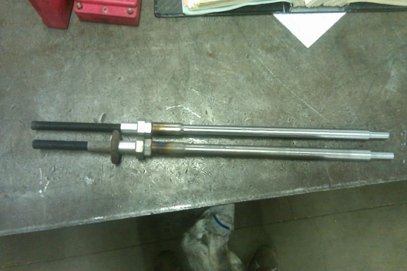

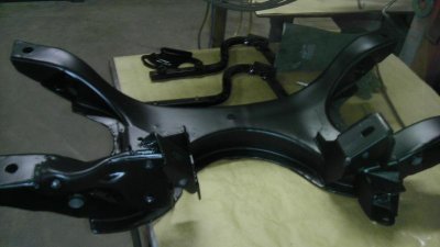

IMAG0002.jpgHaven't had a whole lot of time with the holidays but I'm trying to get the suspension parts cleaned and powder coated to get it rolling again. Probably going to get her back on the rotisserie to paint the bottom. One of my strut rods looked like a ski so I tried a little fabrication. I made my version of adjustables. You do have to loosen the bushing nuts to adjust them but not the tapered end that goes into the lower control arm. They are 7/8" thick so I don't think they are going to bend. I'll have a little more than 1/2"of adj. either way. Let me know what you think...

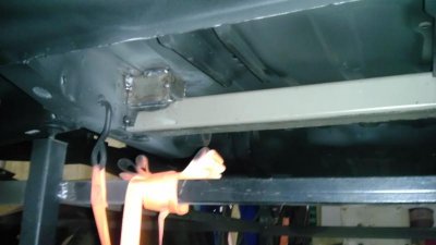

Great car, awesome job on the resto. When I filled the roof to quarter joint on my charger I elected to weld the joint solid to seal out any moisture from the inside then used fiberstrand (it's a little more durable). On the frame connectors, when I made mine I hooked up the parking brake cable (under the connectors) then traced the cable onto the connector, drilled a hole in each side at the same angle as marked then slid a peace of tubing threw the holes and welded it in. Keep up the good work

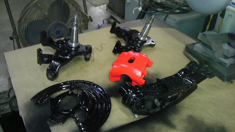

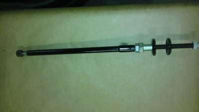

Thanks Prop, glad you liked the idea. Thanks 747Mopar, for the info and kind words. I have a shot of the finished product all powder coated. Also included a few other pics, got the k member all welded up and painted up with Eastwoods chassis coat 2000. Seems like good stuff, haven't handled it to much since I painted it, went on easy with great finish. Last pics are of one of my control arms and my brake setup. Getting alot of little stuff done.
The parts look great. Can't wait to see what they look like when you get them bolted on.
That looks like the work I was planning on doing this winter until I got so busy at work... Nice job!

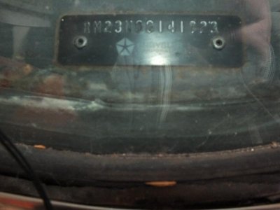

Just bead blasted my dash, looks nice and solid had some light pitting on top from no coasters under the beer cans of the past. Filled them in with a skim coat should be in paint tomarrow. Anyone have vin tag restoration tips, or know where I can get a stencil for the chrysler logo and name?

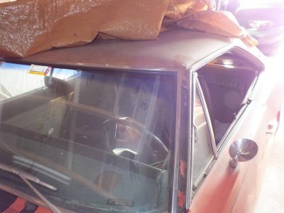

Just finished reading this entire thread and i'm amazed at your abilities. but this post/pic of your dash raised a question i've been worried about. Is it possible to patch rust / fill holes that were drilled in a dash? I know dashes are really thin. i have a 70 RR with the extra speaker holes (round) for an AM 8-track stereo but there is some rust and someone drilled a holes in the dash for mounting a tach and other guages i presume. Good thing is they drilled through the dash pad (a perfect dash pad) but the bad thing is it comes out through the metal under the dash from the other side that is visible from beneath the dash pad or up from the gauge cluster. unfortunately i don't have a pic of the underside. there are i think 4-5 holes IIR but car is 2 hrs away at the moment in storage.
here's a pic of damage / rust near the VIN tag. Sorry for poor quality of pics. I'll clean the glass at least the next time i'm over there but was taking vin pic and not focused on damage at the time.
1970 Road Runner - dash repairs needed shows speaker hole.jpg1970 Road Runner - dash repairs needed.jpg
tallhair, I did extensive work "welding" to my dash with very little trouble.
View attachment 99183Hears a pic of my parking brake cable, sorry haven't touched up the paint yet.
