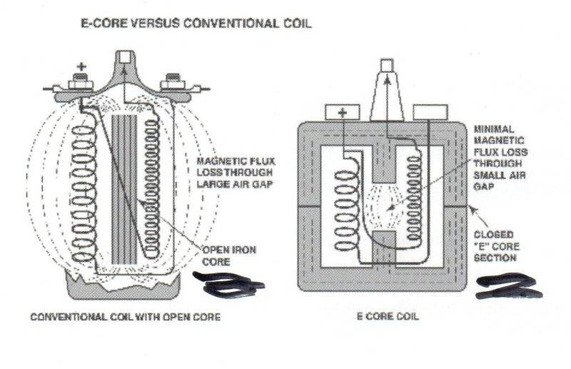

GM HEI is best bang for the buck when used with an E core coil. GM HEI has adaptive dwell, Mopar ign does not have it. Dwell becomes important when more cyls [ 8 ] have to be fired at higher rpms. That is why dual point dists were invented...but HEI fixed that overnight.
A lot of spark energy is lost with a canister coil, see below.
