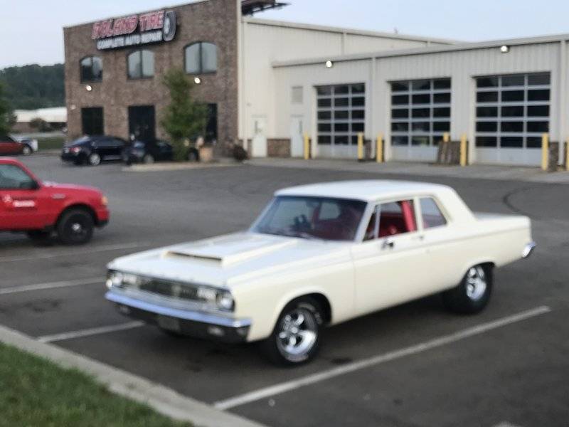

I got the ‘65 out yesterday and went for a spin around the neighborhood. Running great. I was underneath it yesterday and changed my transmission lube in the 4 speed. Next up is the differential lube (any suggestions?). I also upgraded my distributor to one with vacuum advance and that was a nice change. My old one was an MSD ‘Pro billet’ but mechanical advance only.

Ok the big Coronet got both the 4 speed lube and the Dana lube changed so thats done. On to front wheel bearings !

I got all the fluids changed. Next up is a front end alignment. Hope you heal up and get that Satellite out for a spin

Front end alignment complete!
It no longer wanders like a shopping cart with a mind of its own
