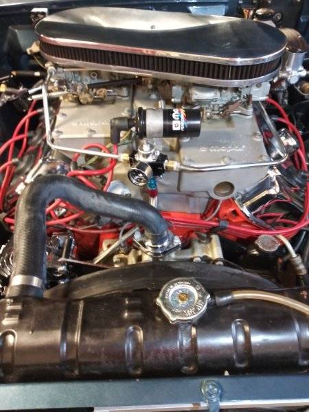

I also run a fuel pressure regulator - I only have a mechanical fuel pump but agree with autoxcuda that these single feed Holleys are pressure sensitive. Im currently at ~ 5psi according to my Aeromotive gauge.

dam that low. I am at 6.5-7. I just run a mechanical pump and a regulator. Have to make a note of that. Any idea how many ponies ya got as a comparison with fuel pressure etc.? Mine was 730 at the dyno with 472 cid. However, on the hub dyno it was 585 at the wheels which TBH I thought was lackluster considering it is a four speed.
Just trying to keep the fuel bowl full with an adequate volume of gas. I don’t think pressure is as important as volume. And you have 4 bowls of fuel to pull from.

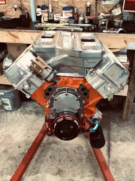

The Hemi I posted is a 528 with a Barton rotating assembly and cam (I don’t know the cam specs)
solid roller correct. I think mine is .646/.676 or something close. TBH I wish I had an extra 100 cubic inches for the cam to take some of the bite out of it on the street ie. idle rpm.
I think its just as important to keep the float level adequate. Because I run 6 psi, I lower the float bowl fuel to 1/8 turn below the recommended spilling from the float bowl screw. With the AFR gauge I'm able to keep an eye out for a severe lean condition occurrence.

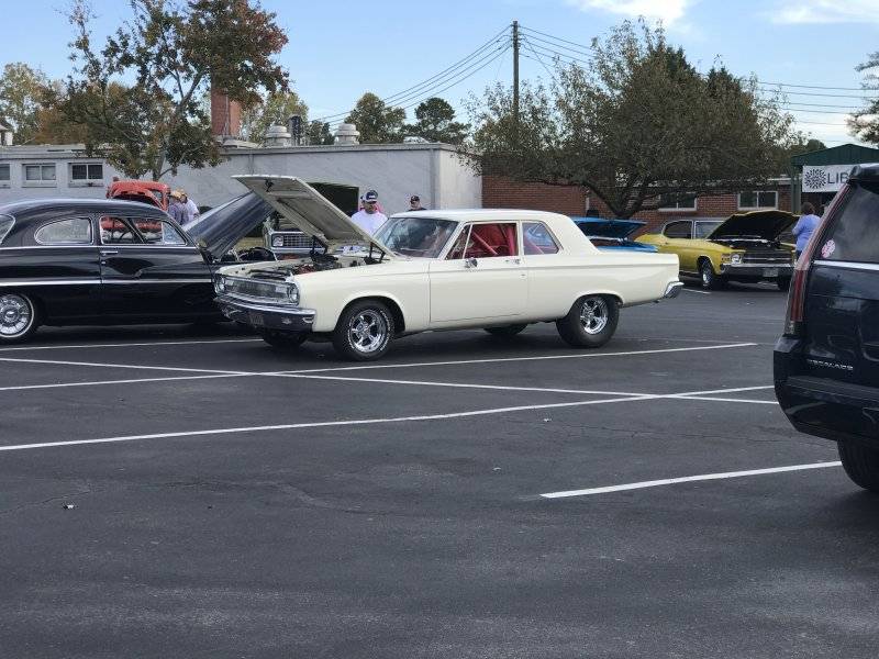

Oooooooweeeee she looks good. How she running? I went to the Don Garlits Show last week as a spectator as rain was predicted and it did. It was a nice show. My first all-Mopar event since I moved south. I may go to the Sunshine State Mopar Car Show this Saturday if it's still on after this weather.
Hi Ernesto! She’s running good now! I have a bit of front suspension work to do (strut bushings oh boy) but otherwise shes road worthy! Let us know if you see anything cool at that show. Weather will keep us indoors I think this weekend as we are dealing with the back end of that hurricane
