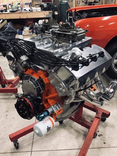

Getting ready to get after my cross ram tuning. I have two sets of carbs I plan to run on the dyno. Original 770’s and a pair of vacuum 850’s. I’ll jet for WOT. I’ll dial in the low speed circuits once it goes in the car.

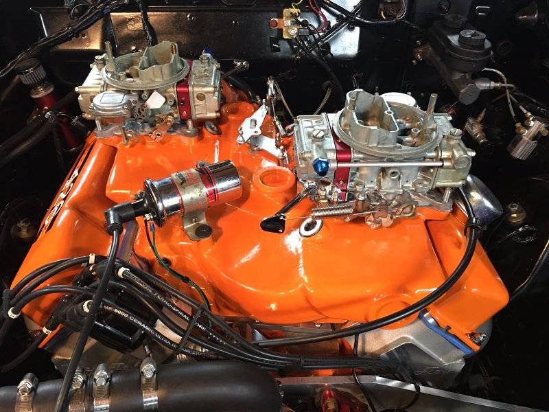

finish hooking up my afr gauge today and see what it says..set up my 770's per above suggestions with QFT metering plates.
I certainly hope it runs great, and I know the AFR system is a great tool for performance tuning, but I have to say, WOW that's some beautiful eye candy!

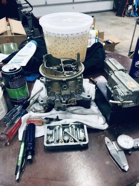

i also installed adjustable secondary metering plates, now able to change jetts and the .100 idle "hole" is now a screw in .028 IFR bleed..ready to start.
something i thought was odd on these new repro 4235-36 770 carbs, the 4235 has 8 bolts holding the base plate to the carb body and the 4236 only has 6. the 2 middle holes r there just not threaded, and looking at pics of other units i see the same thing. seems very random.
