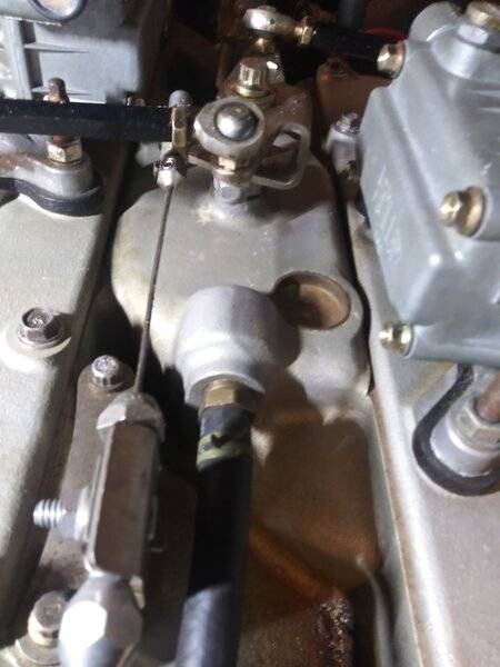

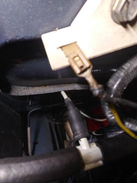

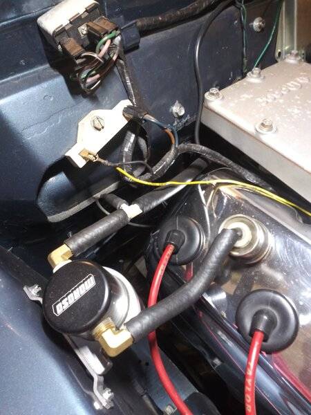

Here are some pics of my set up. Any 3/8 or 5/16 barbed brass fitting will work. I have the 3/8 fitting and hose to the catch can then to the PCV valve. I placed a 3/8 tee in the hose and found a rubber reducer to the 1/8 vacuum gauge hose.

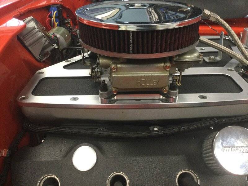

Could you tap a hole in one of the carb spacers? It's hard to tell the height of them in the photos but I'm sure you could get a small enough brass fitting to work. You can screw a plug in the hole after you finish tuning if you want it to be temporary.
hmmm I like that idea... It is .480 tall. I would only have to drill and tap one or both Ernesto?
