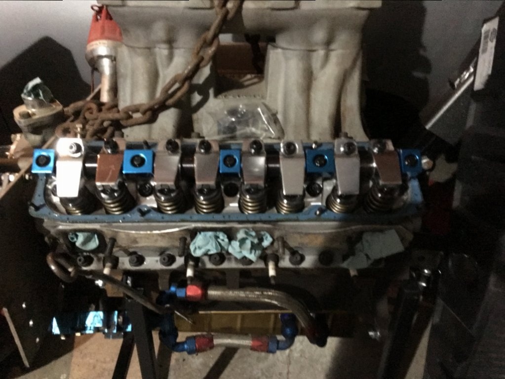

So far it looks like the previous engine builder used all 440 source stuff. Has their high flow oil pump with external pick ups and remote filter. The Milodon oil pan is the race version which I can use if I go with the QA1 k member. It also has the aluminum roller rockers, but they are 1.6 ratio not 1.5...? So that means the lift is probably more like .670ish??? I have no mechanical background. I'm an ER nurse!
Anyway, been thinking of getting the Trick flow 270s, maybe I can use this rocker set up??? Then sell the Stealths, tunnel ram, and carbs to recoup some cost.

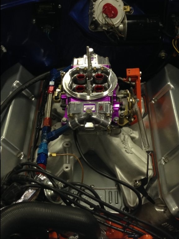

Been away for a while, thanks for intake input, with a single plane would a Quick fuel 950 would be a good choice?
For mostly street a bit smaller would be good. Small carbs can really do well. On my new motor the bigger carbs only added a few HP compared to my old 850 DP on the dyno.
I run a 1050an on my roadrunner that I built. Great carb on the 511, once I got it dialed you can wood it from anywhere in the rpm range including idle and it just flat gets it. It's a 1.59 Venturi compared to a 1.56 of an 850. I'm not sure it would work as well though if it were the downleg boosters. The old 850 Holley is a big carb, some of the these other 850's like a proform are much smaller 1.40 Venturi's.
The QuickFuel 950 is a 1.45 Venturi, on paper it's smaller than an old Holley 850. My carb started out as a proform 850, after some research I just threw the big main body at it. Very glad I did! I did spend a lot of time and effort on it, and it actually seems to get damn good mileage and runs very clean for a big carb.
