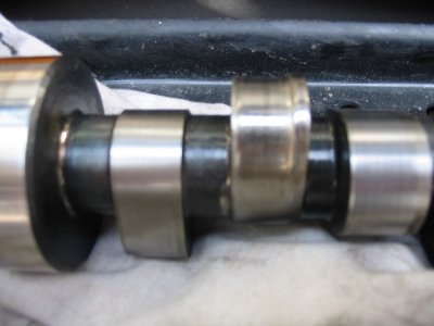

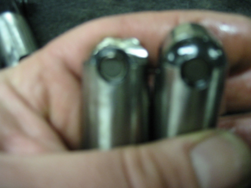

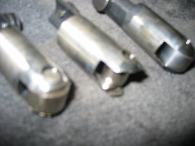

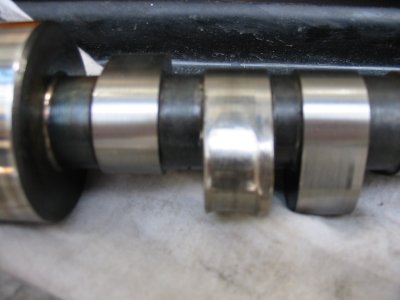

Once you get them set properly,you will still need to check them an a regular basis.Hopefully they will not need any adjustments when being checked.But make note if one or two need to be adjusted snd on the NEXT adjustment the same 1 or 2 need adjustment again it could be an indication that a roller lifter is going bad.Depending on the cam & springs used along with driving habits will determine how long the lifters will last before a rebuild or replacement would be needed.Roller lifters will NOT last forever:happy7:

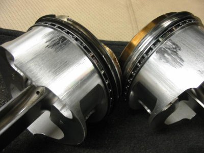

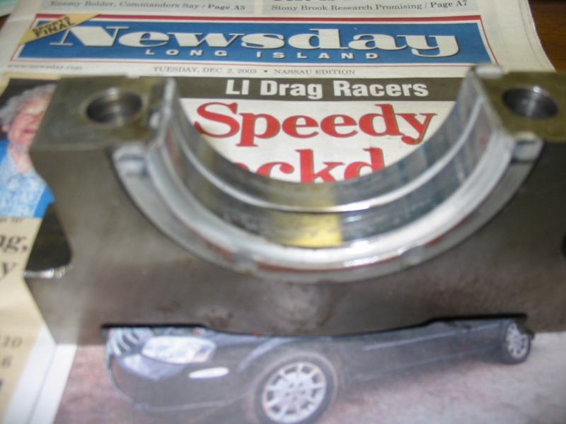

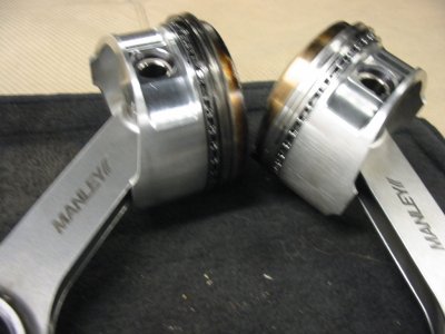

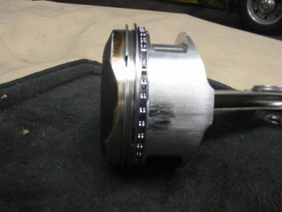

Wow I wouldn't have thought that a roller would wear itself out like that! That is crazy what happen to the cam lobe? did the lifter make contact with it after that? What brand are those? was it ext or int? how did you find it...like a kid I know sorry. lol
The cam lobe was wiped.Heard some tappin,checked valve lash and found very loose rocker.It was all downhill from there.Metal was everywhere including the all the bearings and piston skirts.During this misadventure is when I thought to myself,how did contaminated oil get past my oil filters??I was using fram HP oil filters.After doing my homework,I found that when a milodon oil pump that flows 19 GPM hits an oil filter that only flows 13 GPM {approx GPM #'s},,,,,,the bypass in the filter opens and you ain't filtering **** out,just it goes through the engine contaminating everything.Now I have a double filter system and use Moroso oil filters with NO BYPASS:eusa_think:

Yowza !!! Good thing you found that when you did..
