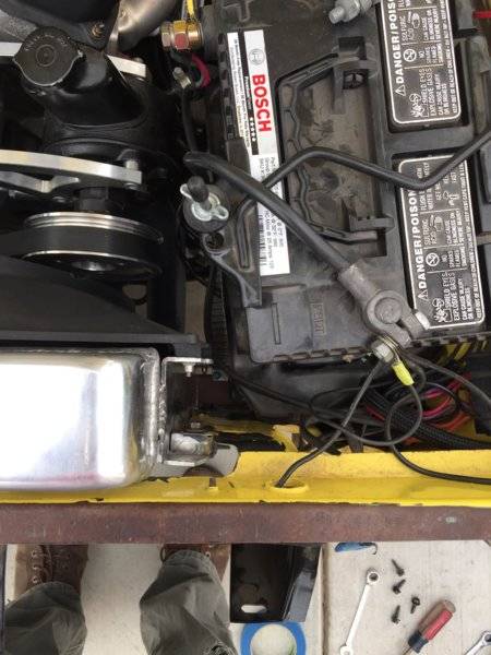

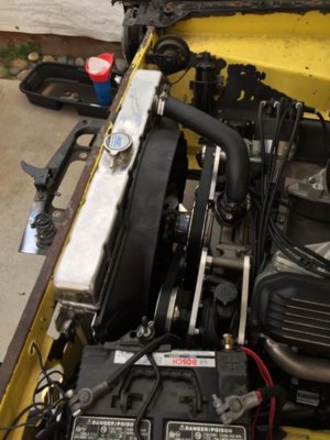

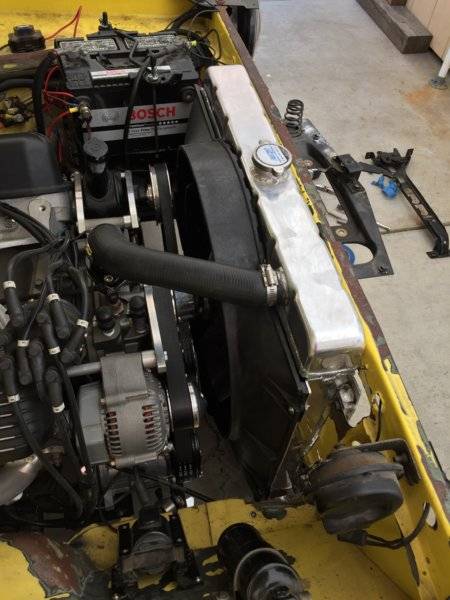

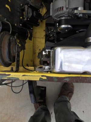

Here’s what I’ve been able to get done. Fired it up this morning and watched both temp gauges, 1 for the instrument panel and 1 for the Holley computer. Both showed 181-186, never got above that. Then I put a piece of cardboard in front of the radiator blocking it completely, temp hot 200. Moved the cardboard and temp dropped to 183 and pretty much stayed there. I moved the radiator back 11/16 and that gave me room for the Hayden 2947 clutch. Also used the 70’ E body shroud. I’m happy with how the ECP radiator and clutch/shroud are performing. I do have ac, so I want the temps no more that 188-190 and when ac is running, no more than 205. Wiggle room!! Thermostat is a Milodon high flow 180 with a Flowkooler pump.
FEC62791-15B1-42B5-9048-7EC4EC986712.jpeg BF2A0357-04BE-4B14-8266-A18A7BB0EEF0.jpeg 4FF8E82C-500C-45FC-8569-17E51A8EC710.jpeg C4311647-DEE7-4174-97CD-6DF261A9A1FB.jpeg 6A08E9E3-0F22-41E8-A399-8E1A5EBFA732.jpeg
Glad it's working out for you. Thanks for the pictures and updates.
I love the idea of using the cardboard to do the testing! Very cool idea!

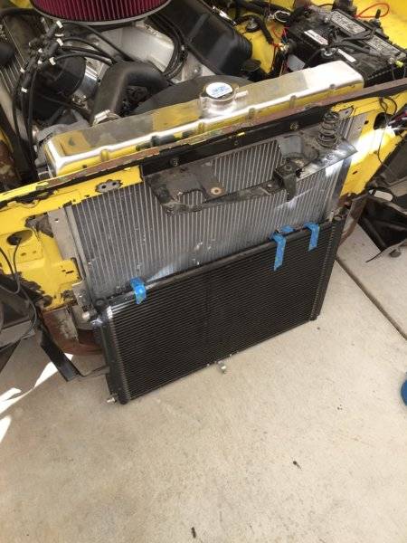

I might have spoke too soon about how well it’s cooling. I installed a new ac condenser about 3/4” in front of the radiator and right away, I could it wasn’t cooling as well as it did yesterday.
So I yank out the condenser and still it’s sitting at 197, with condenser in place it hit 205. Then my buddy noticed the fan clutch not engaging. WTF!!! A new Hayden 2947 and friggin’ thing isn’t working.
