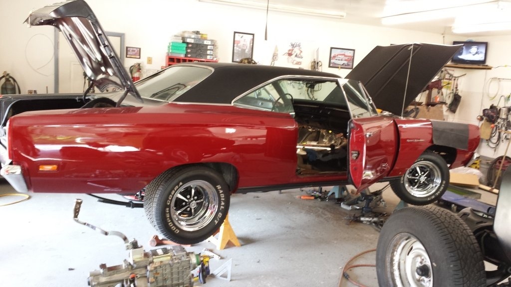

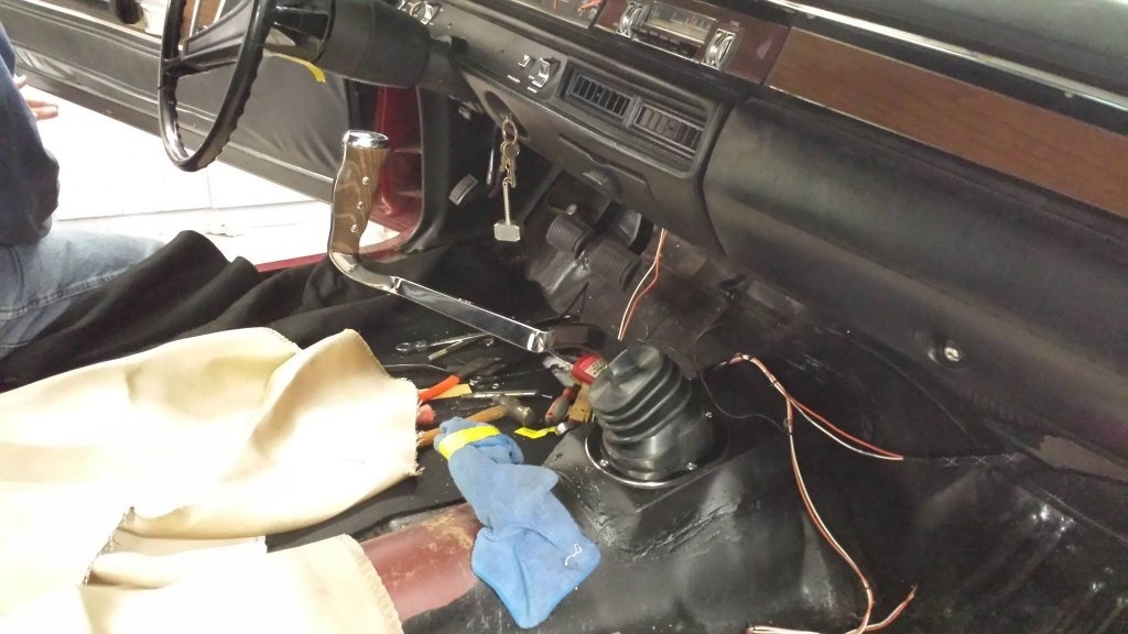

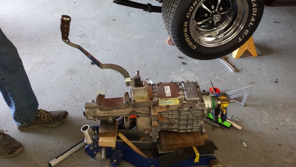

Thought I'd post a couple of pictures. Things are moving along and everything should be finished up by next weekend hopefully. Got the tunnel cut and new sheet metal welded in. Transmission test fitted, it's very tight but it looks like the template and sheet metal SST provided was all pretty close to spot on and everything should fit and line up right. The rod SST provided for the clutch pedal was a little bit too short and wouldn't allow the pedal to sit all the way up but they took care of it right away and are sending a longer rod with the driveshaft this coming week at no charge.
The borgeson steering box didn't want to line up right and we had to shim one side of it up to get the steering to move freely, seemed like the tab they welded on to bolt up to the K member was maybe just a hair off, not a major issue though.
