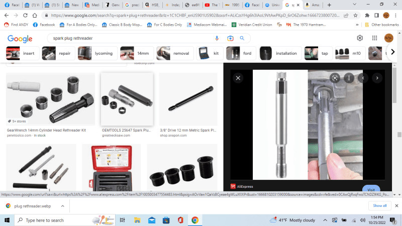

YES! I believe that I'm going to have to use the "reverse thread chaser" that was linked to, it has a center fluted "spreader" that appears to allow the threaded end to be inserted into the spark plug hole, then as the fluted part is pulled into the 4 way split threaded area, it expands the diameter to fit into the threads. Rotate ccw as though you're removing it, and it "cleans" the threads on the way out, WITH the several times recommended grease to grab the shrapnel.

One more try to thread a spark plug in (or maybe 2 tries) and if that doesn't work, I'm getting the fluted reverse thread chaser.

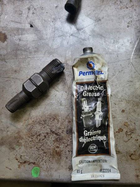

A standard chaser with some silicone grease packed in the flutes will work well. There should be next to no filings coming off anyways.

That's the style. Fluted, so it goes in and then the tapered end gets pulled into the split threaded part, spreading it to the right diameter, then reverse it out, with grease on it, and hopefully problem solved.

Although I haven't taken "one last try" at cleaning the threads, I went ahead and ordered the reverse thread chaser.
I have the feeling I'm going to need it.
$14 on Amazon with Prime (free trail) delivery tomorrow included.
