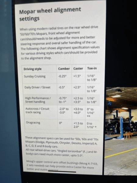

Besides ensuring all bushings and joints are good, yes, getting more positive caster is a great benefit. Whichever method you use, I opted for tubular upper arms from PST, one of the best things I did. Other than new stock parts, (with heavier t-bars ), consider adding a rear sway bar. You don't need a fancy-shmancy coil-over kit-and-kaboodle front suspension for typical use.
Can you get a satisfactory amount of positive caster with stock front end parts and an updated alignment, or does this require aftermarket parts?

Sorry for potato quality pic but as this recommends using the offset bushings for more adjustability.

I was able to get 6 degrees of Positive caster with stock upper control arms and the Moog K 7103 offset bushings. I got 8 degrees of caster with the new QA-1 upper control arms. I looked at this chart.....
.....and chuckled a bit at their meager caster settings.
Caster helps the car stay stable and straight. It makes the steering wheel want to return to center after a turn. You want this. It makes the car more predictable and controllable.
To get the most caster, you do need to also have negative camber. This is just how these front ends are designed. The more negative camber you have, the more caster you'll be able to get. When new, these cars had alignment settings based on the capability of the tires they had back then. Settings of positive camber and almost zero caster were commonly listed as the correct settings for these cars. Radial tires radically changed how much camber and caster you can have without chewing up the tires.
