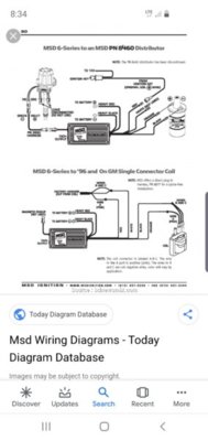

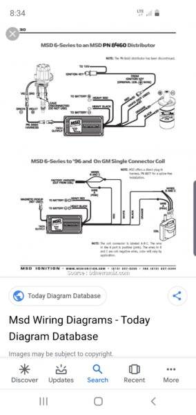

I'm starting to wonder if my msd box is wired correctly? I did it the way the instructions wanted it done. I did wire it to my original ballast resistor.
MSD box is not wired in with the ballast resistor it should get 12 volt direct from the battery.
I wired it to the top diagram. My positive wire from my coil was the blue wire from my ballast resistor.
Ballast resistor should not be in the circuit. Need to get power from the wire that supplies 12v to the ballast resistor not after the ballast resistor drops the voltage.
Then that's my problem. So do I need to buy a non resistor coil as well then.
Well don't I look dumb! Man o man.
