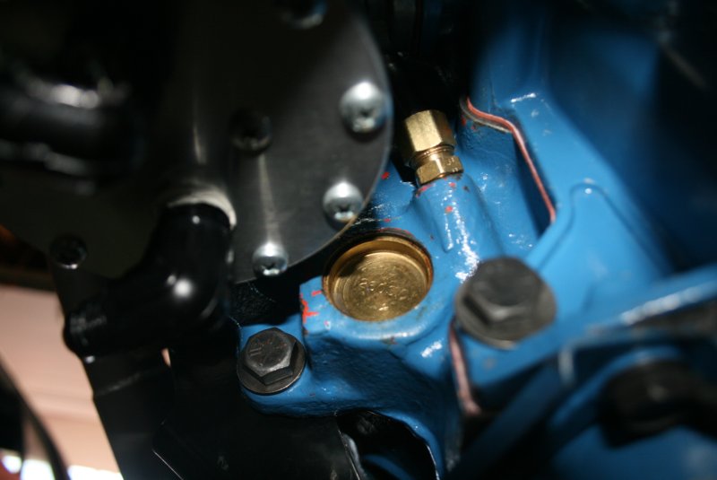

I tend to agree with eliminating the dipstick, especially on a big block where it has to snake through the headers and generally gets in the way when working around that area. When my 340 block was machined I had the port tapped with pipe thread to accept a fitting so I could plug it.
Theoretically, there shouldn't be a need to check the oil level with a high performance engine that's not daily driven. If you see a puddle of oil underneath the car or your pressure gauge goes to zero you obviously have a more immediate issue to deal with.
At one point I did consider running a dipstick/tube setup which could be unscrewed when not needed but it turned out to be more of a PITA than it was worth. This photo shows a compression fitting for that idea but a simple pipe threaded plug is all that's needed.

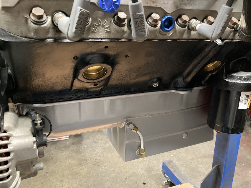

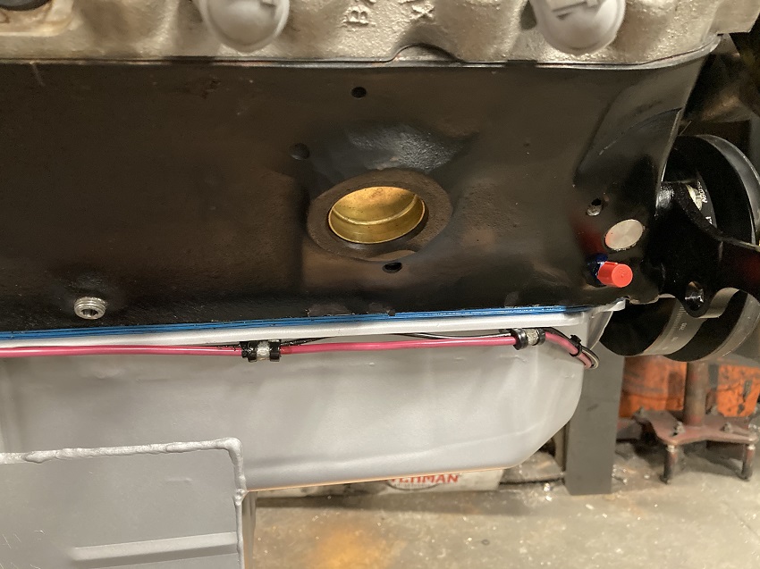

To eliminate the dipstick as a source of crankcase vacuum leaks, I install a sight tube in the pan. Also allows you to see how much oil is in the sump with the engine running..

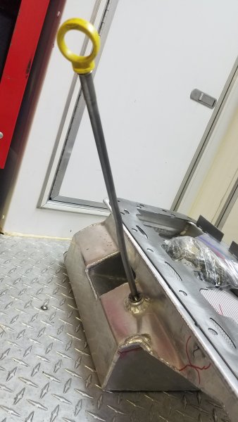

My tube and stick are adapted from a newer Jeep. Stick is O-ringed.
Doug
This pan has been ballooned, cracked, and punctured × 2. Takes a liking and keeps on tickin.

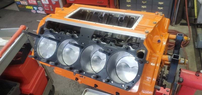

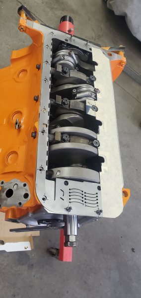

You'll notice the mounts and the outer portion of the core holes has been milled. Along with all the Hemi portion of the deck on this Mega Block. Down to a swvelt 275 lbs.
