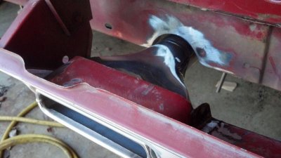

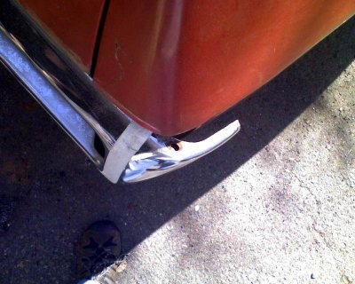

I think it ended up being about and inch on each side, and in about 1.5-2 inches from the mounting brackets.
The tape was the template, cut on either side.

Ill get some pictures of what he did to the brackets on here soon.

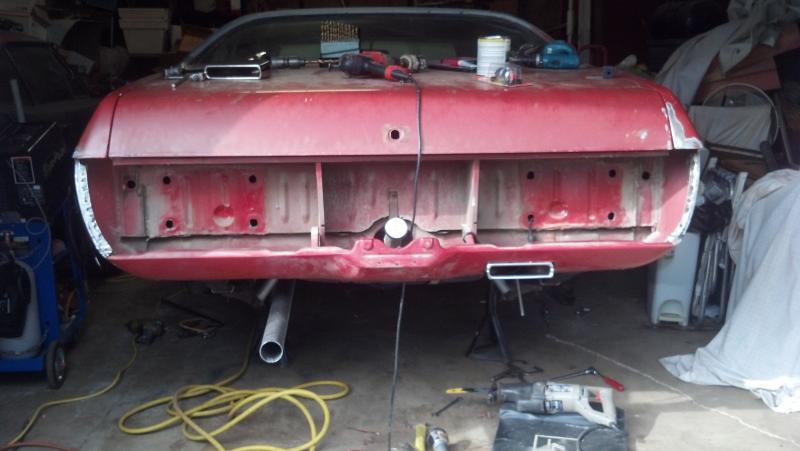

Before i left for work this last time, my uncle started installing the tail pipes on the Satellite. WOW! What a difference! The exhaust was incredibly loud when it was dumping straight down out of the mufflers but it rattled and shook the crap out of my car. Sounds way better with the tail pipes, Better tone, not so muddled and you can hear the cam better now too.
I really wanted a cutout exhaust, kind of was inspired by the cuda's, hes still gotta put rounded lip around the cut out.

I know he wants to do one, ill let him know there have been requests for it. He is going to tuck the front bumper as much as he can too. This project had really turned in to more of a mod than a resto but I am extremely happy with how it is turning out.
The things he does with metal is like art to me, if its mechanical not a problem for me, but body work and paint is another story... hoping to learn some from him but been away working a lot.
Short video's were cool. That exhaust looks great coming out the back with those tips. Used to have a 74 RR and never noticed how much the bumper stuck out till your uncle moved them in. He did one heck of a job.

Im going to have to disagree with Bruzilla, I thing with a narrow bumper it will make the "hips" look wider and I love them hips!!! So does the bumper filler have a purpose? To keep water out or direct it away or purely cosmetic?
I agree rsd, I think if flows in the the curve better, you can see the hips better from the rear. But to each is own.
I believe that it is mostly cosmetic to fill the gap that was left when Chrysler moved the bumpers out for the 5 mph impact law. But i guess it probably kept rain out too. Any one feel free to correct me.
I cant believe that no one is re creating these since almost all that you find are cracked, warped and sun burnt. My dad and i had talked about trying to do this a couple times and selling them on ebay or something. At least i couldn't find any last time i checked.
If I tuck my bumpers, I will have to paint them body color cause I cant afford to have them rechromed. Still dont know what to do. Thats a good Idea on pre tucking the bumpers and re-selling....got to fund your project some how.
Ya, i was already planning on painting body color but it definitely is a big money saver not having to rechrome as well it.

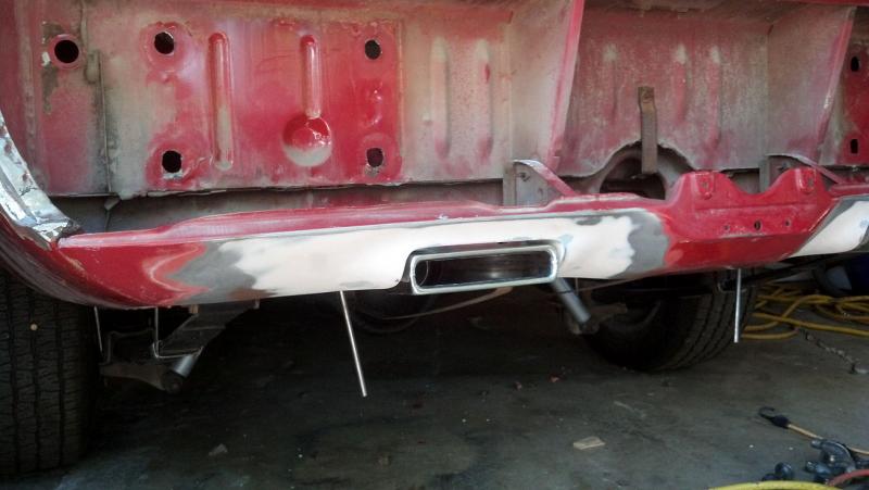

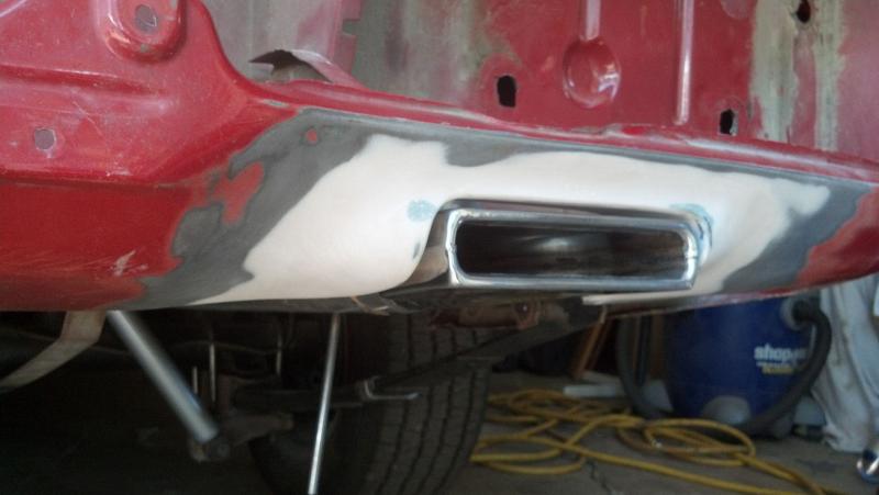

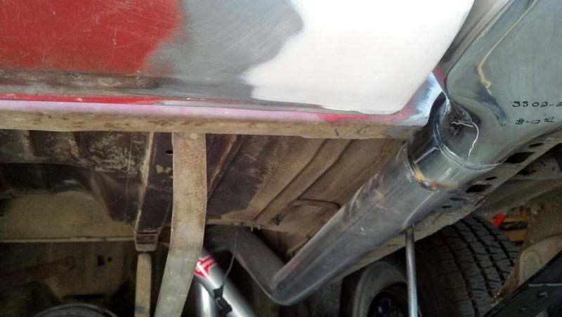

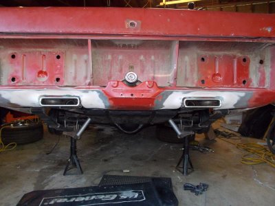

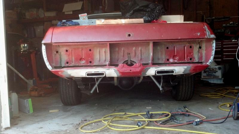

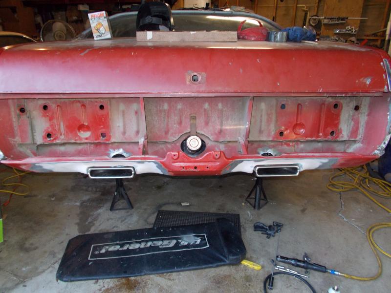

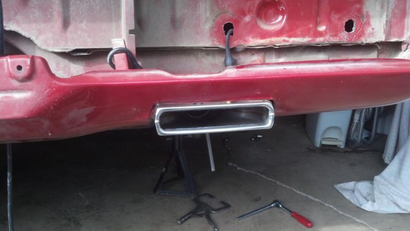

Finally got some time off work and got to come home. My uncles got the exhaust done and cutouts in the valance pretty much done. I just repainted my gas tank and re installed it. Hoping to start working on the transmission swap from a 727 to a 46rh this week too. Here's some pics.

Wow, thats really looking sharp! Your uncle hase some nice fab skills. I just had some pipes ran out the back on monday and I was looking at them last night and the d/s is crooked, I think it will bend tho.
