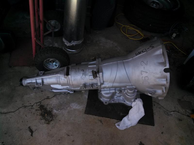

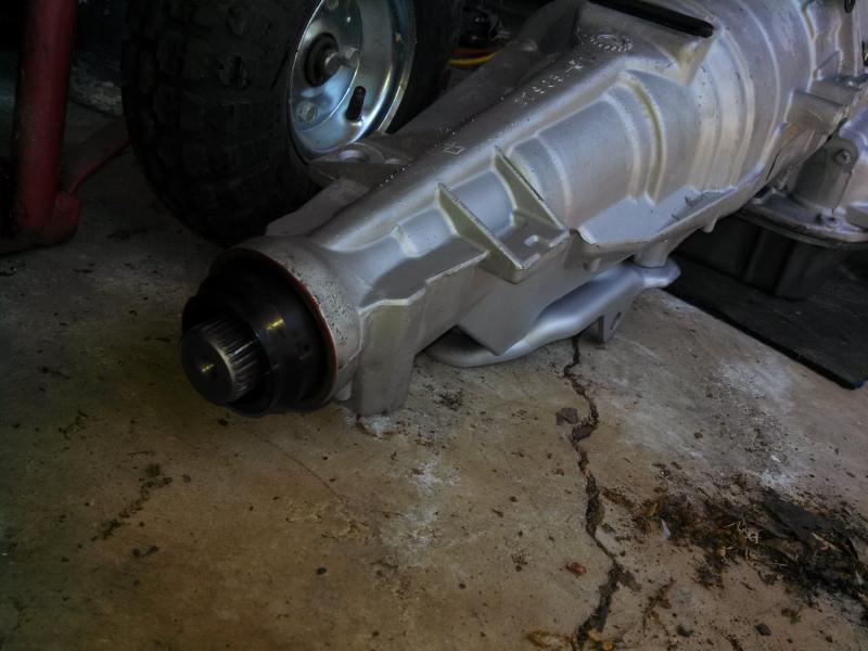

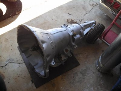

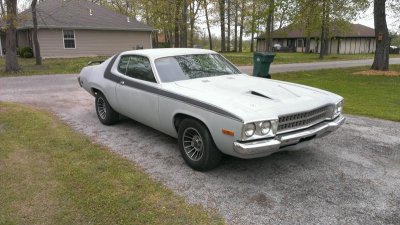

I ended up letting a local shop do the rebuild on the 46RH, picked it up today. Looks great, and they found some other parts that needed replacing.
Still gotta modify the transmission case to fit in the car, but here's some pics.

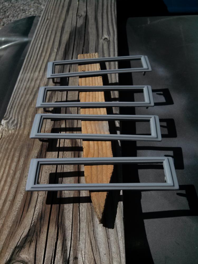

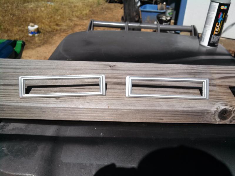

Also got my new marker light bezels de-chromed.

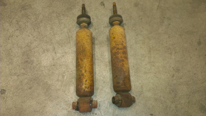

Stripes look good man....Shocks look they definitely needed to be retired. I'd avoid air shocks like the plague for your Plymouth. They like to crack/rip out shock crossmembers and ride like a lumber wagon. If you have old springs on there, odds are putting in a new set will raise the car in the rear. There's also the option of re-arching springs or taller tires. Keep up the good work..

Hey no problem rsd, but to be honest with you, the coil overs will do the same thing. If you ever put your hands and eyes up close on a shock crossmember, you'll know just how flimsy they are. Myself I would consider them the weak link of the mopar suspension system. Basically what you're doing with air shocks/coil overs is using them to make up for a weak suspension or there lack of to suite your needs. Adding them effects the dynamics of how the rest of the suspension is designed and engineered to work, and generally speaking....not in a good way. I know AR Engineering or someone out there was is or was making shock crossmember stiffening plates to help or accomodate air/coil's, but one could accomplish that themselves merely with some 14 gauge steel plates or welding in some sort of cross braces. Regardless, IMO you're going to be better off installing leaf springs that handle the load, disperse travel/momentum accordingly and raise the car as you want. That, or like mentioned..a taller tire. Hope it pans out for you what ever route you decide to go.
Rsd if you wanna do it cheep id find a local blacksmith shop that will re-arch your springs for you and put regular shocks on. Local shop did mine for $80 he have me 2+ inches no problem. Rearend is super jacked up now i like it. I know guys say it wont last as long but this was cheep and easy and allows me to save for new springs farther down the road.
