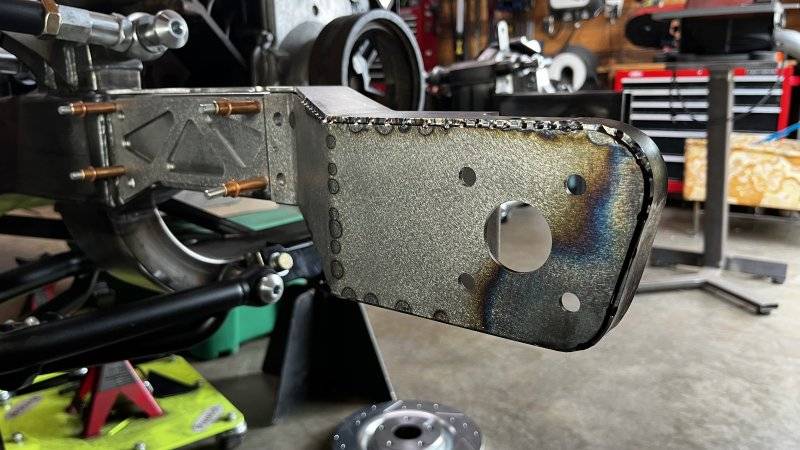

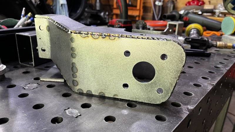

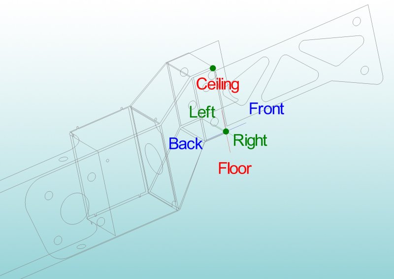

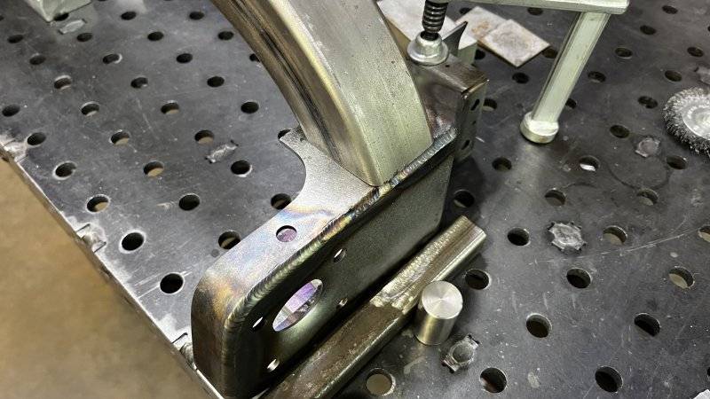

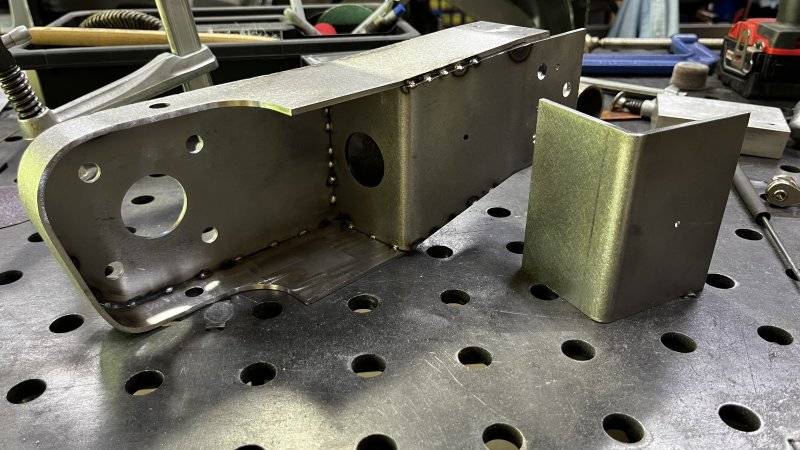

Frame horns underway. I drew this in bend tech and had it lasered and bent at sendcutsend. The pieces came out perfectly, and it takes about an hour to tack assembly each side. Super efficient.
The little corner piece can’t get welded in just yet since there’s a tube that will run through the top, land on the bottom flange, and be in double shear.
Temp install. Also, overlay details.
It runs right up to the crossmember.

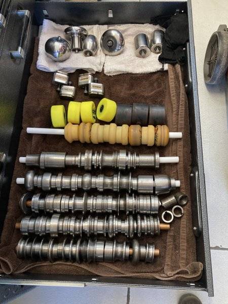

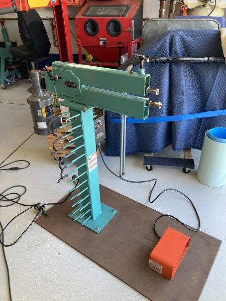

Here is an example of keeping myself focused and out of the rabbit hole. I unpacked all of the dies/wheels etc for my machines today. Got the bead roller cleaned off and ready for use. I already have a small fortune invested just in this stuff. Glad I was able to buy it when I was more flush. Now I just have to re-learn how to use the stuff.
That's a darned good collection of rolls and a nice machine.

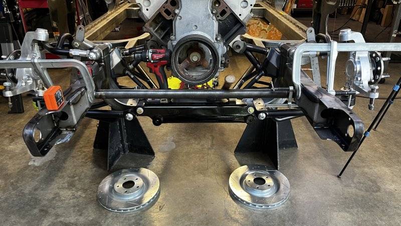

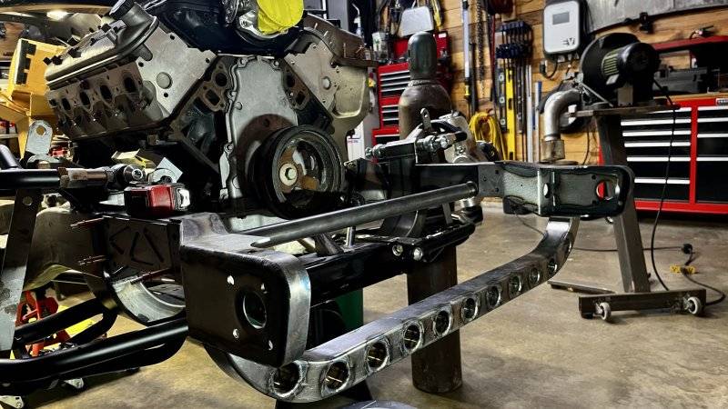

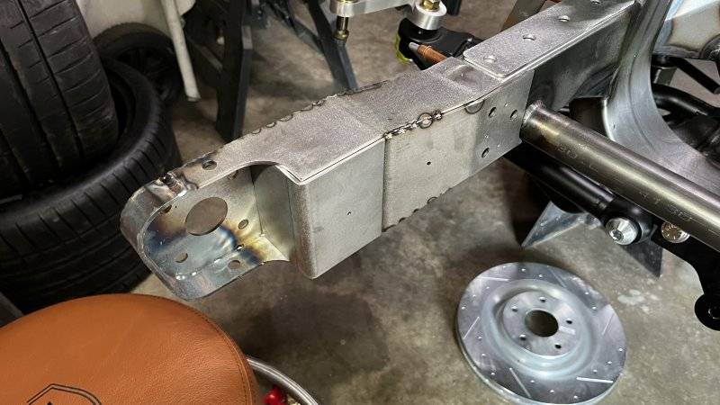

Frame horns are burned and roughly fit. I have an old XV crossmember that will tie them together, but right now, the rear axle mounting needs some attention.
David

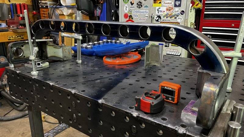

I’ve been going for the “OE-plus” look on these frame horns. These are inspired by a 1st and 2nd gen GM F-body frames, and actually come out to the the same width as the original Mopar unibody frame stubs (36”). That lets me make use of a “Mopar” part I’ve been hanging onto for a few years now. That little corner plate is left out for now because a tube lands in the interior.
This was my first time using the bending service at SendCutSend, and it came in super dialed. All I had to do was fixture it together and weld.

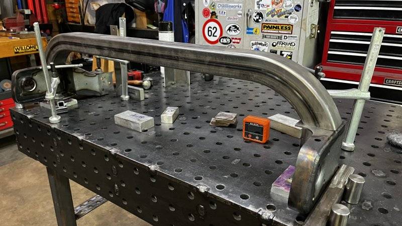

Horns moved to the table, set at 36-1/8” apart.

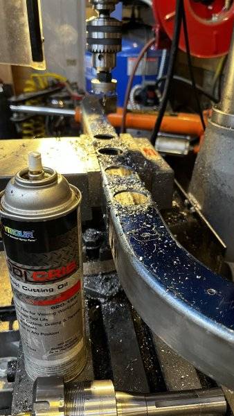

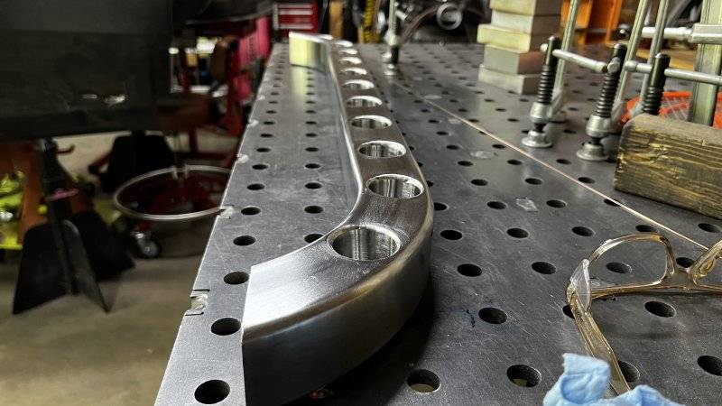

It’s a bit tank-ish, but this will be the first structural part to take a hit on a steep driveway or ditch. So, it’s getting slugged with thin wall 4130.
Kind of reminds me of the US Car Tool stuff.

Will you be putting a tube inside those holes?

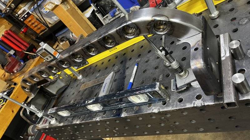

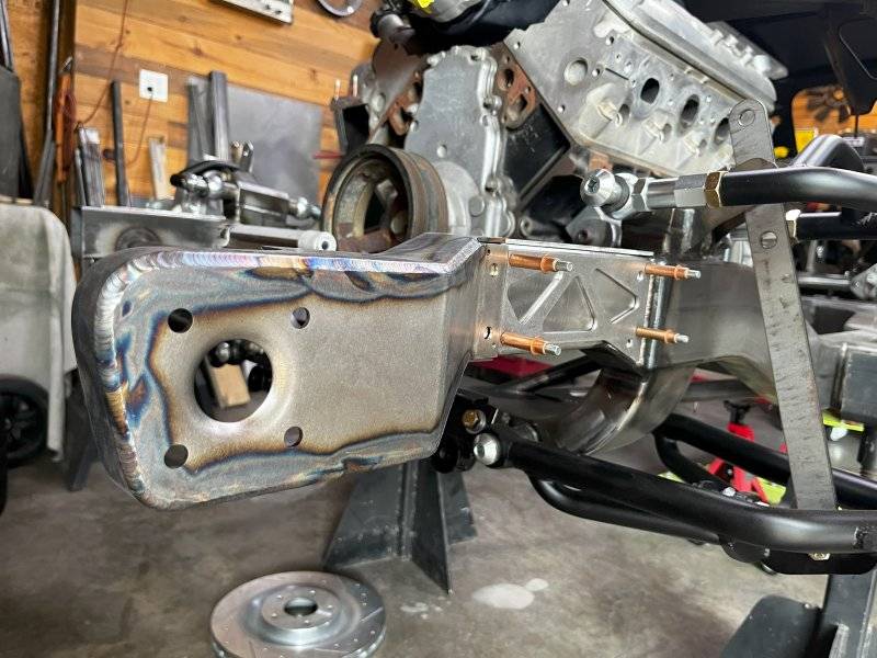

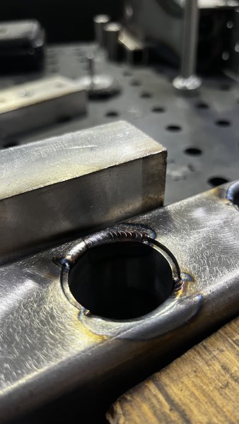

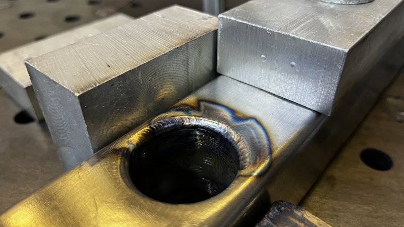

95A first pass, cleaned up and prepped for cover pass.
100A pulse cover, my norm for anything that remains visible. It’s the off-road guy in me, treating everything like it’s a trophy truck build.
Tacked a ready for test fit.
I’m glad I didn’t get rid of that XV crossmember.

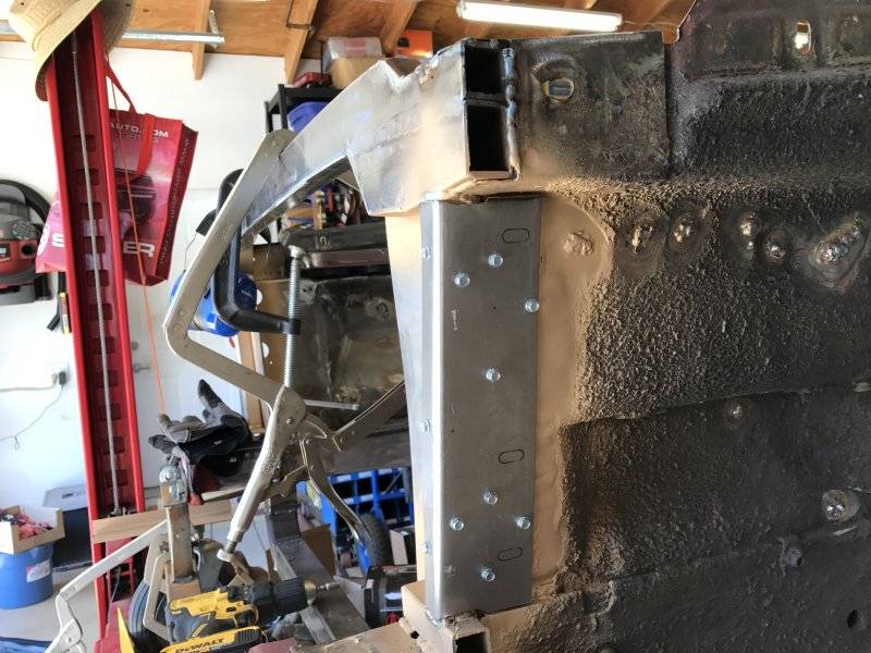

When I made mine, I sourced some ornamental iron fence 90's from Industrial Metal Supply as I didn't have access to anyone to whip up 90's in square tubing at the time. Welded those to a piece of 2" tube, anchored the other end of the 90's to some strap and stitched the unit to the existing rails. I like yours better but made do with what was available at the time. For the upper tie bar, I did find a gent who could give me a curve bend on rectangle to match the old tie bar. Added some other pieces to that then a couple of vertical pieces to the rails with 16ga wrapped around the outside to the inner fenders.
The best thing about hotrodding are all the different solutions folks come up with.
Thursdays are for hanging with my wife, but I squeezed in a quick 10 minute fit test on the car.
Like a glove. Whew!
