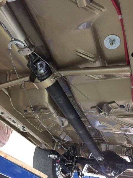

Time to hit the track again. New driveshaft is in place, ready to go, hoping to correct traction issues and a new personal best, pending weather.
New Strange DOM driveshaft, C/M ends, billet yokes. High strength u joints and u-bolts.
Trans removed, all checked over, good to go.
Going into the weekend with things stiffened up lots.
Added 10 lbs onto the car with the new driveshaft!

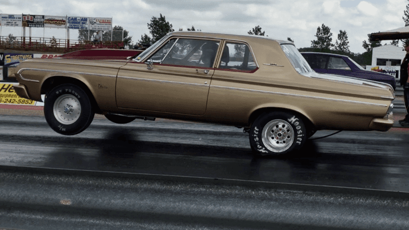

Shot of my leaves today on the stiff wall Hoosiers with 12 lbs of air.
Do you run tubes? Are the front shocks tight on rebound?
Doug
Doug
No tubes. Front shock rebound set on 6.

My rear QA1 shocks were full tight and my rise is still maxing out to where it will unload the rear tires. The leaf springs run out of travel it looks like and then it unloads. So That has to be my immediate repair. Doug mentioned shock valving. Perhaps these QA1’s can be valved to be stiffer or maybe Calvert shocks have more restrictive valving out of the box. I tightened up the front shocks lots on the third pass and it kept the front down but the rear came up and unloaded worse. I haven’t given tubes much thought, yet, but I’m certainly game. I’ll see what I can find for video.
It has enough power now that the tire is over worked. Tubes will help. It may need the front spring eye location lowered. That's what controls the amount of rise. The shocks control the speed at which it rises. It's rising far enough it may be topping out the shock. This is Cal Track , correct? Send the video to Calvert and see what he says. We leave at about 4200 on the brake with Cal Tracks on my sons 62. It doesn't rise near that far. But it does have a very good set of double adjustable shocks.

As Doug said and video shows , crushing tyre . So more psi or less hit on tyre - or a bit of both

You first pix above sure looks like that 12lbs of air is way too low the way it is crushing that stiff sidewall Hoosier.
