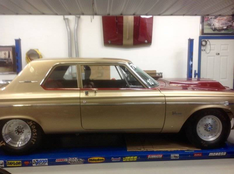

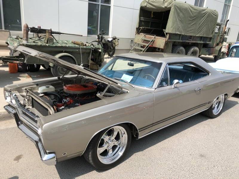

Bob, Here's a few pictures you should like. I did this GTX back in 2007. We took it to a car show today, 300+ cars, the old girl brought home best of show. This is what you have to look forward to.
And then the army shows up..lol That Ma Deuce sitting on the trailer sure brings back memories of a long time ago...
I wish he would put the correct air cleaner back on it... something to do with orange.
Malex, Congrats on the show award, I'd have to agree. That is a sweet ride and I also agree the air cleaner is a bit too shiny.

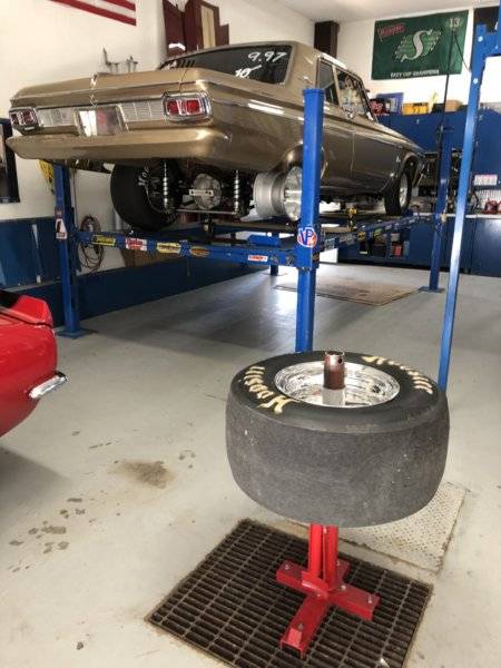

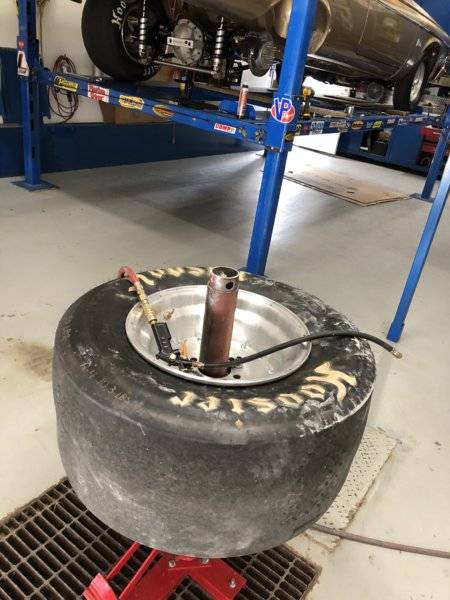

I had this little tire machine that I modified with a tele post and today it was time to try it out.

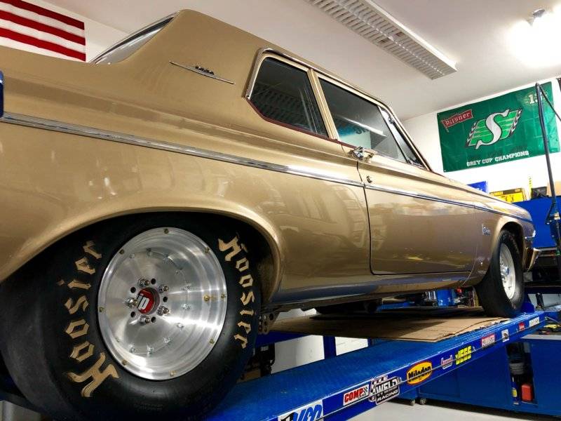

The draglites coming off were 15X12's and the Super Tricks going on are 10's.
Super Trick going together, lots of baby powder floating around. Still 7/32" in the wear holes so what the hell, get them on.
So here's the new look, 4 lbs less rotating weight with the Super Tricks.

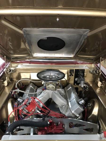

And my hood air pan in the finished state complete with air bell seal.
Hemi hood and Super Tricks. The plan is complete.

Each wheel ended up being 2 lbs lighter. I'm 4 lbs lighter overall switching to Super Tricks, so there will be some increase. The heavier hood weight will eat that up.
I think it's going to come down to which hood performs better, I'm real interested to find out.
Draglite-tire-tube-screws were 50 lbs each
SuperTrick-tire-tube-screws were 48 lbs each.

So not sure if it was GTXracer, 69GTX or LW who recently asked about the rear Super Tricks. Anyways, that's been on my mind.. And as you could have guessed...
