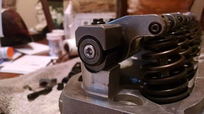

AND geometry correction for ANY brand of head, I had T&D rockers & he made the custom offset spacers for my 440 Source heads & the LIFT of my cam
you can see the offset shim, spacer under the rocker shaft
