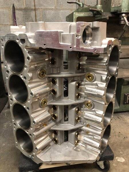

Does anyone have a Mopar 180° thermostat that is the BEST and why?
I'm most interested in highest quality materials and DESIGNED TO HELP PREVENT AIR POCKETS.
I'm going to be cooling THIS, and aluminum heads, and I absolutely do NOT want to overheat!
