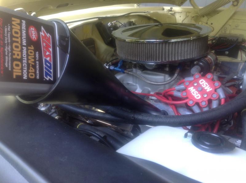

Also put the 73 up on ramps for a new oil filter and change, Or change and then oil filter lol..

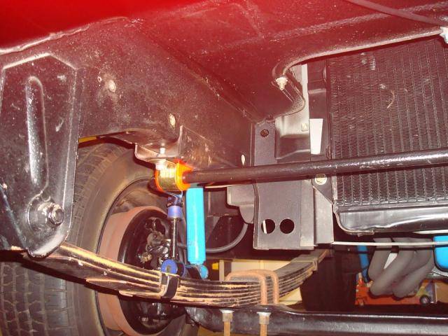

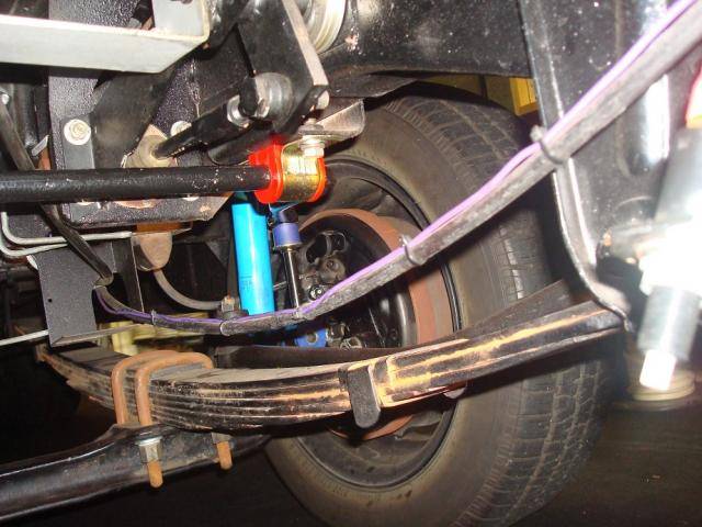

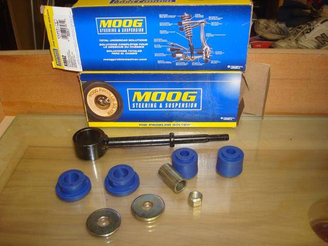

Not a 'B' but it's all MoPar :headbang: Finally able to install my new 46 year old sway bay, complete with the new end links...
for anyone who has an A100 needing sway bar mounts - the Moog part is actually listed as for a Ford Explorer, and looks/fits just like the real deal. Just waiting for Monday to roll around to buy the new fixing bolts for the shocks and links. Needs a 6" bolt now.
Moog K8662 x 2 required. :eusa_dance: They can be bought from Napa or Summit Racing.

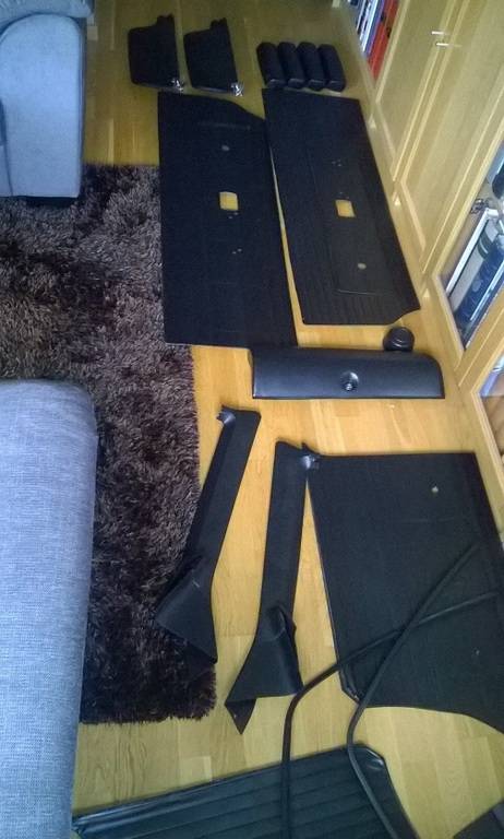

Been searching online for some interior parts. Refinish or buy repops if I have to. Man interior parts seem hard to find. Glad I have most of it intact. Just needs some tlc. I admire you guys that are searching for just about everything interior.

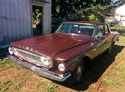

For the first time in over a decade, the Dart pulled out of the garage on its own power.IMG_20140731_094759.jpg
Sweet 62!

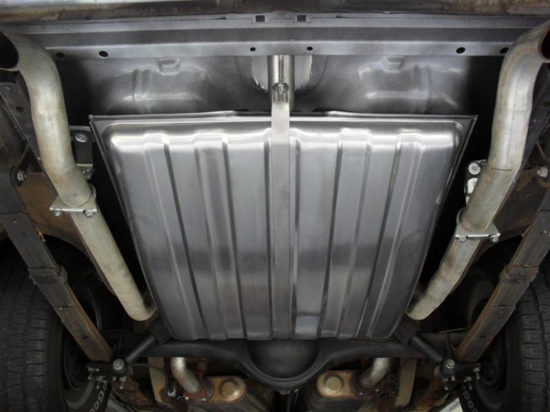

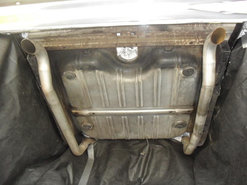

Just finished installing new gas tank after media blasting and painting bottom side of trunk floor.SAM_3138.jpgSAM_3140.jpg
