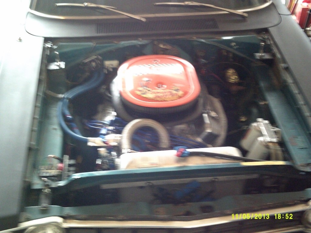

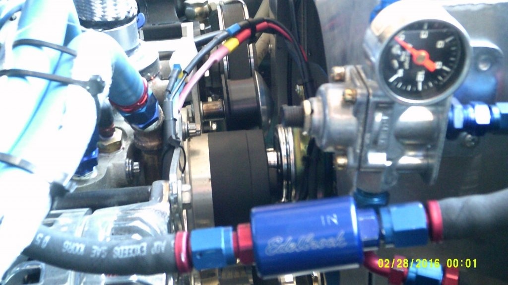

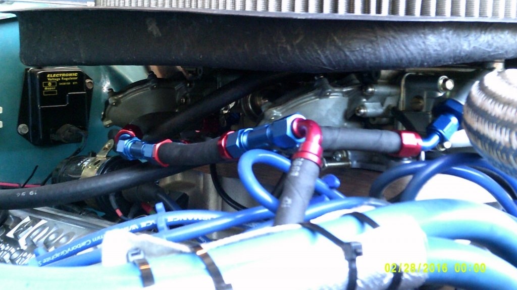

Added phenolic spacers under my low-deck 6bbl,
also new -6 AN fuel lines & fitting
with a repop fiberglass A12 air pan to seal the hood scoop to the pan
nice clean fresh cool dense air {had a 70 style 6bbl non fresh air base}
had to do a bit of mods to the outboards spacers to clear the 50cc acc. pump
& trim a bit off the rear spacer front portion 1/4" cut off, re-jetted...
kind of a hassle on a 68 RR with the 2 speed wiper motor sticking straight out
I had to clearance a bit on the base with a hole saw nipped a part off
at an angle & kept the top flange, if that makes any sense ?...
I doesn't go into the air cleaner area thou....
seems to really like it on the beat run the other day
View attachment 348435 View attachment 348436 View attachment 348445 View attachment 348447 View attachment 348449
Nice to see some of your work, always chatting on here but rarely see that bird! Looks great.

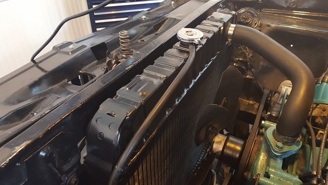

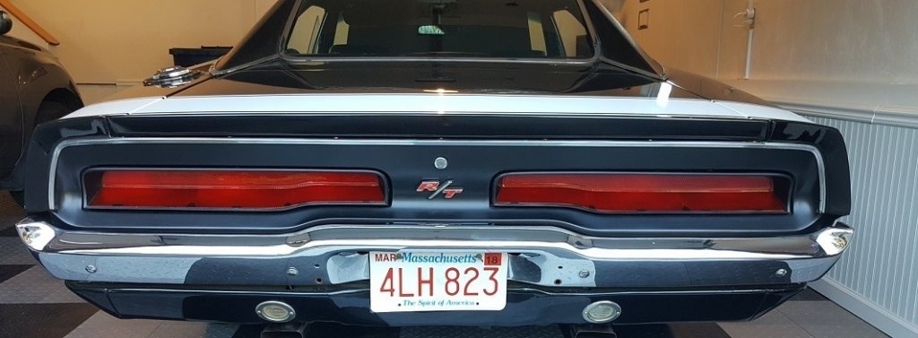

Replaced my tail lights a few weeks back and just installed a new radiator yesterday.
