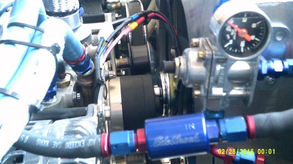

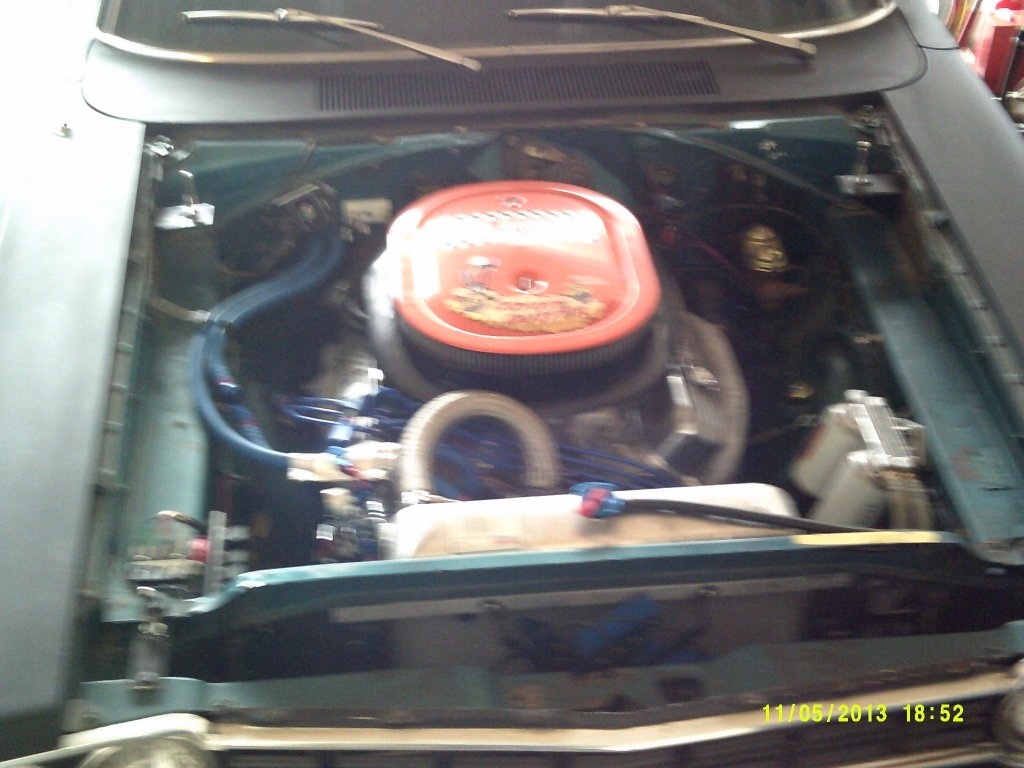

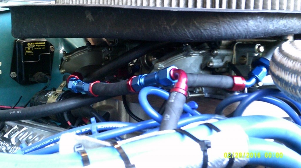

Added phenolic spacers under my low-deck 6bbl,
also new -6 AN fuel lines & fitting
with a repop fiberglass A12 air pan to seal the hood scoop to the pan
nice clean fresh cool dense air {had a 70 style 6bbl non fresh air base}
had to do a bit of mods to the outboards spacers to clear the 50cc acc. pump
& trim a bit off the rear spacer front portion 1/4" cut off, re-jetted...
kind of a hassle on a 68 RR with the 2 speed wiper motor sticking straight out
I had to clearance a bit on the base with a hole saw nipped a part off
at an angle & kept the top flange, if that makes any sense ?...
I doesn't go into the air cleaner area thou....
seems to really like it on the beat run the other day
68 RR #29 479c-6bbl #6 AN lines & phenolic spacers.JPG 68 RR #26 479ci-6bbl Dec. 2013.JPG 68 RR #30 A-12 6bbl pan & fresh air air-cleaner w-phenolic spacers.JPG 68 RR #33 A-12 6bbl pan.JPG 68 RR #36 479ci Fuel reg. fron to engine rad etc..JPG

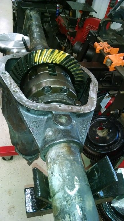

Put a fork in that pig . . .
Made another trip up to visit 747Mopar in Ohio . . . and had yet another great trip. We attended the Goodguys Show in Columbus on Saturday, and had a great time wandering around and viewing all the incredible cars . . .

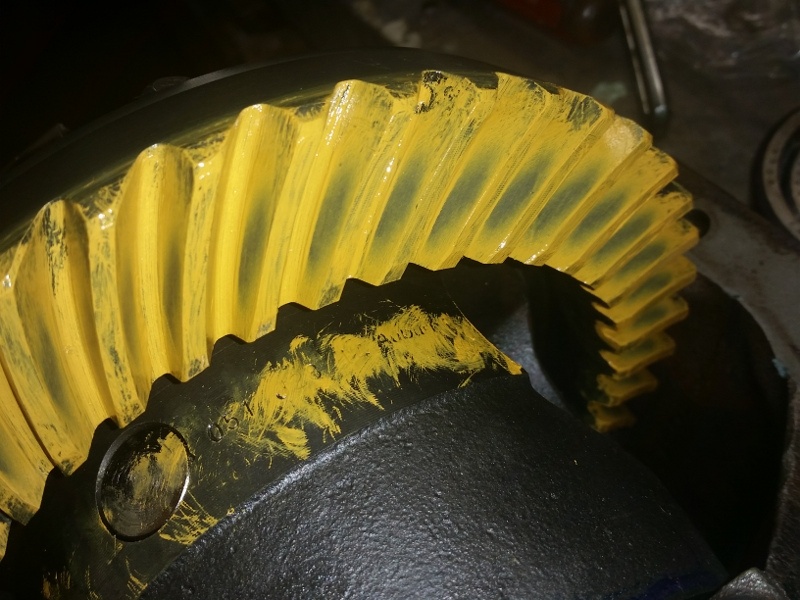

Part of the trip was to have have Devin help me with assembling the pig for my Belvedere convertible - that consisted of a trip to Summit Racing to pic up a new 3.91 Ring and Pinion gear - and all the rest of the part to get the Auburn Limited Slip gear ( that I bought last year ) assembled in the pig . . .
And the build was a great success . . . yes, it took 3, or 4, or 5 . . . ok - Who's counting attempts to finally get it right . . . but here's the ring pattern
