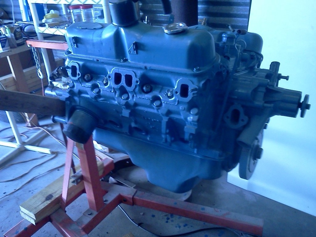

Got pan and gasket back on.
Put a little black RTV on the pan step where the tit of the rubber seal goes in, ran a bead over the junction of the timing cover to block, a little where the main gasket meets the metal of the timing cover (where there was a also depression in the casting), and some where the flat gasket meets the rubber.
Torqued to 120 inch pounds in 10 lb intervals starting at 60 lbs with the middle bolts and working out.

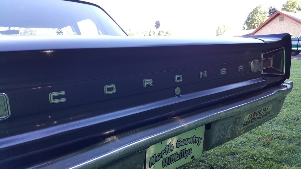

Earlier this week I had finished painting the trunk lid of my car and mounted my new letters. I figure 99% of the population will not know that something changed or that it should only be 5 letters back there. Lol! Yay for the small things :)

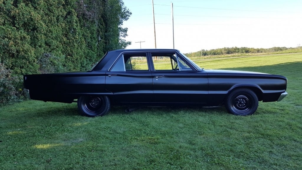

Side shot. I painted the wheels the same color as the car, I just did a few coats of clear over the top. Not sure how I feel about it yet. I'll give it till the end of the season and may change it up over winter to something else maybe a charcoal with heavy flake in it or go powder coated.
Cool car , great idea, love it.

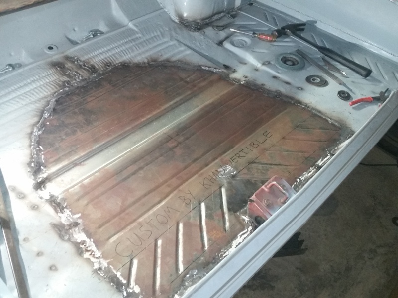

Cut the big spare tire well in the trunk out ( no more basement in the trunk ) and fabricated up this panel to make the floor of the trunk flat . . .
All of the welding is done, and most of the grinding . . . need to double check the underside - finish grinding - and get it in epoxy primer . . .

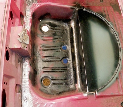

Looks good, I'm thinking I'm having to do the same, what are you planning for a fuel tank if I can ask.
I did something similar with mine, but I only took the front half. I also modified a gas tank to utilize that space, giving me another 5 gallons in the tank.
I'm keeping the deep pocket in the back half to be used for other uses purposes, storage, battery well, electronics, whatever... I haven't decided yet.
I'm mini tubbing and relocating the springs, haven't looked into fuel tanks or cells yet, was hoping to cheat off of someone else if I could.
