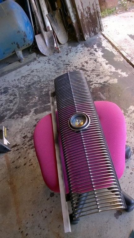

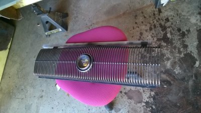

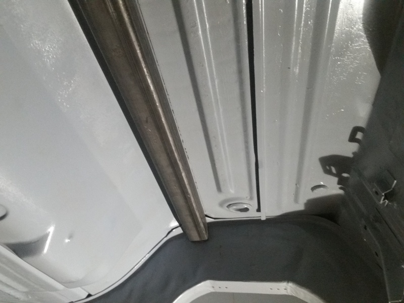

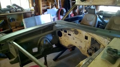

Finished closing in the right tub, built a set of aluminum rails to mount my broken '66 grille on in order to make it stay in place at the broken ends so I could braze them back together. Worked out great, I left it on the rails while I cleaned and sanded, and painted and polished it. It's still a driver but at least it's clean and looks nice. Dug out the headlight case covers and started on them too.. also yesterday I sanded the left fender down on the inside and then repaired a rust spot on top back near the end. I also welded closed the antenna hole and the turn signal indicator mounting holes. Put a bit of filler over them and epoxy primed the whole fender. I primed the cowl as well and it needs some filler too. So, it's coming along again.

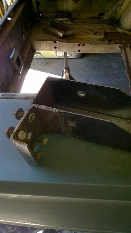

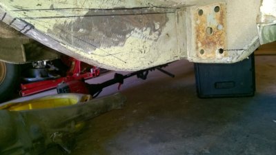

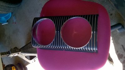

I finished the headlight case half this morning and started on the other one. I forgot to say that I have the frame all ready to cut out the portion where the leaf spring bracket goes. I cut the ears off of the old hanger and welded it to the side of the relocation bracket for some extra stability. It doesnt look like a good welding job but i beat on it with a sledge hammer and it made no difference, so i suppose it will hold up.

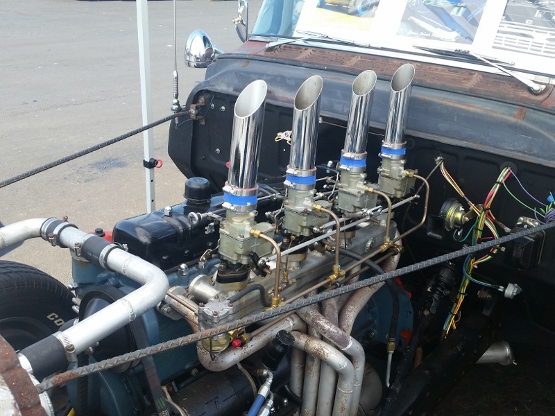

This really cool setup in a Dodge Pickup truck - Straight 8 . . . ( love the rebar )

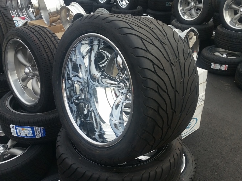

Saw this set of tires and I thought I finally found what I wanted for the rear of my car - but the tires are 16" wide and my wheel wells are barely 16" wide - darn it ! !
