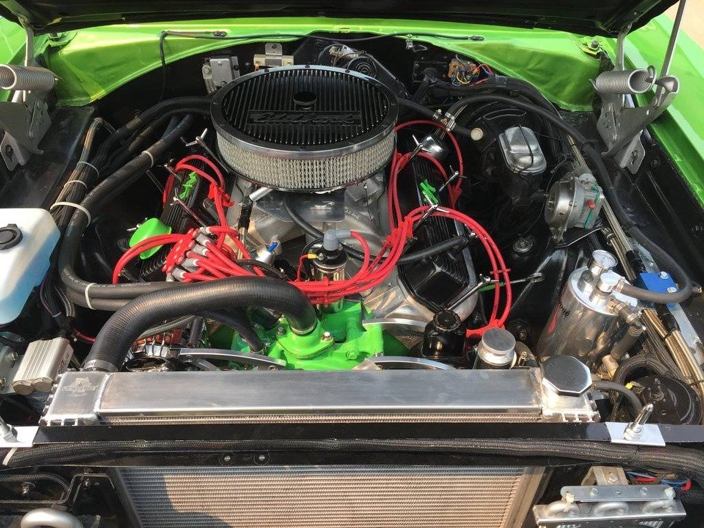

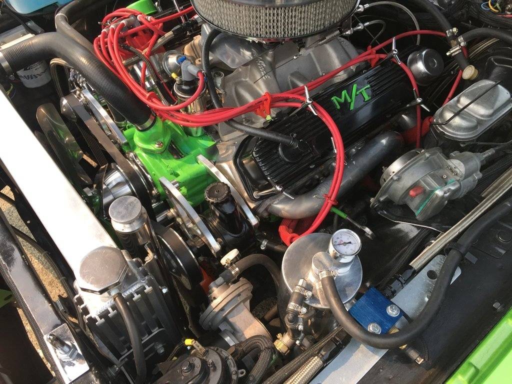

What did you do to your Mopar today?

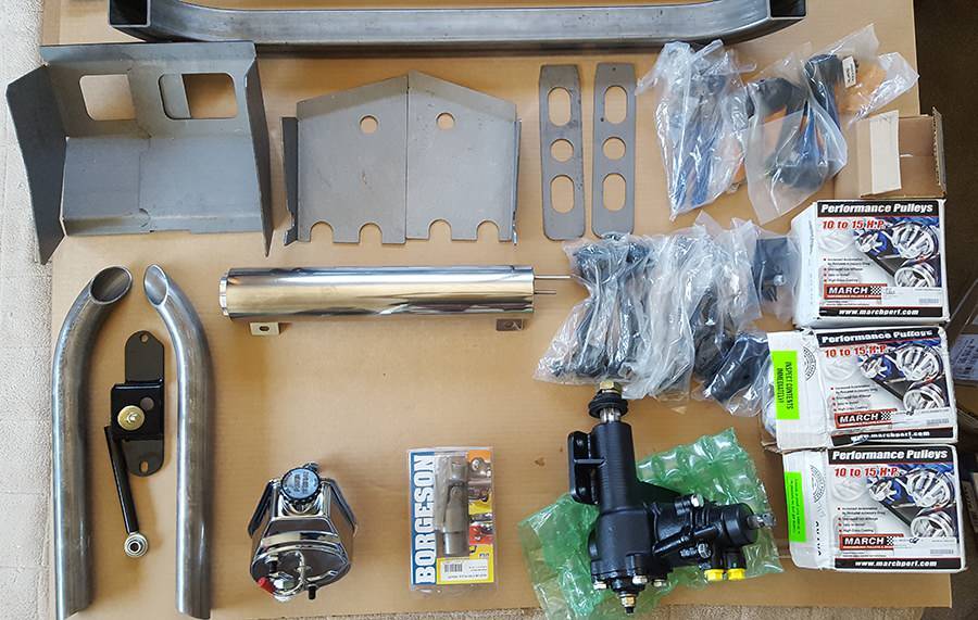

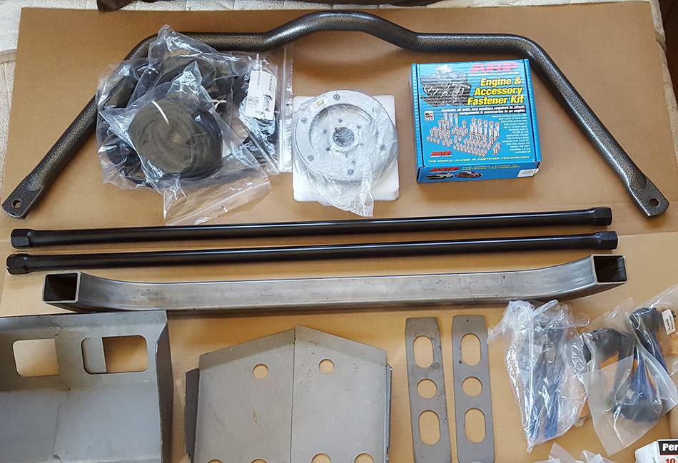

Pretty much everything, except for the new serpentine March pulley set (will arrive on Monday) with covers for Alternator, WP & PS.
Hellwig front sway bar, 1.375" hollow. Nice finish, nothing fancy. Pretty beefy over stock.
https://www.summitracing.com/parts/hel-55903
Summit black braided wire wraps, trying to clean up and make things look tidy.
Pro Sport harmonic balancer, Mancini.
Stainless ARP bolt kit.
Firm Feel TB, 1.06"Dia, again pretty beefy over stock.
XV-Racing lower radiator support, pretty solid and straight piece.
U.S. Car tool torque boxes, upper left.
XV-Racing inner fender braces (left), decided to go with tubular as my global west sub-fame connectors are also tubular.
Torque strap (Mancini), why not...
Champion radiator overflow tank, to go with my champion rad and a cleaner look.
Borgeson chrome PS pump, U-joint and steering box. Box is way smaller.
PST steering linkage rebuild kit with 11/16" steel sleeves, new pitman and ilder arm as well.
PST LCA rebuild kit, http://p-s-t.com/i-23159728-perform...l#!year=1969||make=PLYMOUTH||model=ROADRUNNER
March alternator and PS brackets, black.
Will hopefully get all this done in the next few weeks.
Looking forward to having a better setup once complete with minimal headaches...

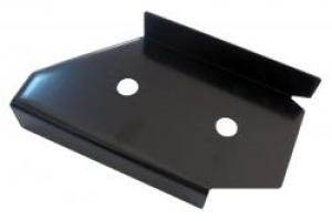

I forgot to take a picture, but today I welded in the rear support for the driver's side trunk extension on my 73 Charger.

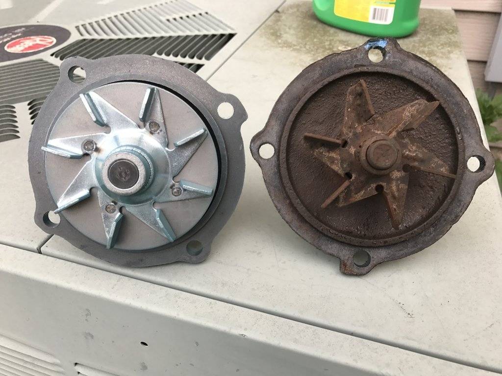

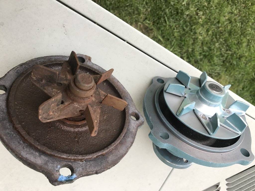

Getting ready for the drive out to Columbus for Mopar Nationals I decided to give the cooling system a mini-overhaul. I had the radiator tanked, pressure tested and repaird. It's in good shape for a 50 year old piece and while tempted to swap it out I wanted to keep the factory look. It was missing the fan shroud so I ordered one from Mancini along with the brackets. Since I had it all apart I also picked up a new waterpump from Summit. All in all I'm very happy.
View attachment 495877 View attachment 495878 View attachment 495879 View attachment 495880 View attachment 495881
I don't mean to be critical but the impellers on the pumps are facing opposite directions.

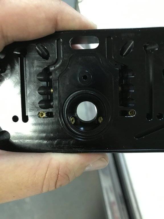

Did some fine tunning on my center carb. Switched over to a billet metering block and leaned the ifr to get rid of a slightly rich cruise condition. Also had to lower them, they started out in the high position in this block.
I don't mind...I didn't make it, haha.
I saw that too, but it being open face and non directional it should be fine. I like the backing plate that will help with pressure versus the stock unit. So far, so good with the test rides.

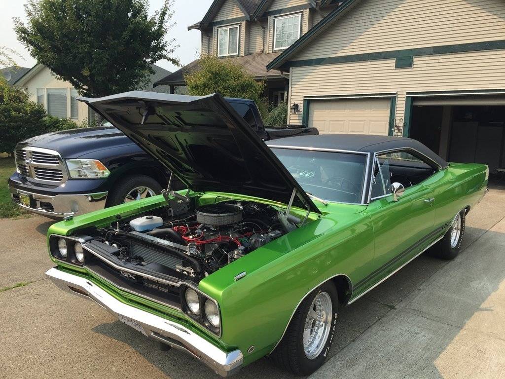

I previously posted a thread asking for suggestions, thinking I had an oil leak spitting out from one or more locations along the bottom of P/S Head. It turned out, the valve cover was leaking. This accounted for the clean oil upon the garage floor and the header, later observed after things had cooled down. This was initially overlooked, given the more apparent fluid leaks, mistakenly thought to be a combination of oil and coolant, streaming from beneath the lower head bolts.
Well.., I tried my best to re-seal several leaking header flange bolts, but finally tossed in the towel.

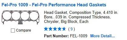

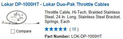

I towed the 68 GTX to a master Mopar mechanic who determined all the header flange bolt holes on my original heads were toast. Several parts, were subsequently swapped out, to improve upon performance & reliability of my most recent build and setup. The following photographs illustrate some of the newest additions, and/or changes, making this old 440, an even wilder, yet much happier engine & transmission setup. I must thank Ray Miles – for his expertise, and professional installation of new Edelbrock E-Street heads and the new Locker cable systems.
A word for the wise... Professionally inspect and correct, valve guide clearance issues, potentially found on such heads - prior to installation. This, in all likelihood, will save you a lot of grief.

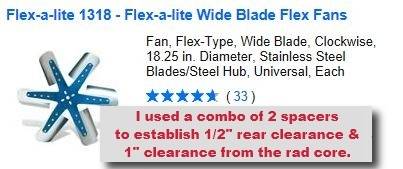

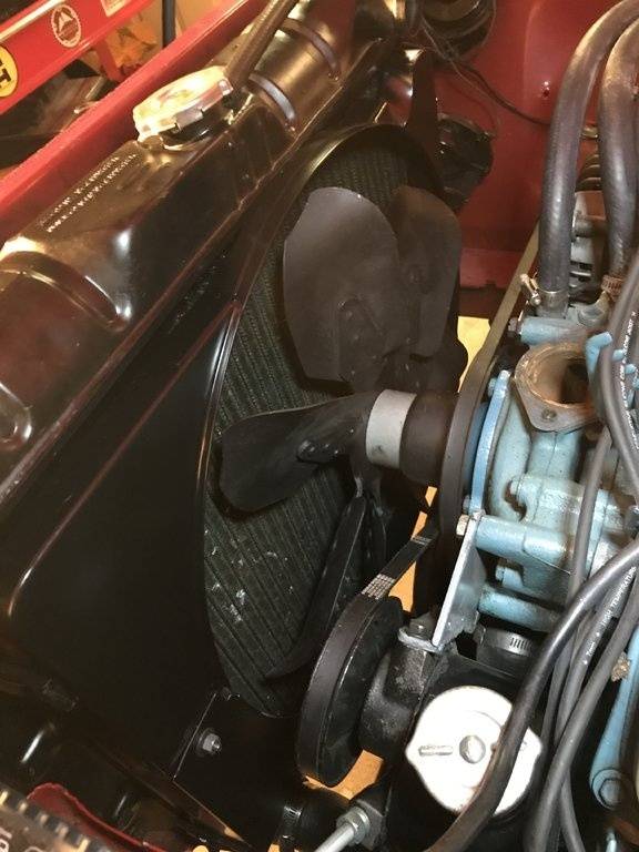

I have since tossed out my earlier beta test, shrouded, electrical push fan concept - in favor of a more conventional ‘mechanical’ Flex fan. A custom shroud - designed to ensure the fan is mounted ( 1/2 in and1/2 out) of the shroud will be added later, should road testing indicate this component is required.
This, in addition to: a recent (forward) adjustment of the radiator location; a relocation of the overflow tank and its newly designed mounting bracket; plus the removal of all unnecessary electronics, resulted in an estimated 40 percent increase in the cooling of this beast.
The bullet proof LOKAR cables – replacing the old (adjustment prone) kick down linkage, and old throttle setup - are totally awesome!
Unreliable fancy chrome coolant lines (that have failed me on no less than 3 occasions) have also been tossed in the garbage - in favor of installing traditional and reliable rubber coolant lines.
Last but not least, studded valve covers, are also on my ‘to-do’ list, in order to button up this job nicely.
This was, in part, a very expensive solution, BUT heh, no more coolant leaks !!!
Now, if we could only rid our province of forest fires & smoke - a little cruising time, would be a bonus.
Here’s Hoping: Our Local & International Fire Fighters, Volunteers & All Affected Residents - Stay Safe!
So far, road tests have been GREAT :)

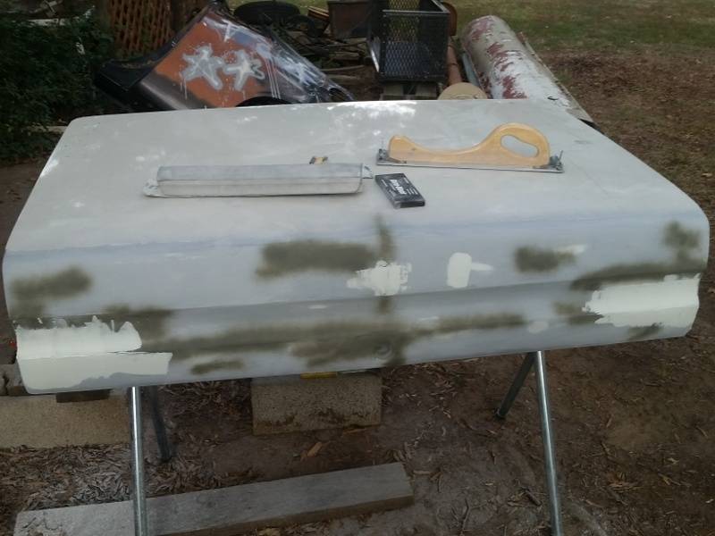

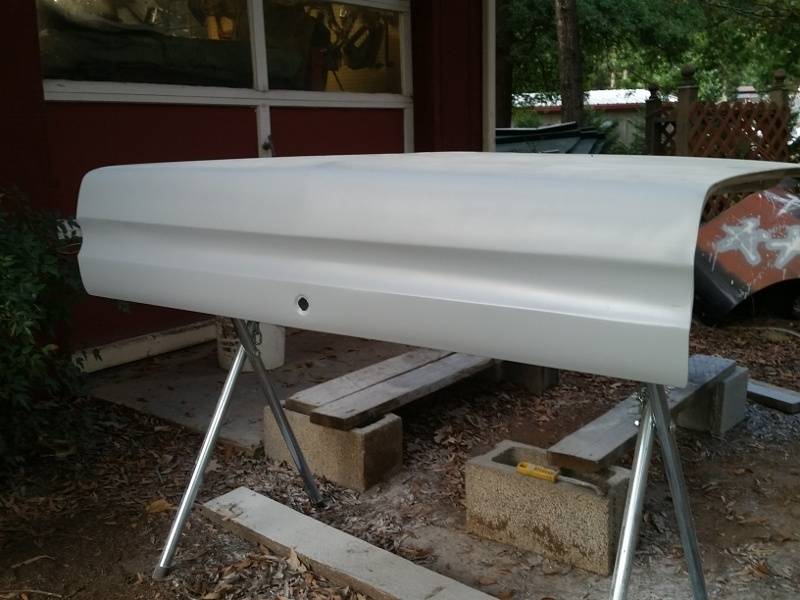

Working on my "spare" trunk lid - this one will be clean, with no emblems . . . or trim . . .
I'll have my 2nd trunk that will sport the PLYMOUTH full tail panel . . . for two very different and distinct looks . . .
More work on the trunk lid . . . got it sanded ( round 5 and 6 ) and covered with epoxy primer and high build primer . . .

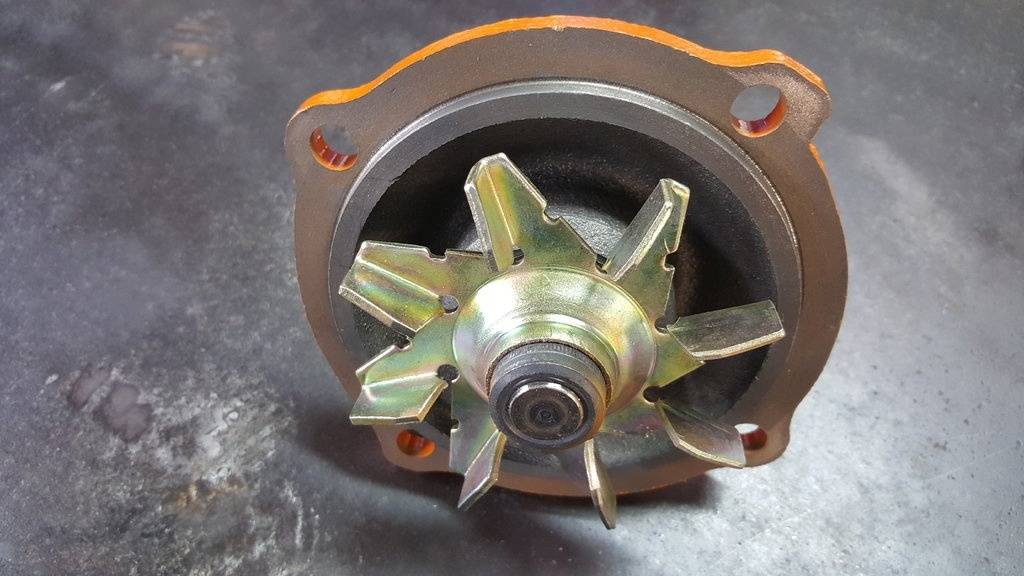

Mine looks the same but without the backing plate. I didn't know they made them that way. Mine really moves the coolant once the T stat opens.
