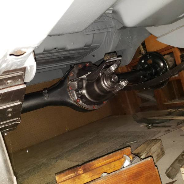

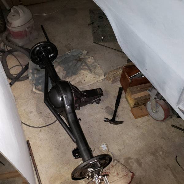

Wrestle-Mania tonight at the Mad Scientist shop . . . the Mad Scientist Vs. the Mopar 8 3/4 489 rear end . . . and it was a match to enjoy . . .
Dragged the rear end out to the shop ( doesn't everyone work on their rear ends in the A/C in their living rooms ? )
This is where round #2 started, as I tried to get this thing into place, without messing up all my powder coating, and get it set in place on top of the springs . . .
Mad Scientist won the battle . . . eventually - but the 8 3/4 put up one Heck of a battle . . .
First time this has been back in the car in 5 years . . . sure looks nice . . . now I get to remove it and get it out of the way . . . OH BOY . . . FUN . . .

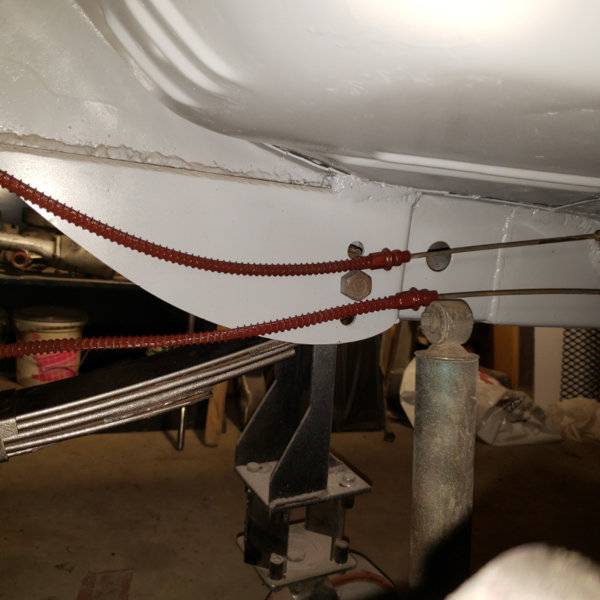

The whole purpose of this wrestling match . . .
To find out where these emergency brake lines are going to end up so I can get the bracket mounted to the frame . . .

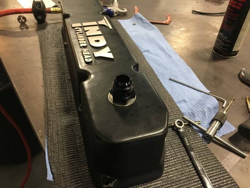

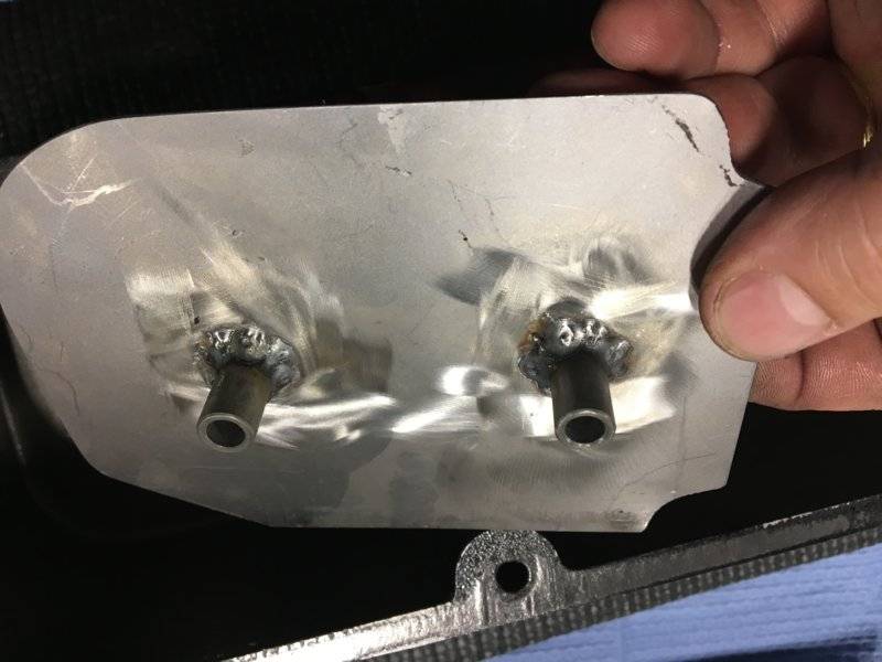

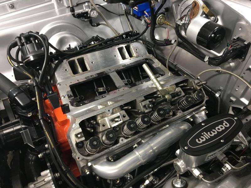

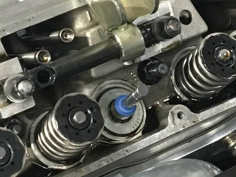

Had some smoke on start up and when I pulled the manifold to switch out the valley plate cover I notice a lot of oil sitting on the valve. Thought maybe I screwed up the valve seal when I swapped out the spring locator. The seals were new and installed prior to me getting the motor so I just assumed they were correct and pulled them of and reinstalled them. Well looks like they were leaking cause they were the wrong size and for 3/8 valves and not 11/32 like I have. So I found the smoking gun at least. while I was in there made some baffles for my new Wagner PCV set up and fixed a leaking oil line to the head.

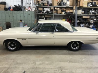

I drove it today down to the store and back. Other than to a car show she hasn't been on the road this year. Plan to do some work after the holidays.

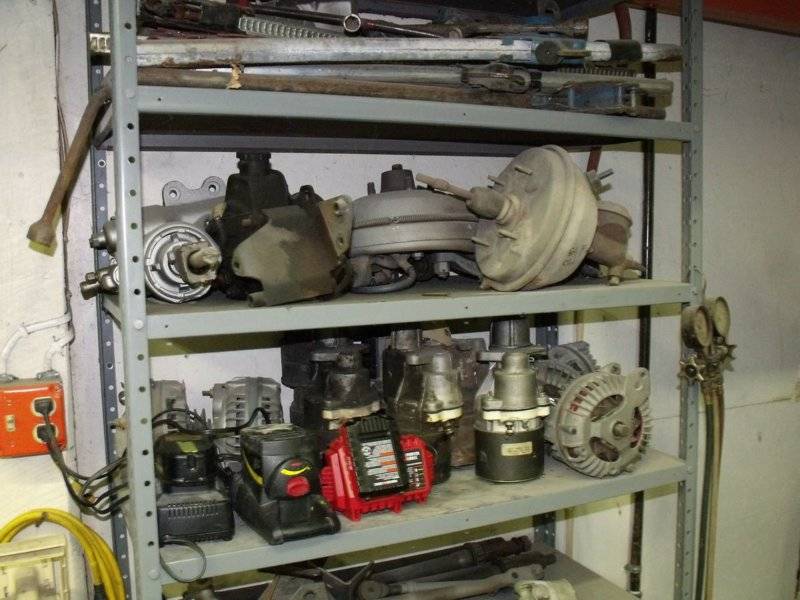

I didn't do it to my Mopar but for my Mopar. Saw this picture on craigslist today in a listing for general Mopar stuff.

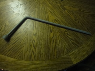

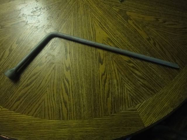

This afternoon I brought this home. Correct jack handle for 68 thru 70 Charger. I have the jack and base and have been keeping my eyes open for the handle. $10 and he sandblasted it.

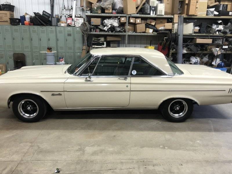

Yesterday dead battery in my 65 Dodge, I bought at Costco in 2015. $2.13 later new battery, no fuss no bother. Like that! 42 month warranty, died at 40 months.

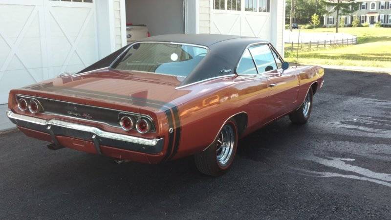

Got the front end on the bronze Charger aligned today. Going to make an appointment for the green Charger when I pick this one up.
Does your alignment guy go off the rear wheels? Several folks here have had a problem getting the job done with the new fangled machines ...............MO
Most of the new fangled machines should have no trouble doing a thrust angle alignment on vintage cars. Where you do run into trouble is when there is a rear fender that interferes with the rear sensor or target compensation. That Charger would not be a problem
Any problems pointed out by alignment guy?
I found a worn idler arm over the winter & replaced that myself. The car was pulling to the right, but when he put it on the rack, the specs told him that it should have been pulling to the left which left him scratching his head. From what he told me, I guess he had a heck of a time aligning it, but it goes straight as an arrow now. Bringing in the other Charger in on Tuesday.
He did say that the older machines had some other features that the new machines don't (bump adjust?), but he aligned it and test drove and re-aligned it 4 times to get it right.
