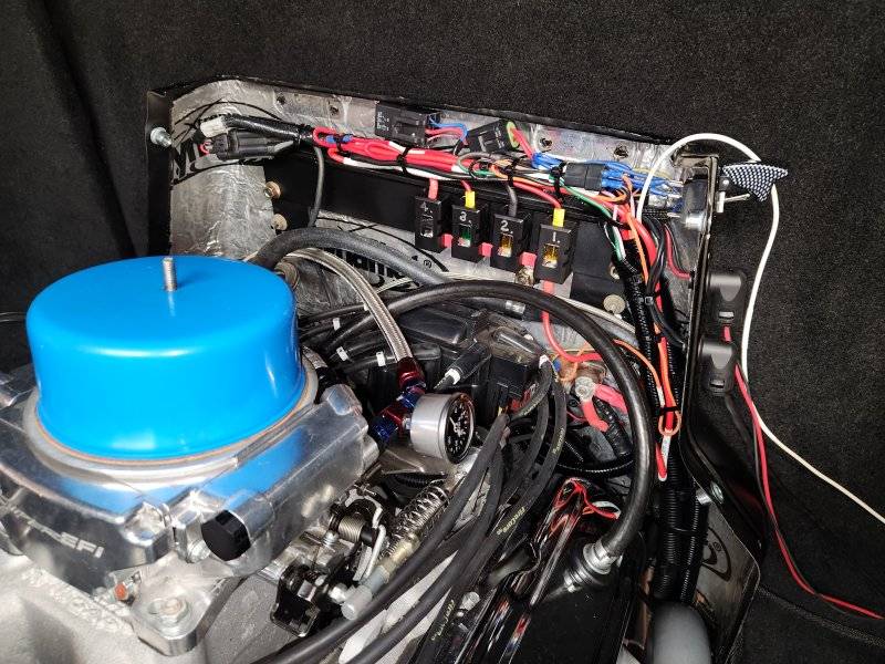

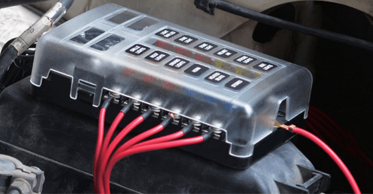

Thanks. I also bought one of these a while ago, but it is just one single Bus line.....and I wanted to split the power as per the FSM. I have spent a lot of time looking for the right parts over the past year or so. I think what I have is as close as I will find without stumbling upon OE parts. :D
I'll post pics shortly of what I have so far. Right now it looks light a grenade went off in a bowl of spaghetti. :lol:
nice tighty/clean wiring job 'like normal' from you Roger :thumbsup::thumbsup:
Thanks. :thumbsup:

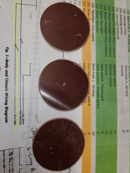

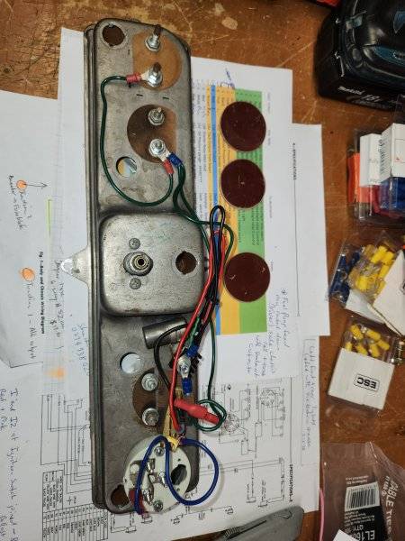

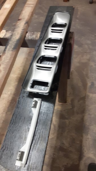

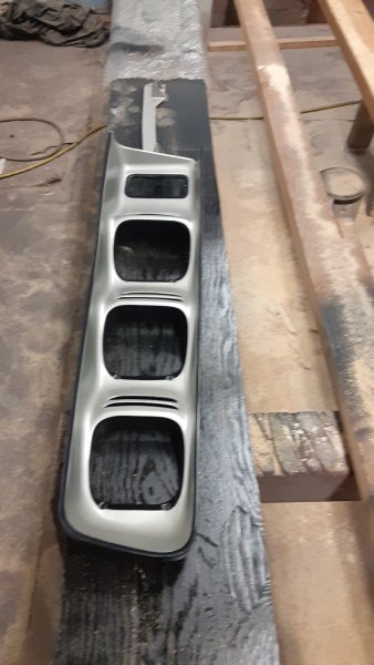

I'm getting closer now. Just need to rebuild the cluster.
Started by making some new insulators from a thin Formica sheet this evening.
Will cut the holes shortly for those and line up the gauges.
:xscuseless:

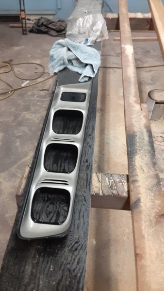

About an hour and a half of tedious masking, and two minutes of painting. One more bezel to mask and paint tomorrow.

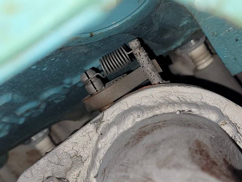

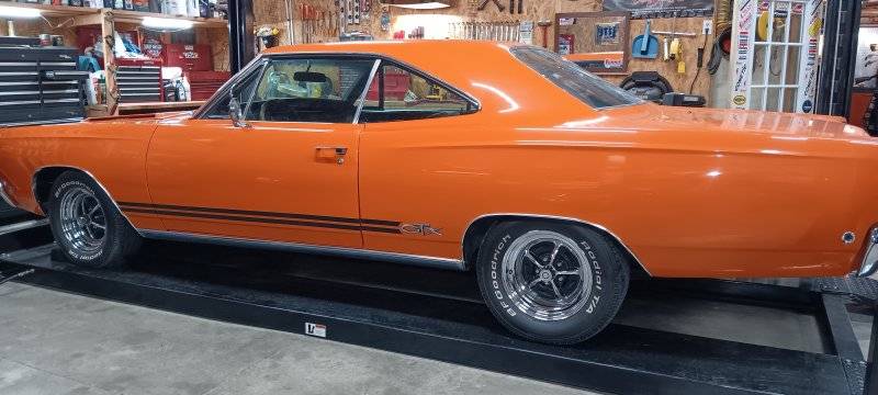

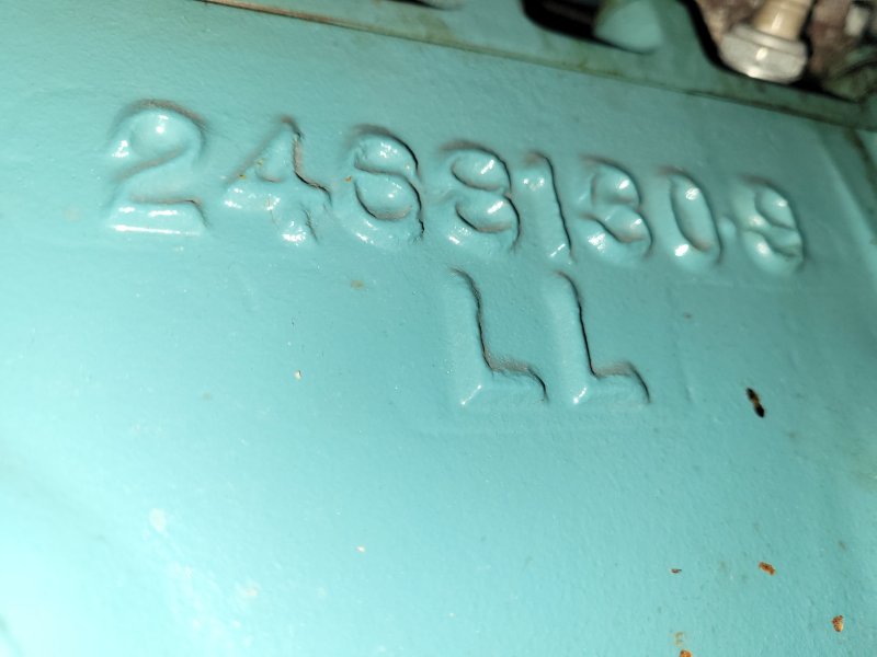

Gave the Wife's Formula S a good look over. I think I'm done on it's cleanup and correction! LOL
Absolutely zero metal work ever done on this car.
Heat riser even still works!

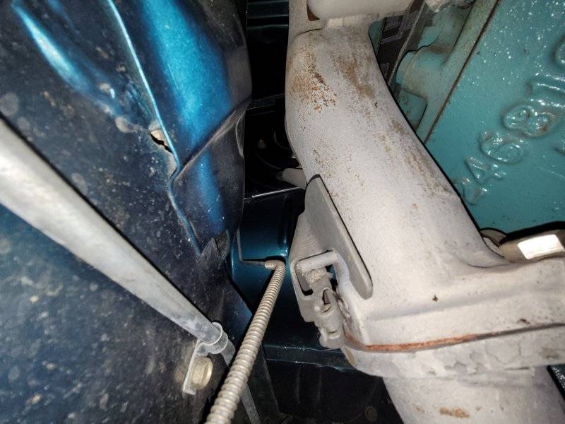

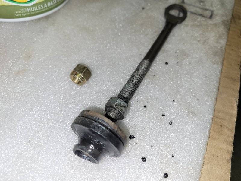

Wrong nut on the clutch fork rod!
Does need some bumper bracket bolts replaced with correct hardware, but short of that the car needs nothing... thank God!

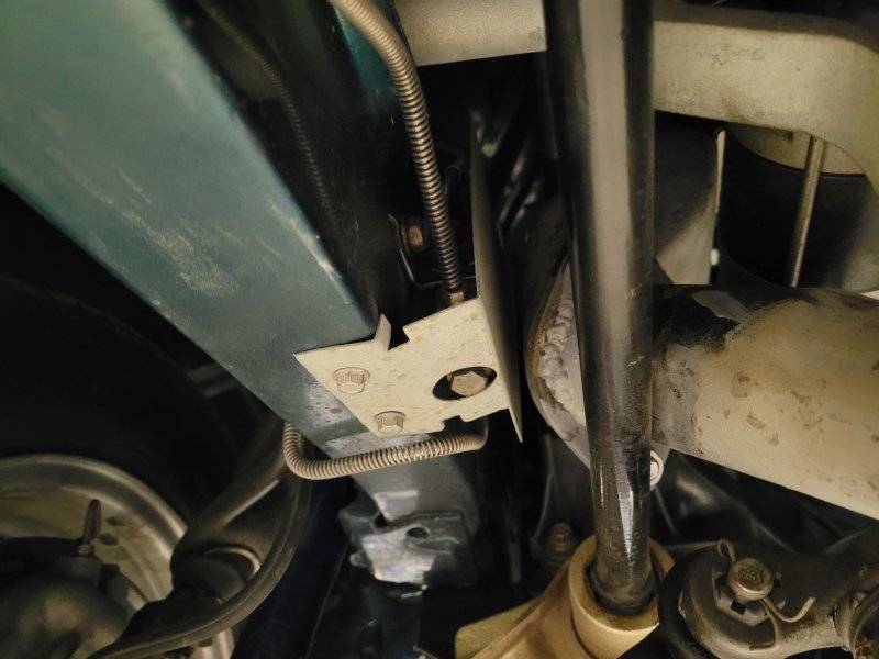

Even has the distribution valve heat shield in place!

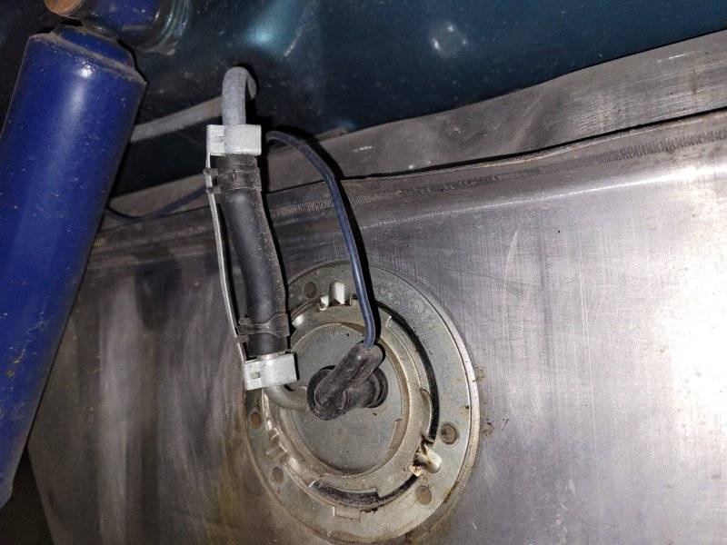

Past issue as I have the tank full and it's not weeping or leaking. Just need to clean up the stain.

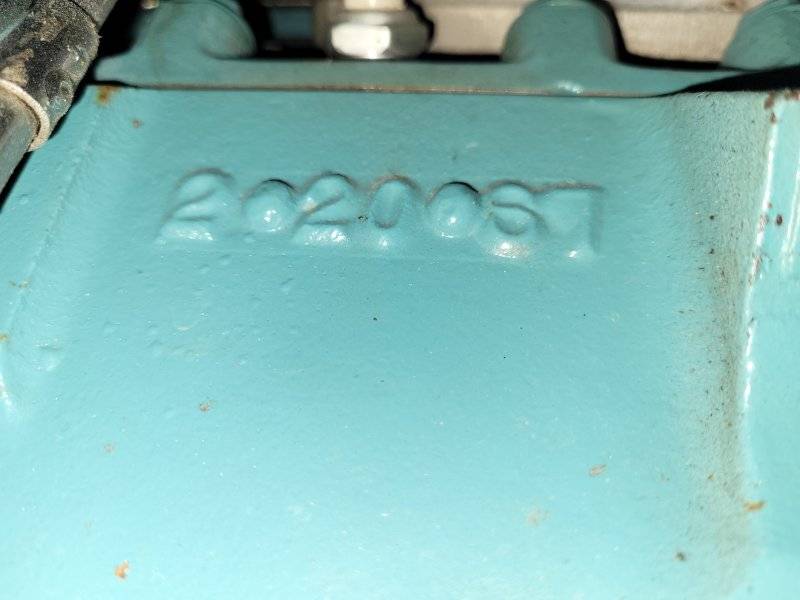

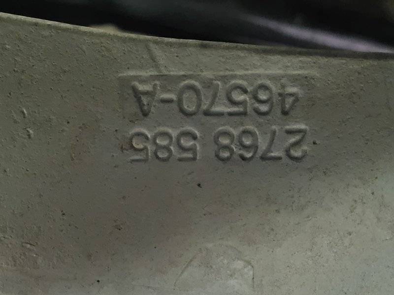

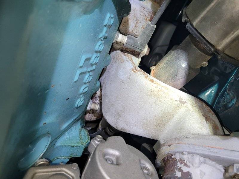

Correct $$$$ Drivers side exhaust manifold.
Torque boxes even!

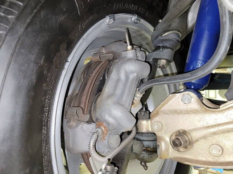

Factory 4 piston discs.
Regular nut vs a lock nut on the clutch fork.
Looks like you got a great one! I'm a bit jealous. If I'd list my favorite Mopars it would be 70 Air Grabber Road Runner, 70 AAR 'Cuda, 67 GTX and 69 Barracuda.
Sweet car!

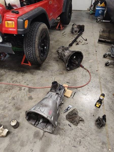

Not a B-body, but still technically a Mopar...
Trans in my 06 wrangler has been making a (louder and louder) bearing growl, and there's a YUGE porcupine of metal shavings on the drain plug, so I finally got around to starting the swap. No lift in the garage , doing it all on my back on the floor (damn 8' ceilings) with jack stands.
Got it all apart, parts all swapped over, new trans with transfer attached is on the trans jack and ready to go up, and would have it back together already but for modifications along the way....getting parts to space the skid plate a half inch off the frame to help prevent rust on the frame rails, undercoating EVERYTHING under there to help it live longer (gotta let that crap dry before stabbing a transmission back in!)...I'm literally watching paint dry.
Tomorrow it goes back together.
