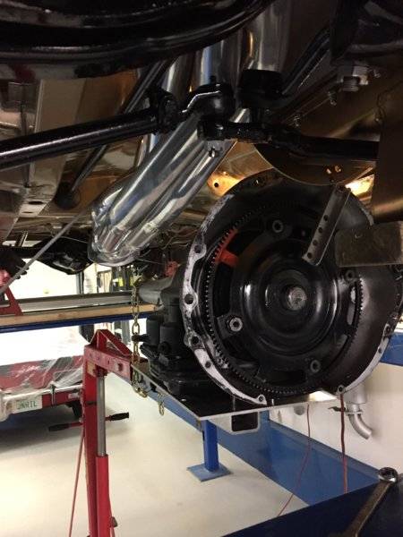

I think the question is how many miles/ drag runs on the trans? There’s always metallic in the pan. My first yr. racing, I cleaned it out& put in fresh and went another season; then did a refresh of everything before the 3rd year. Ur always going to have some crap in bottom of pan.
That sucks, looks like the same valvebody I have
Yeah, I was surprised. The last raceday it seemed to be working fine, good thing I decided to service it.
I was told that the trans is a Protrans. When I changed the shift selector seal last summer though I found that it is 727 internals. Likely built at Protrans. Just as well, good time to get it apart and see what is what. Already dug into it..

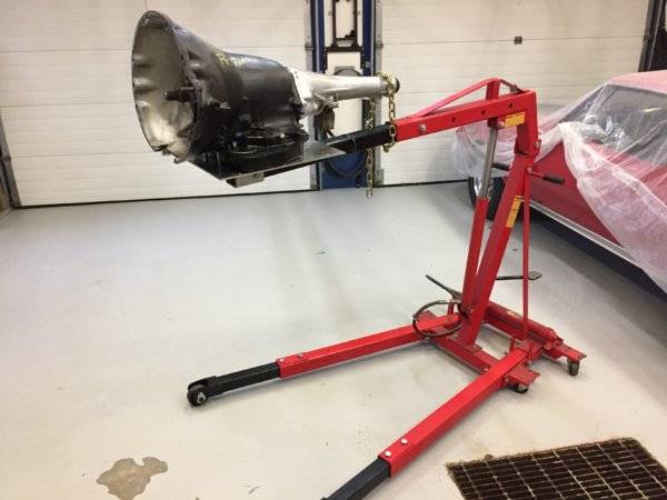

Not your everyday trans jack but it works great. It made installing/removing the tremec magnum in the Camaro a breeze. Just had to modify my plate a little for the Torqueflite.

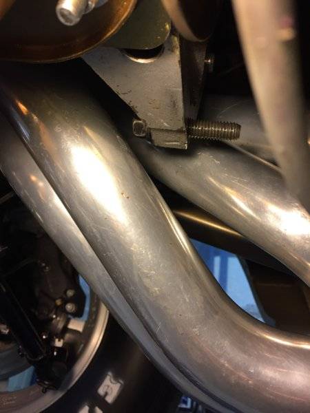

Got to do something with this lower right side bolt. The TTI headers are right in the way of getting it out. I would imagine lots of guys have run into this.

I'd say there's about 30 passes on it. There was nothing stuck on the plug magnet.

Brilliant with the “trans jack”! That bolt is going to be fun!
Thanks Coronet. It sure worked great for that heavy tremec, and a little rocking and the input shaft would slip in every time.

My transmission came with the car, was fresh, for racing, said to be built by Protrans, transbrake, fully rollerised, 4 gear planetary, etc. Can I be sure on all of that being the case, nope, although it worked well last season. The dirty oil and pan was a surprise. I've decided to have it gone through, freshened and find out what it actually is first time around. Hopefully it is what it was supposed to be. Stay tuned.
I'd only ask how often you changed the fluid. If not much, looks pretty typical to me, considering it's use. Most of the 'dirt' would be clutch powder. I'd change the fluid after so many runs, to keep it in good shape.
At least some I've known, years ago, would replace the clutches (including the red ones) often, right at the track.
