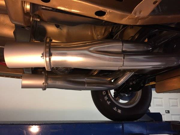

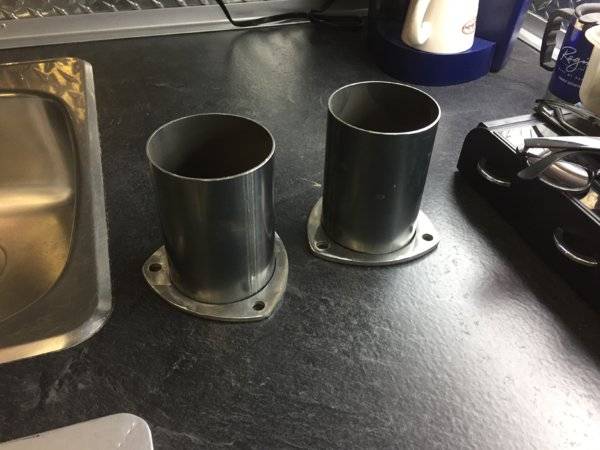

And while I have you, the reducers are in the fab process of sizing up to 3.5" too.

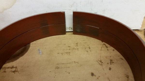

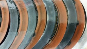

Here's a pic of my clutch plates and band when last inspected. Aluminum drum, 135 passes with Walmart Dexron
Doug
Doug
View attachment 549764 View attachment 549765
Going 135 passes behind 800HP and looking like that, tells me that when your transmission is built right and seals are doing their job, basic ATF does the job. Now I believe that you foorbrake your car Doug? With the transbrake there would be more heat buildup meaning more frequent fluid changes. Is there a rule of thumb on fluid changes to go with?
