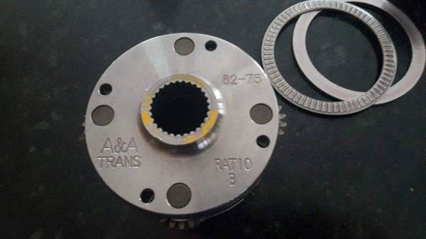

Thanks Mr. Gaines! Update. A late change on my end is that there's an A&A billet low gear set on the way courtesy of and thanks to buddy Chris (Superstockracer). The converter that Lenny built for me stalls at 5500-5600, so there's room to tighten it up a little with a lower gear set. The new set will make the Plymouth act like it's got a 4.56 gear through 1st, 4.35's through 2nd, and back to 4.10'a in 3rd. Pretty sure a new personal best is in the works.
New A&A billet gear set for the Plymouth.

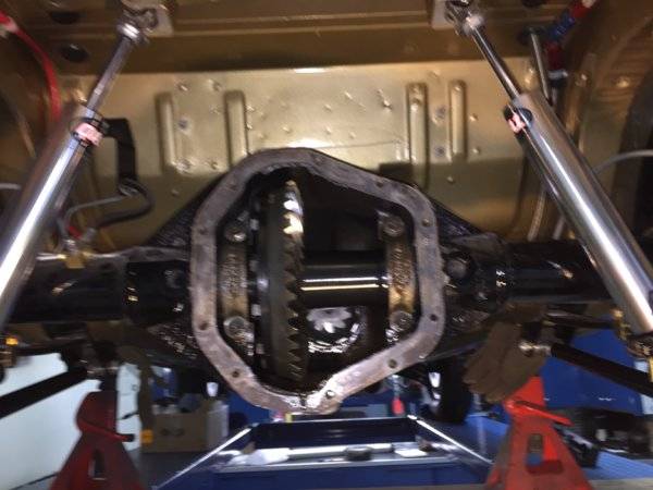

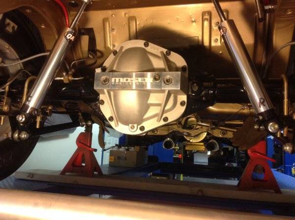

Transmission is supposed to be back in the next day or 2 so I figured that today would be a good time to check out the Dana. The beauty of having a dana, remove the cover, have a look at the contact, check bolt torque and back on with the rear cover.
Quaker State 75W140 came out, almost as clean as it went in.
Everything looked like new, checked out good.
Back together with 60" lbs preload on the bearing caps.
Fresh Amsoil for the 2018 season. Considered 75W90 but ended up going with 75W110.

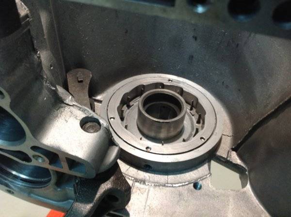

I'd sure like to know what's inside though for upgrades. If there wasn't even a bolt in sprag inside that could be disaster.
malex, Pat Blais, the guy that builds my trans and has been doing torqueflites for about 50 years has never R&R the sprag with a bolt in. Never had any problems and my GTX 60 fts. in the low 1.40's with a best of 10.34:moparsmiley:

GTX this is very interesting to read. Replacing the sprag with a quality bolt-in type with more rollers is a common upgrade for the 727 race transmission. I haven't personally experienced nor seen a failed sprag but there's plenty of people who talk about it.
I even installed a A&A bolt-in sprag in my "next project" 727 while I had it apart.

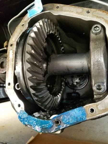

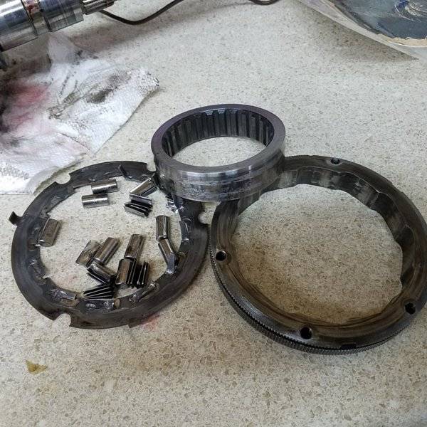

I broke the ring and pinion last september, and yes it took the 'bolt in' sprag out along with cracking the rear drum. I believe the bolt in sprag did save the case as the outer race did not spin and chew up the case. fwiw
I broke the ring and pinion last september, and yes it took the 'bolt in' sprag out along with cracking the rear drum. I believe the bolt in sprag did save the case as the outer race did not spin and chew up the case. fwiwView attachment 576531
Tough break there NSS. Likely the bolts kept the sprag from breaking loose in the case.
Was it a 8 3/4 or Dana that broke?
Not big power, about 8 years on the gears. My first attempt at setting up the gears, and too much backlash.
Measure 5 times, adjust once? Where are you located at for curiosity?

The "grenade" is when the stock front drum over revs and explodes. Number #1 trans upgrade should be an aftermarket front drum able to handle the 2.2 rev's seen. Even a 12 second car can explode the stock front drum if it over rev's. The bolt in sprag might save the case that's about it.

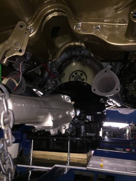

My Transmission came back today. Will be noticably better next time out, that's for sure. Not wasting any time neither.

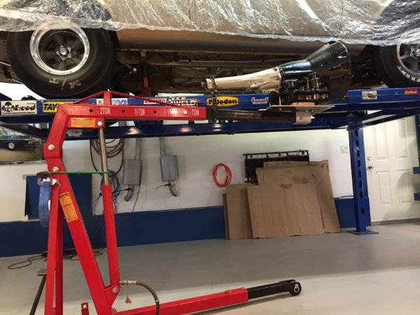

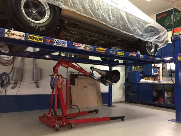

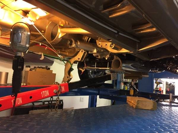

Not your everyday transmission jack but it sure works excellent. To get the trany up there, stand trany up on the floor with the nose down. Bolt the plate to the bottom of the pan, roll up the jack and slip the arm into the receiver on the plate. Put the cross bolt in, tip the trany back against the arm and jack it up.
Let the jack down, roll under and jack back up. I wrap a chain around the tail shaft because it gets nose heavy in this position.
Trans going up into place.
The receiver is on a hinge so it's easy to get the correct angle at the back of the engine. Ready to add oil and fire it up, tomorrow.

The 16 roller type is the best available. Most of the bolt-ins were designed as case savers when the stock outer race becomes loose. Jeff Freese broke a Dana 2 years ago with his 10.0 N/SS car. I tried to fix it at the track. It had a 16 element. Still took out the case.
